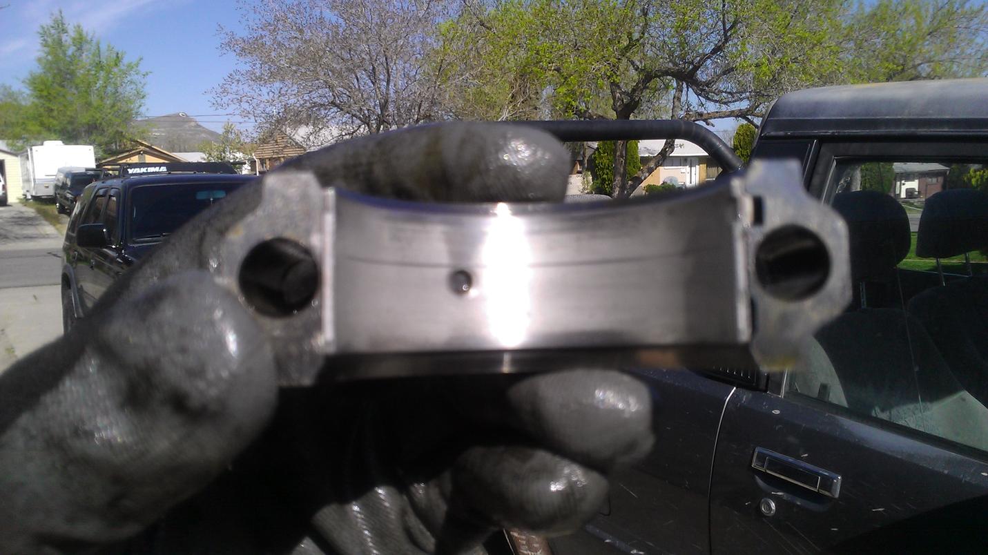

So the movement is parallel to the crank, not perpendicular - I think that's what the FSM is calling thrust clearance? I gauged the bearing on #2, which is the one I was rattling, and it came back at almost exactly .025mm. The FSM says .025 to .055 is good, and both the bearing surface and crank pin look shiny and smooth, no funny colors and no imperfections. Sorry for the humungoid pic, mebbe I'll resize it later.
I'm gonna check the other pins as long as I've got the pan off, but I'm not seeing any trouble so far.

Those bearings look pretty close to new, how did the bolts feel when loosening them? have you checked all the other bearings yet?
Not that I know what I'm looking at, but they look new to me too. The bolts were all plenty snug. All the rod bearings are gauging correctly so far, right between .025 and .05 - I'm struggling to get the cap off of number 4, I'll get it in the morning. Then I'm going to check the main bearings (can I gauge them the same way? I haven't found where the FSM says one way or another). If everything checks out, I'm going to button it up with the new oil pump, water pump, and timing stuff, and see what happens. If it's still making obnoxious sounds, I'm gonna pull the block and do a complete rebuild. If not, then yay. :)

I wasn't planning on pulling the crank with the motor in the truck, I was just going to pop the bearings one by one and make sure the half that I can see is good. I figure if the bottom bearings are as pristine as the rod bearings and the crank itself isn't chewed up, then the top bearings can be assumed good as well.
And if I have to pull the crank and get it machined, I'm just gonna yank the entire motor out and do it on the stand.

Checking the main crank bearings when I get home in the morning, and if they're good I'm going to button it up and run it until something breaks or I find the time and cash to strip it down and rebuild it. I'm not sure I WANT to rebuild it at this point - it isn't burning oil, the timing stuff seemed new, and as Blackworks noted the bearings seem fresh, I don't think this motor has a huge number of miles on it. But what will be will be - I'm not at all intimidated at the thought of pulling the motor and tearing it all down, the way I would have been a year ago, so that's what I'm going to do if it comes to it.

The bearings are all good - the mains are a little worse than the rod bearings, but they're all in good shape and gauge within spec. So I'm putting it all back together, and all of the lower left timing cover bolts are bottoming out before they snug the cover up. It's the weirdest thing. I shot the holes full of brake cleaner and then pb blast, hoping they've just got crud in em that I can clean out. I know for sure that I'm using the right bolts in the right spots because they all went into a chunk of cardboard one by one as they came out.
