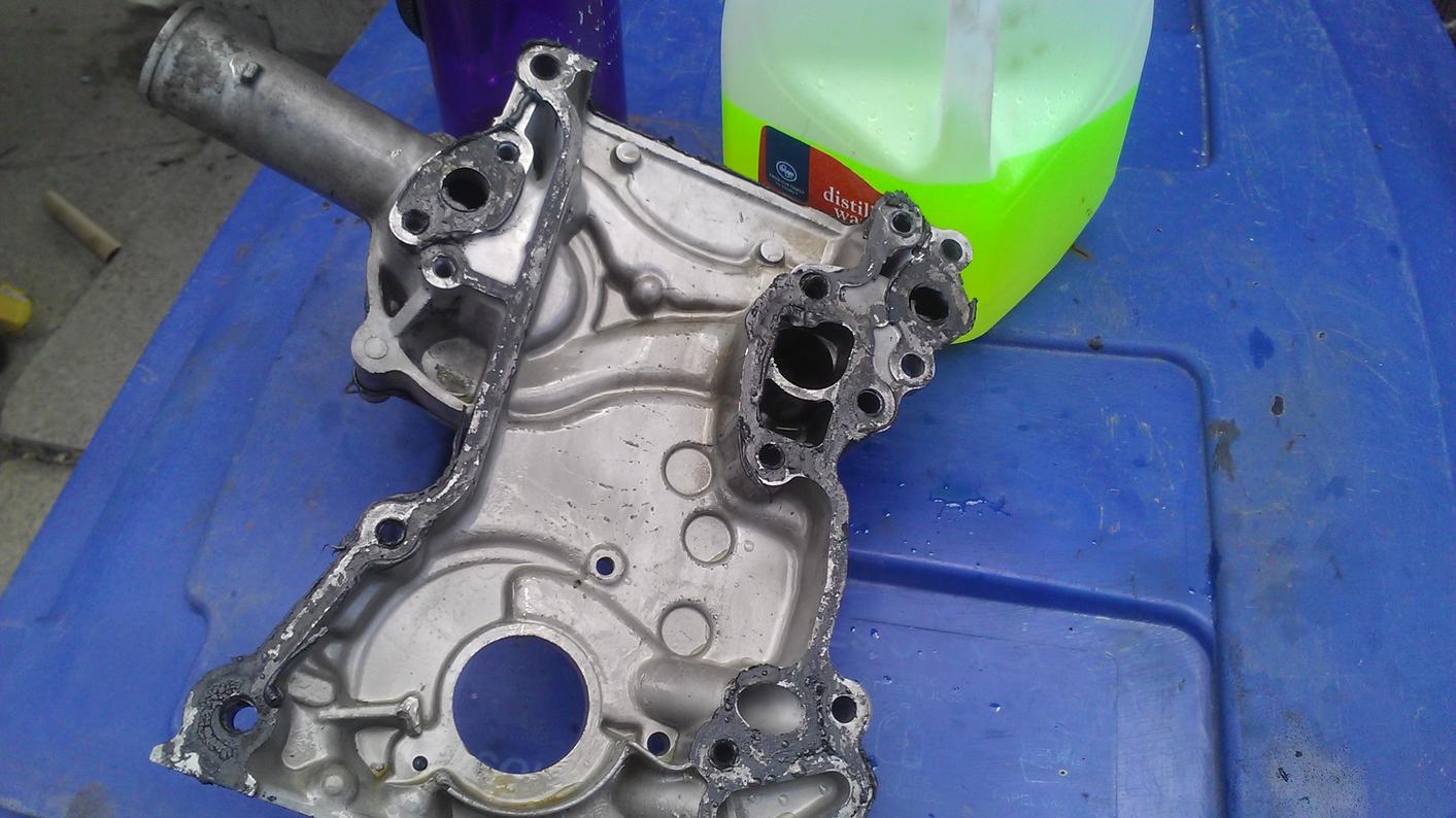

So here's a pro tip. If you're buttoning up your timing cover, and you're feeling pretty good about getting to know your motor better, you might get to thinking "who the heck needs a paper gasket" and decide to just smear the back of your cover with gasket maker. If you did that, you might want to make sure to get the little fin underneath the coolant intake pipe. If by some chance you didn't get that part, you'll weep coolant out the bolt hole below the water pump (and probably into the oil too), and this will get you very confused and then you will become a sailor and start throwing things and have to take the damned cover back off to do it right.
Now I'm not saying that's what happened today, this is more of a public service announcement in case somebody else got cocky and started going too fast. You know. If.
