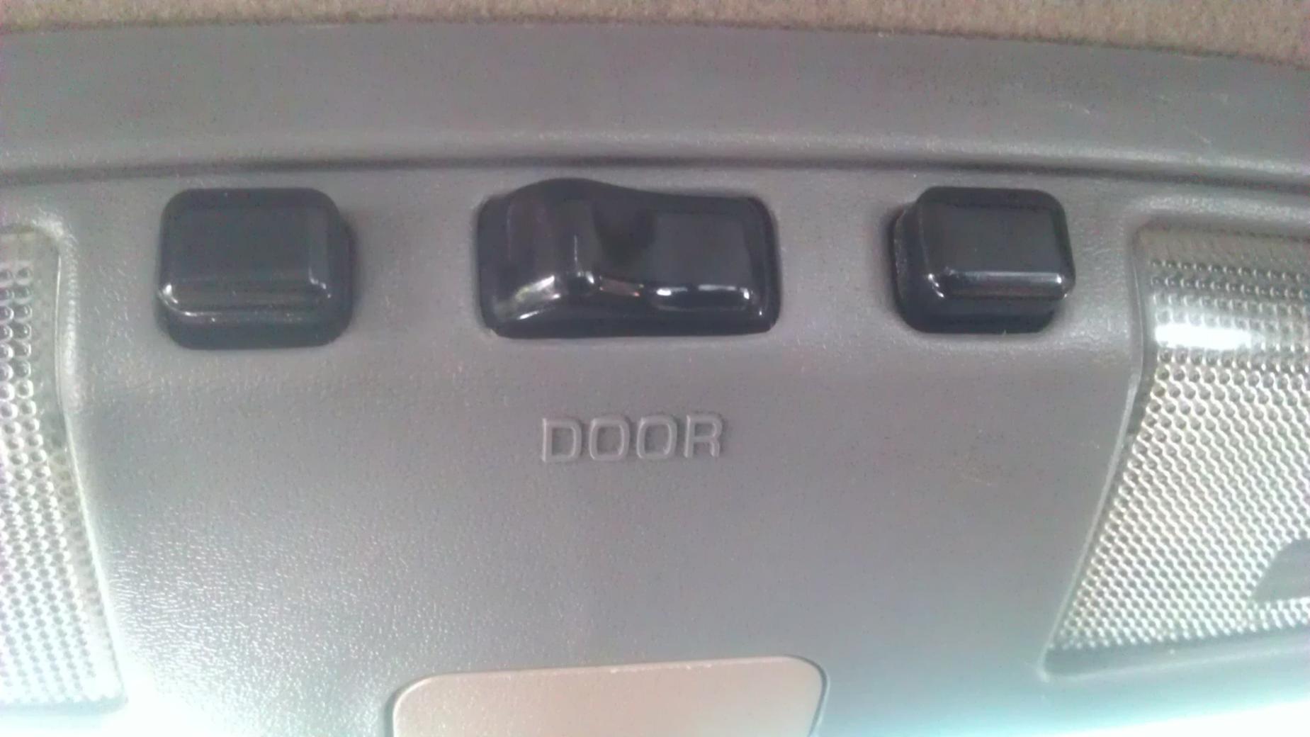

BUT on the other hand the 2nd gen 4runner's map lights DO come on when you open the door, its a very simple mod. just get the map light assembly out of a second gen and run a wire to the door ajar circuit. I've done this in my truck and it works like a charm, I have NO idea why in 3rd gen they got rid of that awesome feature.

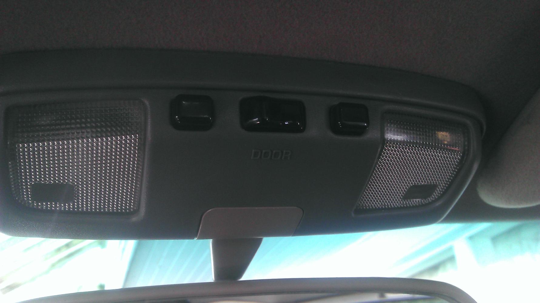

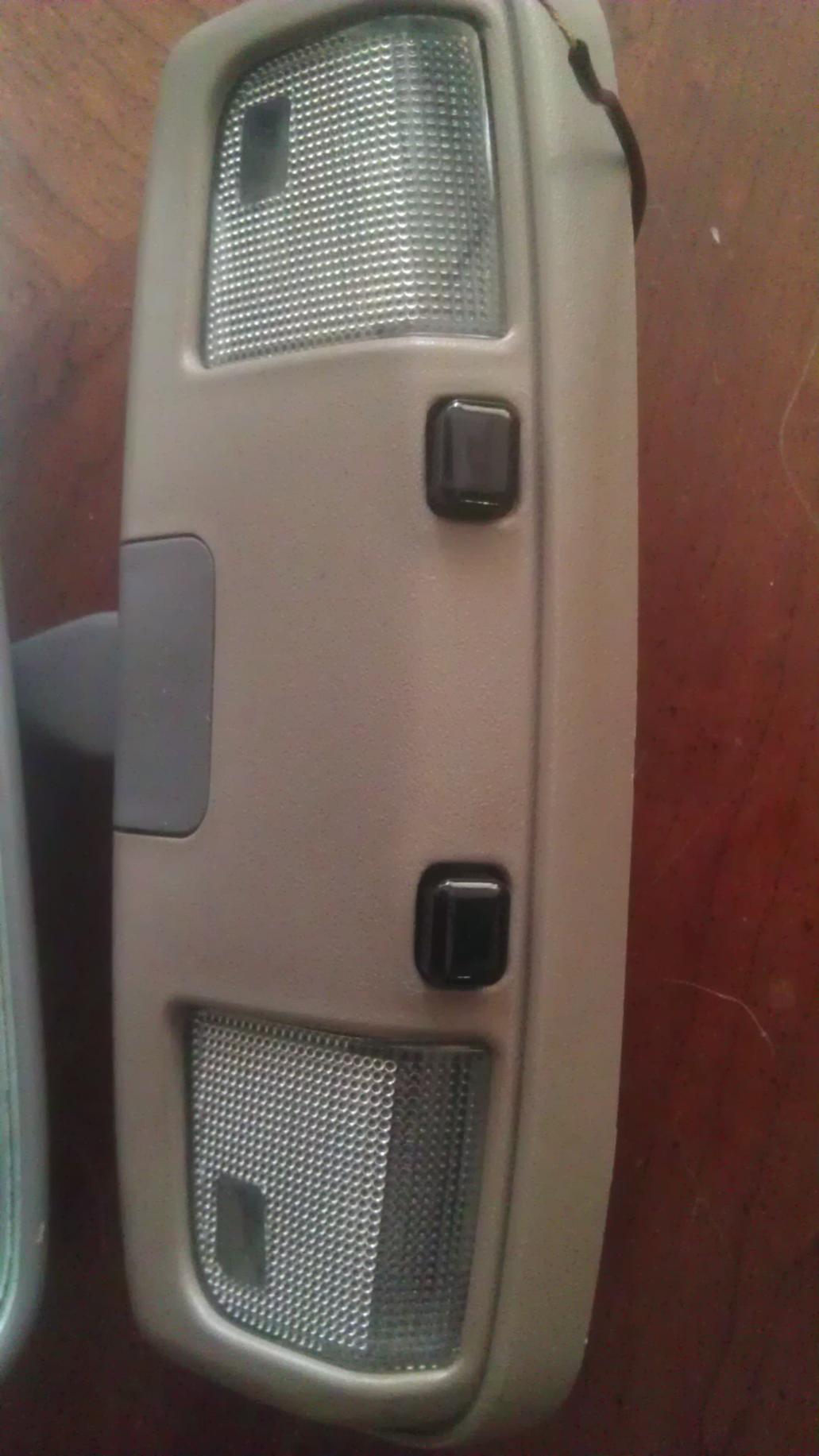

I'll try to get some pics up soon, of what I am talking about for the 2nd gen maplight mod.
Hope that helped!
first pic is the map lights out of a second gen, notice the 3rd switch in the middle.
second pic is the 3rd gen one.

Hey 3RZ...
Did you or anyone ever post a tutorial on your 2nd gen maplight mod?
In particular, how do you go about connecting the 2nd gen maplight wire to the door ajar wire?
