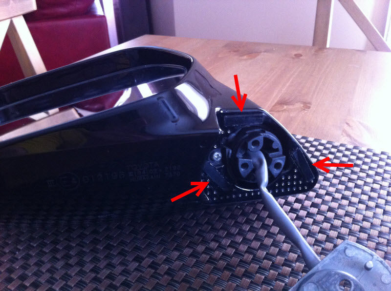

I recently bought a 2006 T4R Limited. This is my first SUV. Lots of things to learn. I bought it in a different city. On my way home, on the highway, I noticed that the reflection in the driver's side mirror was vibrating. Then I found some scratches on the mirror casing. It looked like the mirror had been previously hit at some point, maybe at some drive-through or something..

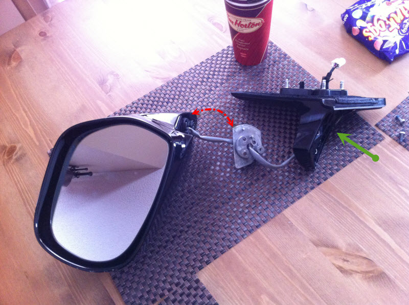

First of all, I took out the whole mirror unit by removing the door panel, disconnecting the mirror electrical connector, then unscrewing 3 nuts that held the mirror and simply sliding the mirror unit out off the door. Very simple.
Then I removed the decorative bottom cover (green arrow) to reveal 3 M5 screws (torx head).
After undoing them all, I was able to detach the mirror support (that attaches the mirror to the door).

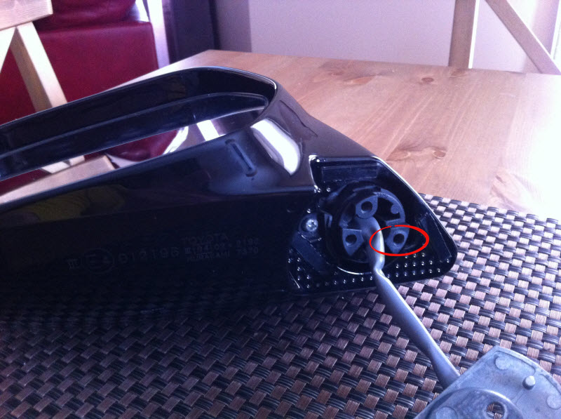

Next, there was a metal pad attached to the mirror casing with another M5 screw. After removing the metal pad, I found the culprit right away:
The metal pad sits on 3 rubber pads that are glued to the mirror casing. One of the rubber pads was missing, therefore creating a gap, an empty space between the mirror casing and the metal pad (pointed out in first pic by the red arrow). I removed all the rubber pads, cut out 3 similar replacement pads from my old silicone carpet and glued them to the casing using the polyurethane sealant.
But there was another problem though - one of the inner threads (for those 3 screws mentioned earlier) was damaged.
I used a 3/16 drill bit to completely remove the remaining thread and tapped a new 6 mm thread. I found an M6 screw with a similar length (actually just a little longer) and reattached the unit back together with no problem.
