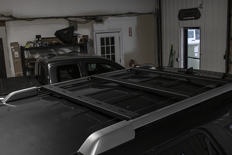

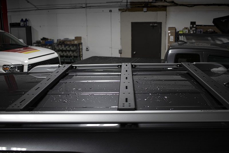

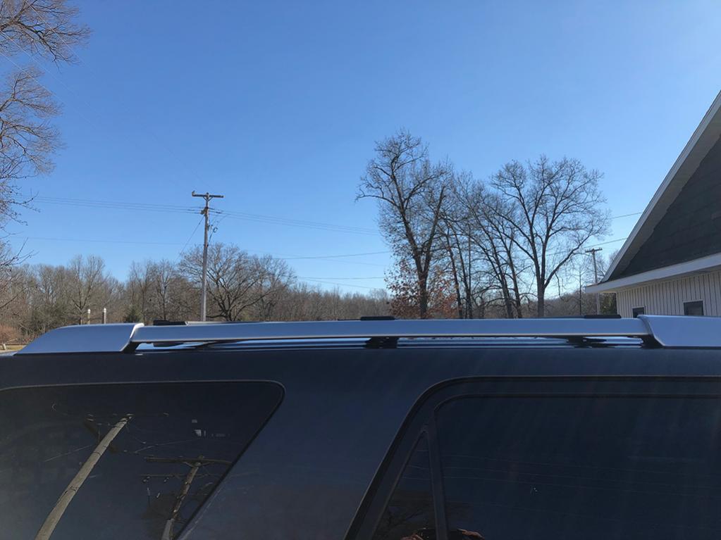

how wide are the rails? how much clearance is there between the bottom of the rail and top of roof? do the rails sit up high enough that the antenna is missed if I put some boards up there and last but not lease, do they come with mounting hardware and is it stainless? could I see some side photos? thanks!
The rails are 3" wide and there is about 1" between the bottom of the rail and the roof. If you need more room to get hardware on, one side is notched so they just drop on and off the bolts in the rail. They sit just above the factory rails which is slightly below the antenna. If you are running a tent or traction boards it won't be an issue because they are spaced up. The hardware is zinc coated.

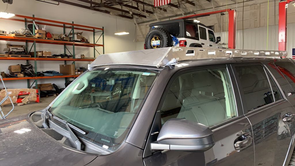

Roof rack prototyping is underway!
There will be a no-drill, full & 3/4 rack option in the near future.

Just the other day I found myself wondering if you were going to make a roof rack.
Any options for integrating a slim light bar that won't get in the way of any cargo on top?
Yes, the front fairing will be available with or without a light bar cutout. :thumb3:
Will there be a final seal between the rack and the roof to cut down on noise? How wide are the crossbars? I assume the mounting brackets are steal vs bent aluminum like your competitors? I can't wait to see the final design.
I don't currently own a 4runner, as i'm waiting to see the new 2020's to come out before I pull the trigger. I've been creeping around the forums to get ideas of mods and accessories.
I'm thinking my 4runner is going to be a Victory 4x4 poster, molle racks, sliders, bumper, and now this rack.
Also, I am looking for something that adds minimal height...that looks pretty low, any guesstimation how much height it may add over the stock roof rail things?
The front and rear fairings will be adjustable so you could add some edge trim and press it all the way against the roof if you'd like. The whole rack will be aluminum but the mounts will be steel. The rails will be 2" wide extruded aluminum.
Look forward to seeing your 4Runner!
