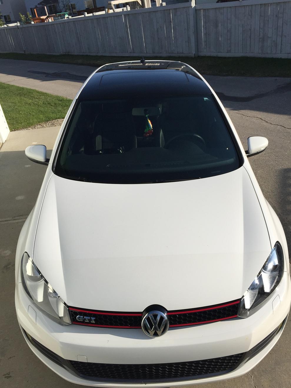

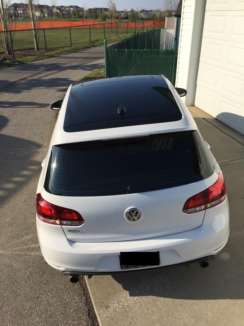

I did the roof on the wife's 6M GTI, some photos (sorry not 4Runner, got my flame suite on lol). The vinyl can be installed with cut through fish line which I had to use in this case since there are no rain gutters on the roof to tuck things in. This technique can be used to just do portions of body panles. The vinyl does go into the sides of the sunroof opening so no white can be seen. First time use, 4 hrs of work.
