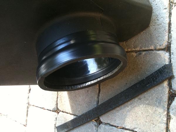

Capping the front port and sealing the intake tube to the box made a big difference to the amount of resonance and vibration generated when stepping on the gas (according to my calibrated ears :D).
Previously I would mainly hear the intake and now I mainly hear the exhaust from the Gibson CATback.
I'll try removing the cap on the way home to see if the resonance comes back.

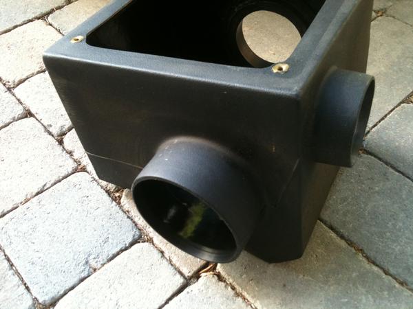

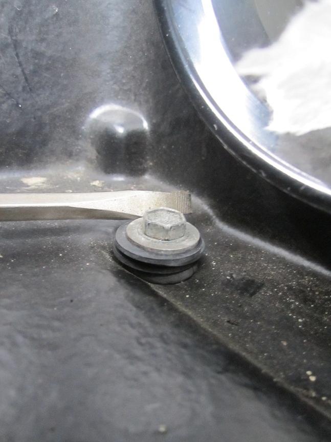

I suppose I should had provided my reasons for sealing the box because it wasn't for sound...mainly commenting on the sound because the thread's title. (attempting to post something related to the thread title).
My first reason for sealing is to prevent water, mud and other foreign objects into the airbox while off road. The second reason is in preparation for a snorkle at some point for off road (less dust, water, etc). The stock air box is sealed, but Volant provides more surface area for filtration and the intake tube is smoothed for better air flow. Volant also positioned the box further forward providing more room for a second battery behind it.

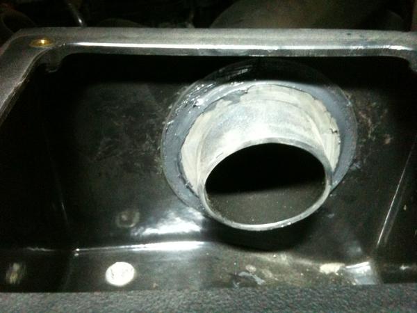

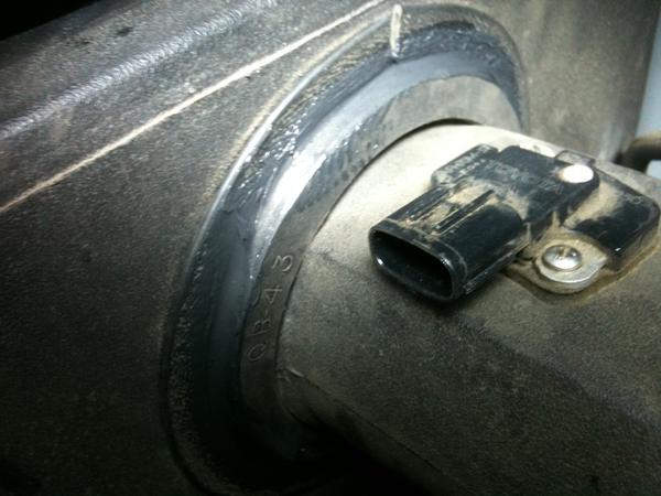

I think Volant must of been over budget on the BOM and ran out of ideas for the intake tube to box seal, so they settled cheap and dirty. At least that is fixed now.

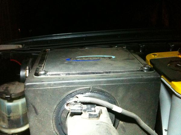

For the front opening, the selected plug is nice since it can come on and off easily depending on what is needed. Might be interesting to plumb this port to allow air from the front of the grill, but that will be for another day...

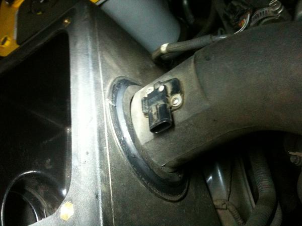

I wondered about where the pipe enters the Volant box, much like you did. I wondered if they kept it loose because the motor moves enough that the tube going into the box couldn't be "fixed" to the air box?? You will have to keep us up to date if your fix ends up cracking or coming loose.

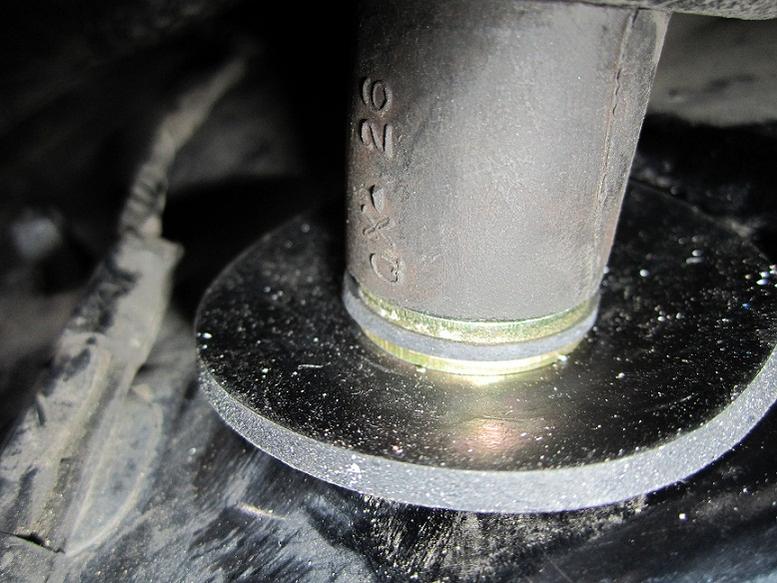

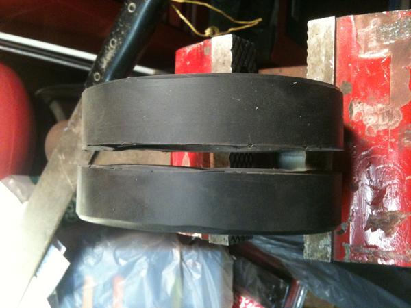

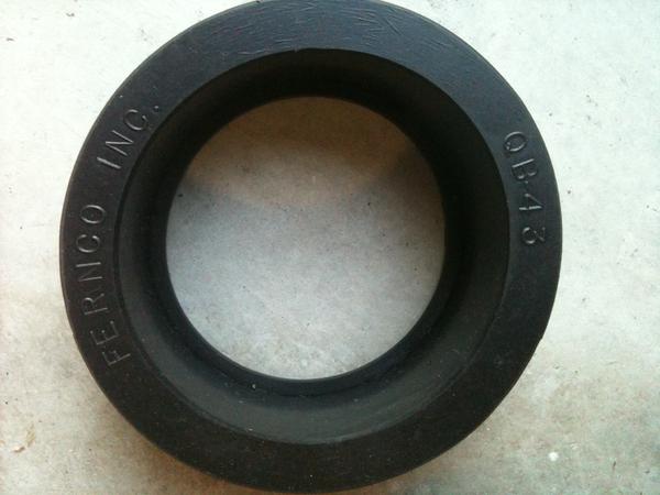

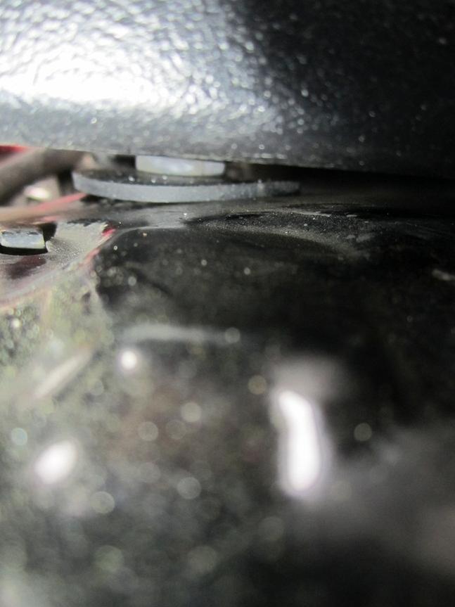

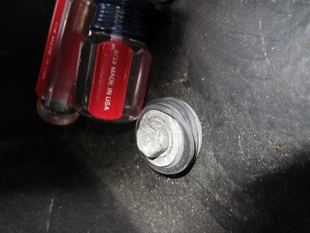

Had some down time so I finished sealing the box to the fenderwell.
Before
After with 3/4 closed cell weatherstrip.
I was afraid the weatherstrip would come off the box so I used electrical tape to keep it in place. If installing a new Volant it would make sense to use the supplied seal for this port as another earlier in this thread did.
The new seal box/tube done previously holding up solid. Was able to pull the tube out and feed it back in w/o any issue. RTV worked well.
Just a follow up at about 7 months post mod. No cracking or deterioration of any kind. I cap the from hole when off road and uncap when on the street.
Vibration/resonance is gone and still has great pick up and sounds great when the pedal is down. :beer:
