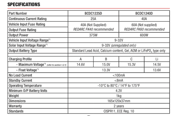

I know this thread is a bit old, but has anyone tested any of the boosters with something like a RedArc BCDC1225D for a dual battery system? They do some magic to provide the 14.7v to the aux battery, but I'm wondering if tweaking the alternator output has any negative affect on them/their math. Thanks.
Sorry for the late reply, but the input voltage range for the Redarc BCDC is 9 to 32v. The output voltage is not dependent on the input voltage. The booster will have no effect on the output of the BCDC.

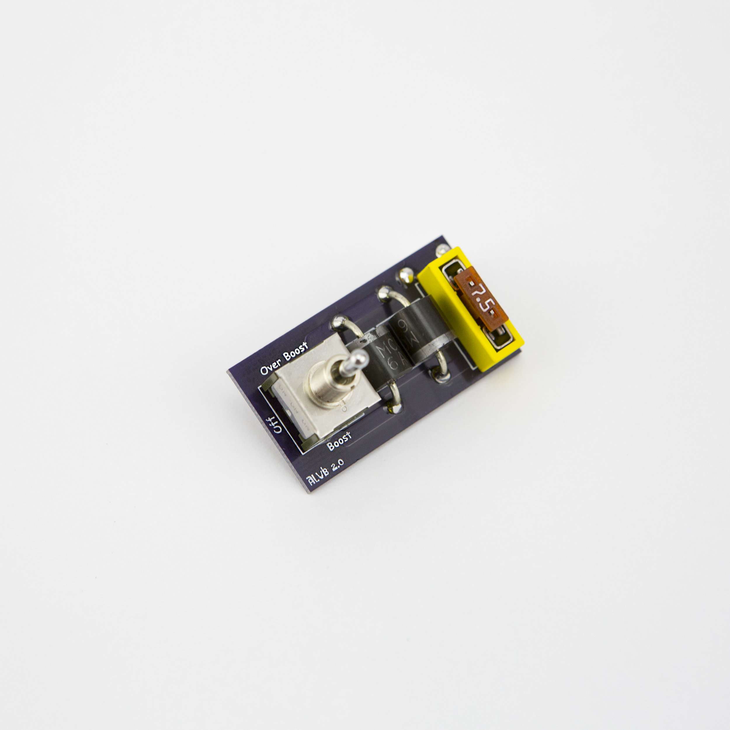

I went with the Dirty Parts offering as I have not heard anything back from him, and checking the arclight website periodically, it appears he hasn't made any recently. I'm just hoping he is doing OK at this point. I would still love to have one and then use the Dirty Parts booster as a back up. The switchable feature is something I really wanted.
I'm waiting for Arclight setup as well. They are sold out. I'm not sure if GM diode is a way to go on this, also it is not as cheap as some one advertised earlier. Does anyone knows when Arclight will have these in stock?
As someone who has used both...
Both work, but the Arclight is way better, I get more amps out of that system than I did on the GM. Plus the Arclight can be switched down or off.
While I waited for a new batch I did the GM one...
I ordered one as I have the northstar AMG but stopped reading this thread 12 pages in..... long story short, can someone tell me which of the 3 settings to have it on? For how long and when? Thanks.
I keep mine on the middle setting normally. If it's real cold and/or I'm not driving much, I'll flip it to over boost for a couple of runs.
