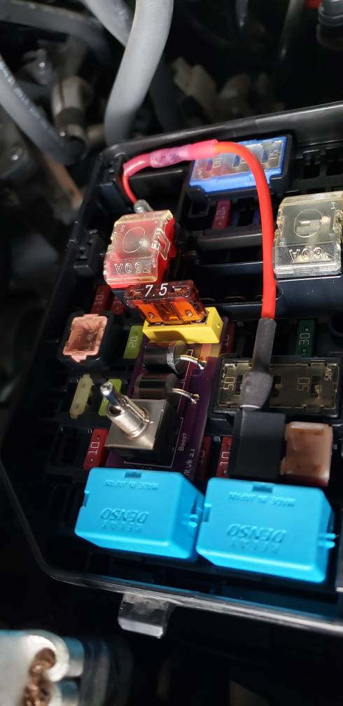

It came today, and I installed it. Easy.
One thing I noticed, is that the fuse holder on the ALVB is for an ATO fuse. I didn't like how the micro fuse that is the stock fuse size didn't fit properly so I stuck a 7.5 ATO fuse in (had it for one of my previous rigs) and it fit like a glove. 20200714_145545.jpg

Keep the mini 7.5 A fuse in the car just in case since ATO wont fit in place of original ALT-S Mini Fuse.
