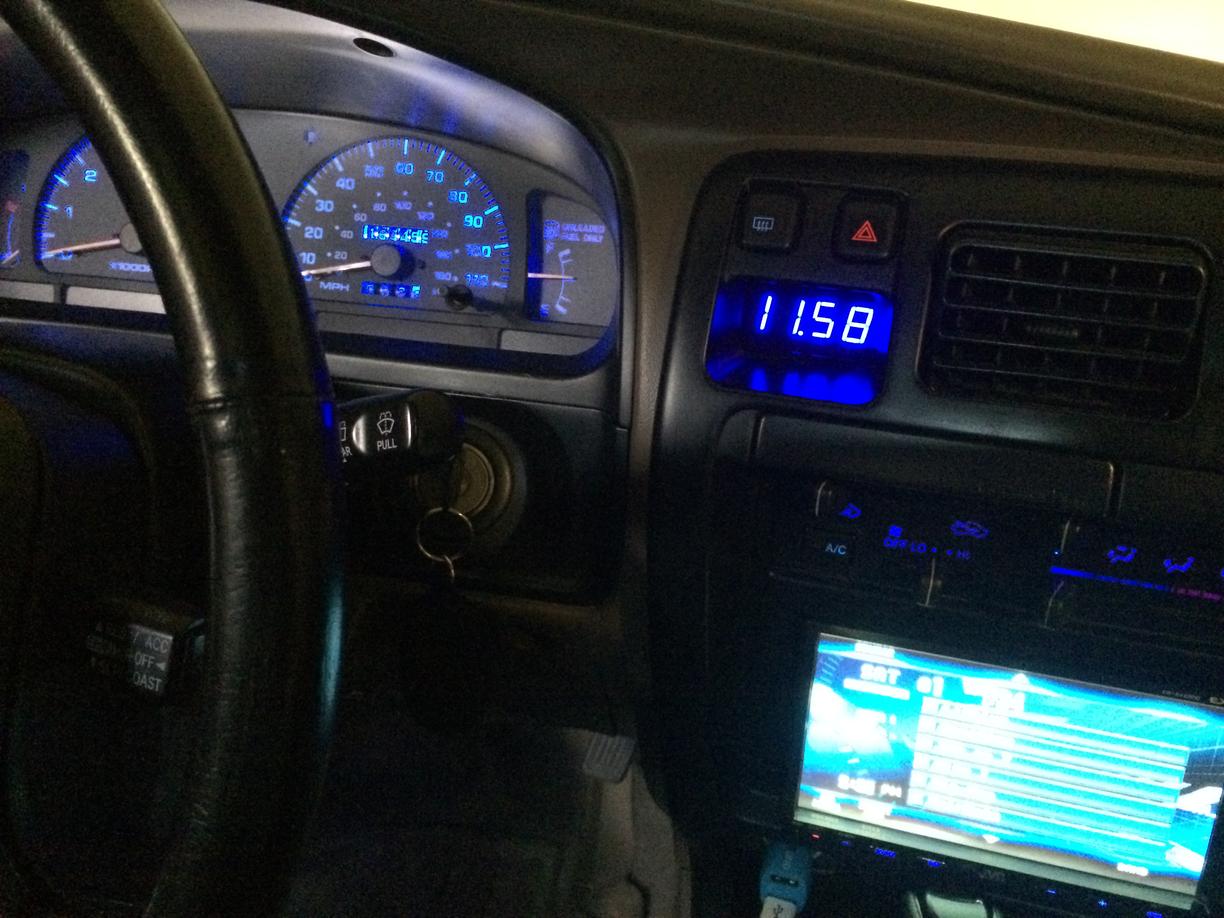

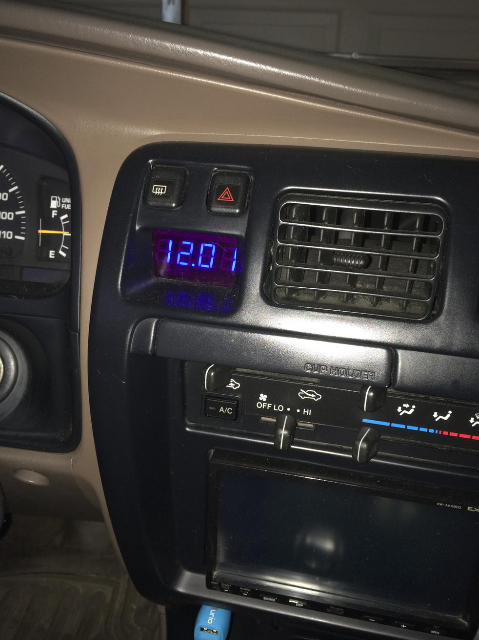

[MENTION=97632]Diesel_Dog[/MENTION], I did this a few years ago. I originally installed a temp gauge, but shortly switched to a volt meter that came from the same company and had the exact same housing. Heres the install thread I created.
http://www.toyota-4runner.org/3rd-gen-t4rs/118300-got-rid-my-clock-outside-temp-gauge.html
Heres what it looks like now. It is all wired right into my original clock power. As far as I know you can wire it into any power source (cig lighter, stereo, clock, ect) and you will get a proper reading. I love it and my stereo has a clock anyway.

Nice setup [MENTION=64040]dgoll75[/MENTION] ! I thought about doing that as the ebay voltmeter appears to be a perfect fit, but I fiddled with the clock for a good 4 hours to bring it back from the dead. I found a switched ignition fuse in the panel and tapped into it. I added in a fuse as well. The northern winters seem to be hard on batteries, so its good to know what's going on.
