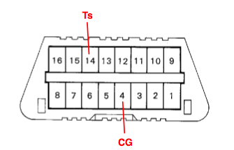

Try the zero point calibration. No special tools needed. Just a pair of wires. My VSC TRAC and VSC OFF lights came on after a tire shop used a scanner to try and debug my TPMS.
Instructions are here: http://www.toyota-4runner.org/attac...-calibration-br005-03_vsc-light-dtc-c1203.pdf
My simplified instructions:
  1. If the vehicle is equipped with A/T, ensure that the shift lever is in the “P” range and the parking brake is applied. If the vehicle is equipped with a M/T, ensure that the parking brake is applied.
  2. Use a pair of wires, put one in 4 and other in 14, make sure other end is not touching each other
  1. Turn the ignition switch ON.
  2. Repeat a cycle of closed and open between terminals Ts and CG 4 times or more within 8 seconds
  3. Verify that the VSC indicator light is lit indicating the recorded zero point is erased.
  4. Turn the ignition switch OFF.
  5. Be sure the terminals Ts and CG are not touching each other.
  6. Turn the ignition switch ON.
  7. Check that the VSC warning light goes off about 15 seconds after the ignition switch is turned ON.
  8. After ensuring that the VSC warning light remains OFF for 2 seconds, turn the ignition switch OFF.
  9. Connect terminals Ts and CG.
  10. Turn the ignition switch ON.
  11. After turning the ignition switch ON, check that the VSC warning light is lit for about 4 seconds and then starts quick blinking at 0.13 second intervals.
  12. After ensuring the blinking of the VSC warning light for 2 seconds, turn the ignition switch OFF.
  13. Remove the wires from terminals Ts and CG.
  14. Drive the vehicle for at least 5 minutes to confirm Zero Point Calibration is complete.

I followed the procedure that 46runner posted and it cleared both my "VSC TRAC" and "VSC OFF" lights. They had been on for a couple of months. Thank you!!!!!

I followed this procedure that 46runner posted and it cleared both my "VSC TRAC" and "VSC OFF" lights. They had been on for a couple of months. Thank you!!!!!
After you do 9 (connect wires) then 10 (turn ignition on) do you leave the wires connected then until 13 (remove wires) or at 9 do you just hold them while you do 10 then let go?
Over 10 years since this was posted, it has apparently fixed my issue. My commute tomorrow should be warning light free!
