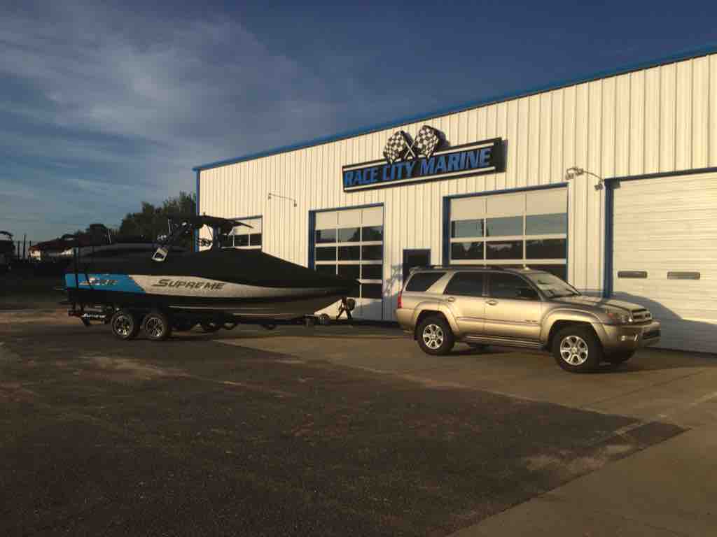

04 seems to be one of the best years for reliability. Perhaps because of air injection pump and cam phaser or whatever issues on the vvti. You won't be disappointed with the power. I tow a 24 foot boat and we are probably looking at 7000lbs total and it does great. Plus it's had only normal maintenance work in 12 years, 150K miles. No repairs needed except for cv boots. And most of those years were with towing, so it will be tough for you to go wrong.
