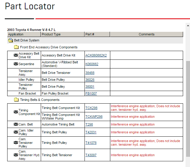

The vvti is interference as the cams adjust, that's what vvti does. The 03/04 does not ever make piston to valve contact in the event of a timing belt issue:)

The piston shape is different from non vvti to vvti, that is why it makes contact. I have both pistons next to me, the vvti also has different valve depressions for higher compression. If you think about a vvti motor losing the belt vs a non vvti losing the belt, the cam/crank relationship is irrelevant with no belt and the crank spinning.
Pretty sure the 2UZ-FE across the board is an interference motor regardless of VVTi, that just adjusts cam timing within a prescribed amount on a running engine. If the belt broke, it wouldn't matter because the valves are open when they shouldn't be as pointed out above.
Been hearing stories of when the belts break or a tech mis-aligns them bending valves for years even before the VVTi was a thing on these motors.
Pretty sure the 2UZ-FE across the board is an interference motor regardless of VVTi, that just adjust cam timing within a prescribed amount on a running engine. If the belt broke, it wouldn't matter because the valves are open when they shouldn't be as pointed out above.
You are right about that. This document from the Gates belts website shows that the non-vvti engine is an interference motor.

I actually searched for the non-vvti as I hate interference engines and the 03-04 non-vvti is non- interference.
I'm pretty sure you still have an interference motor, vvti or not, the engines are still interference. I could be wrong however (it happened once to me when I was 11).
Everything I've read says that all of them are interference. Someone emailed Toyota to ask, and they didn't answer the question, but they said it's important to change the timing belt at the recommended interval.
Even on a non-interference engine bad things can happen if the timing belt breaks. The belt can wrap itself around pulleys and damage things like oil seals. And usually the tolerances are very close so if something is out of tolerance it can become an interference engine.
I thought I was wrong once, but I was mistaken.
Well realistically speaking most every modern engine is technically an interference engine. Between the very tight tolerances, combustion chambers and so on, if the chain/belt goes when the engine is reving high enough the piston could clip a valve edge. I have seen a picture from a friend who had an engine snap a chain or something and the intake valve crashed into the exhaust valve which then crashed into the piston; that was interesting.
