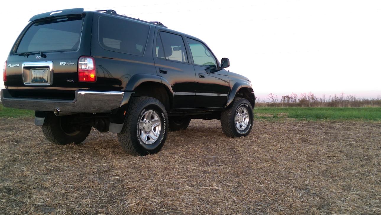

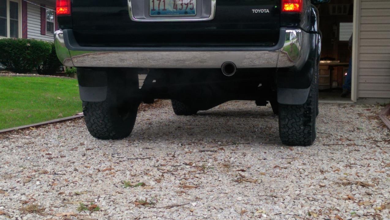

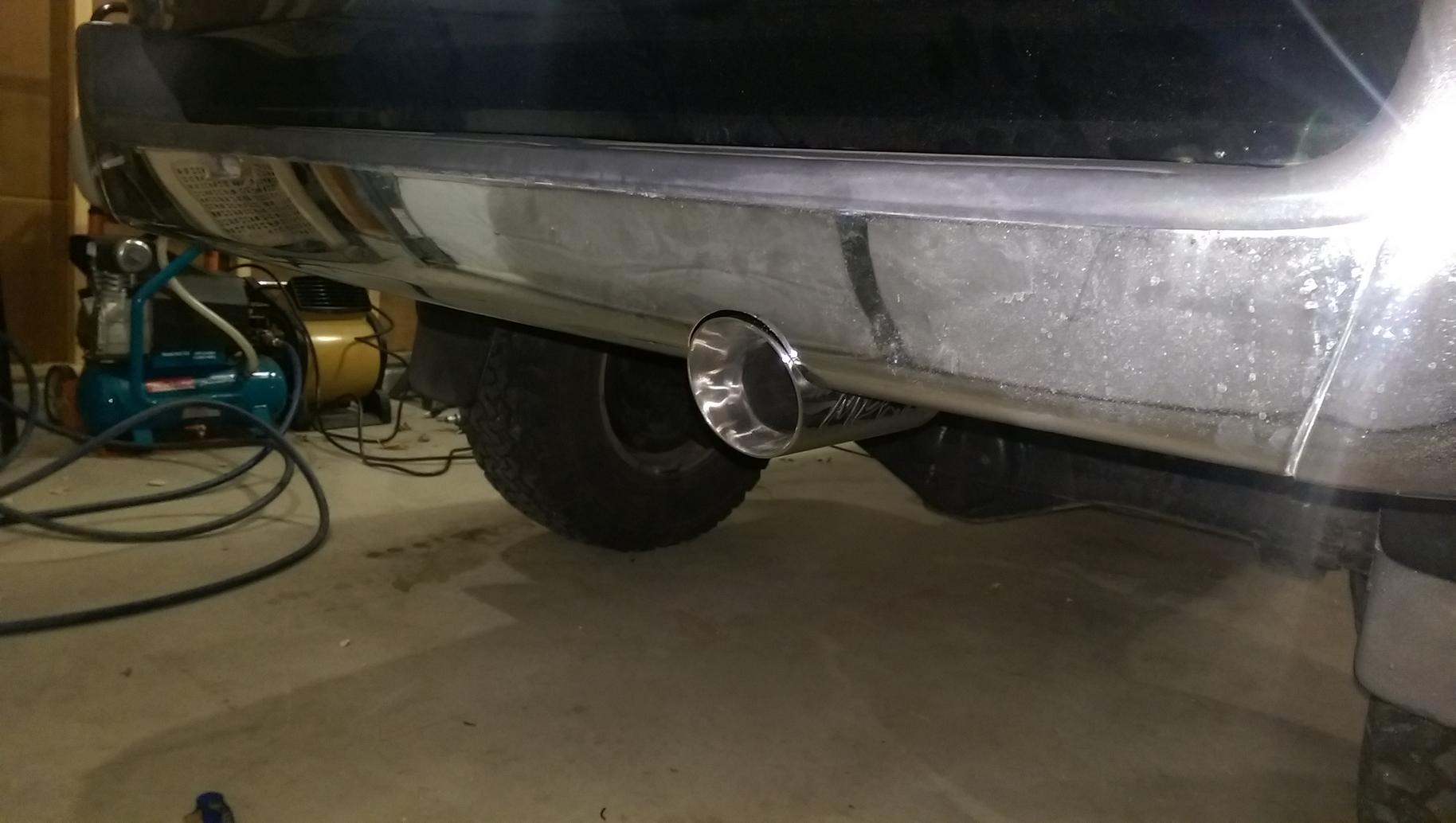

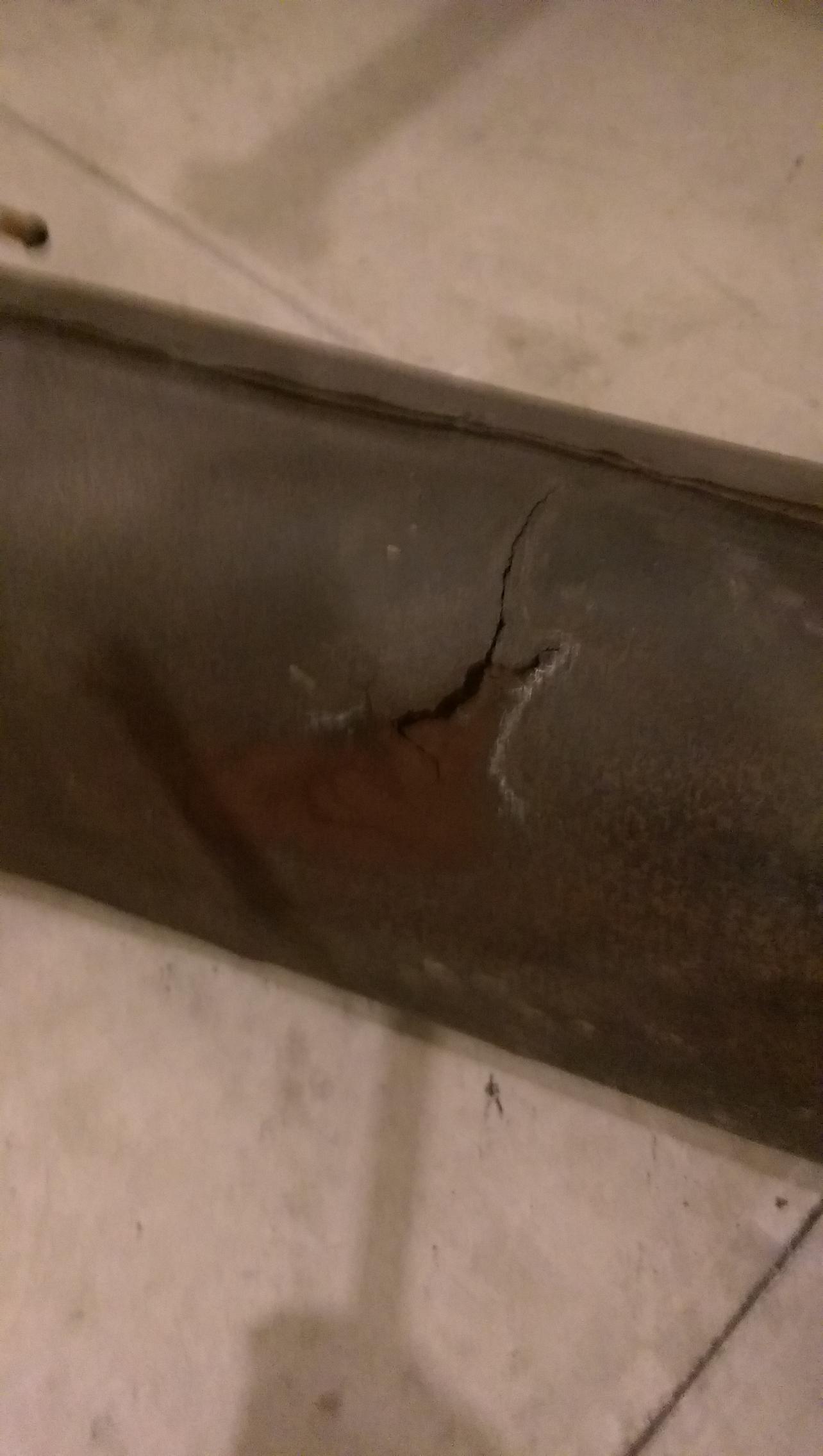

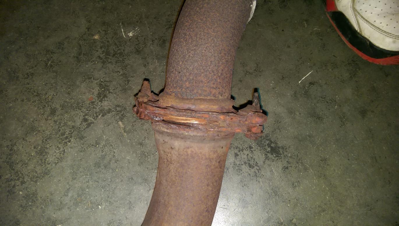

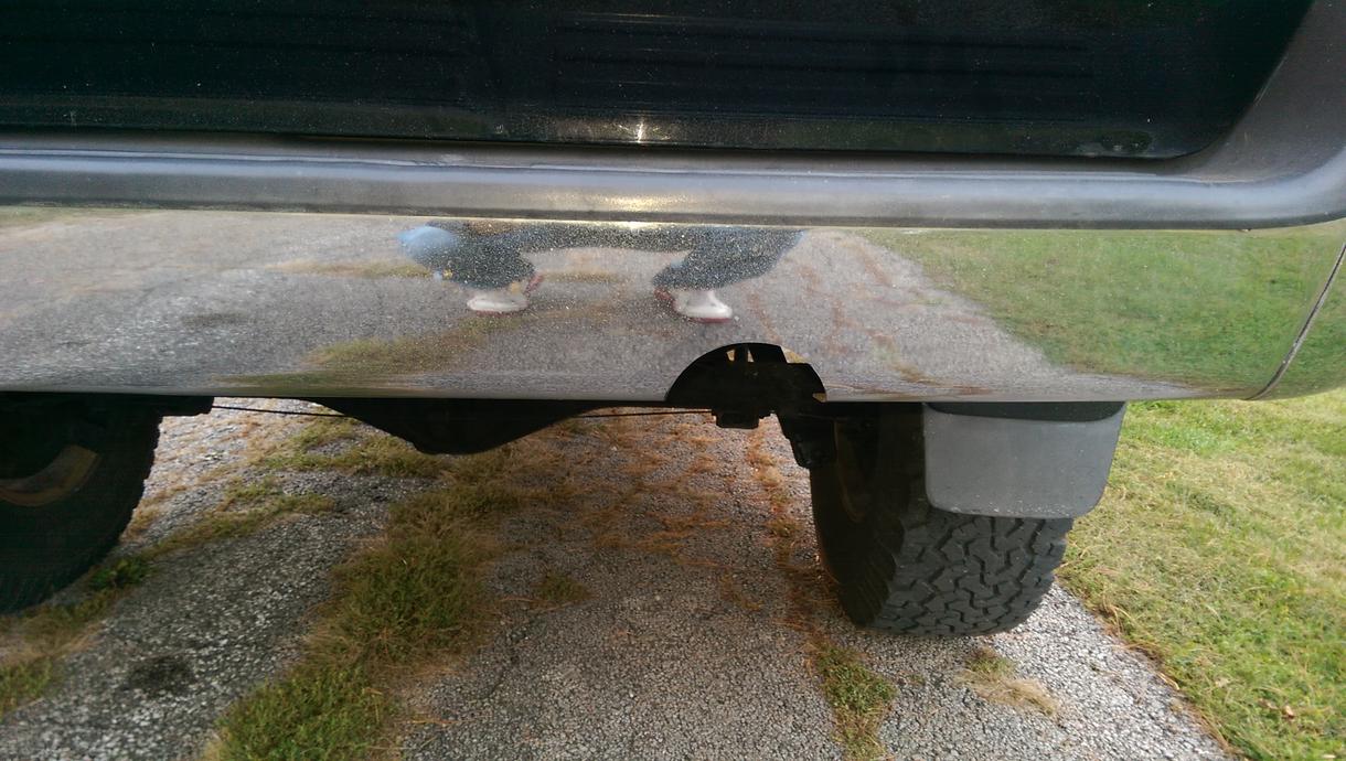

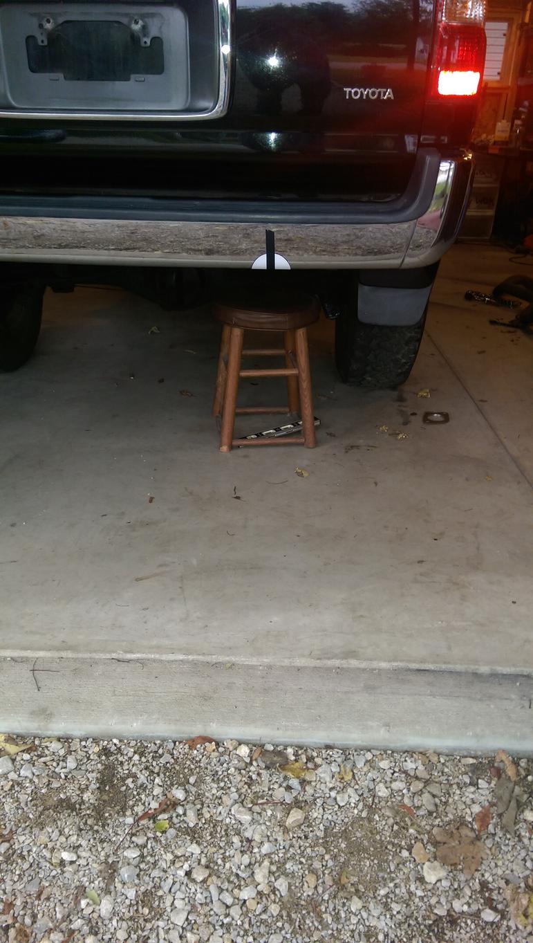

Though I would share my new Eeexhuuast with everyone, the old muffler was original with 187k on the clock, and with a good sized hole the seem on the side. as for the stock tail, The flange was completed rusted. After a few months of driving around with The terrible sound I decided to go ahead and purchase the walker quiet flow ss. My intention of the replacement was to create a nice tone for the truck and still be able to dd, and actually have all of the exhaust exit behind the truck! I also had opportunity to custom bend a new tail pipe and I used an angle grinder to cut a half circle into my bumper for the tip to exit.

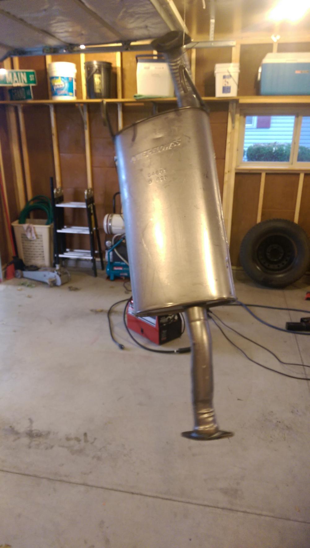

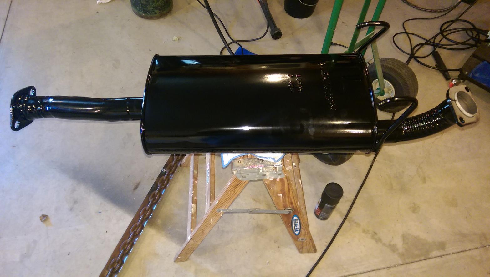

A buddy of mine also owed me a powder coat job, so I went ahead and took the muffler directly from amazon out the box and had it done in high temperature black for sh*t's. I figured it could at least help the muffler last longer. I have had many motorcycle exhausts done this way before as well.

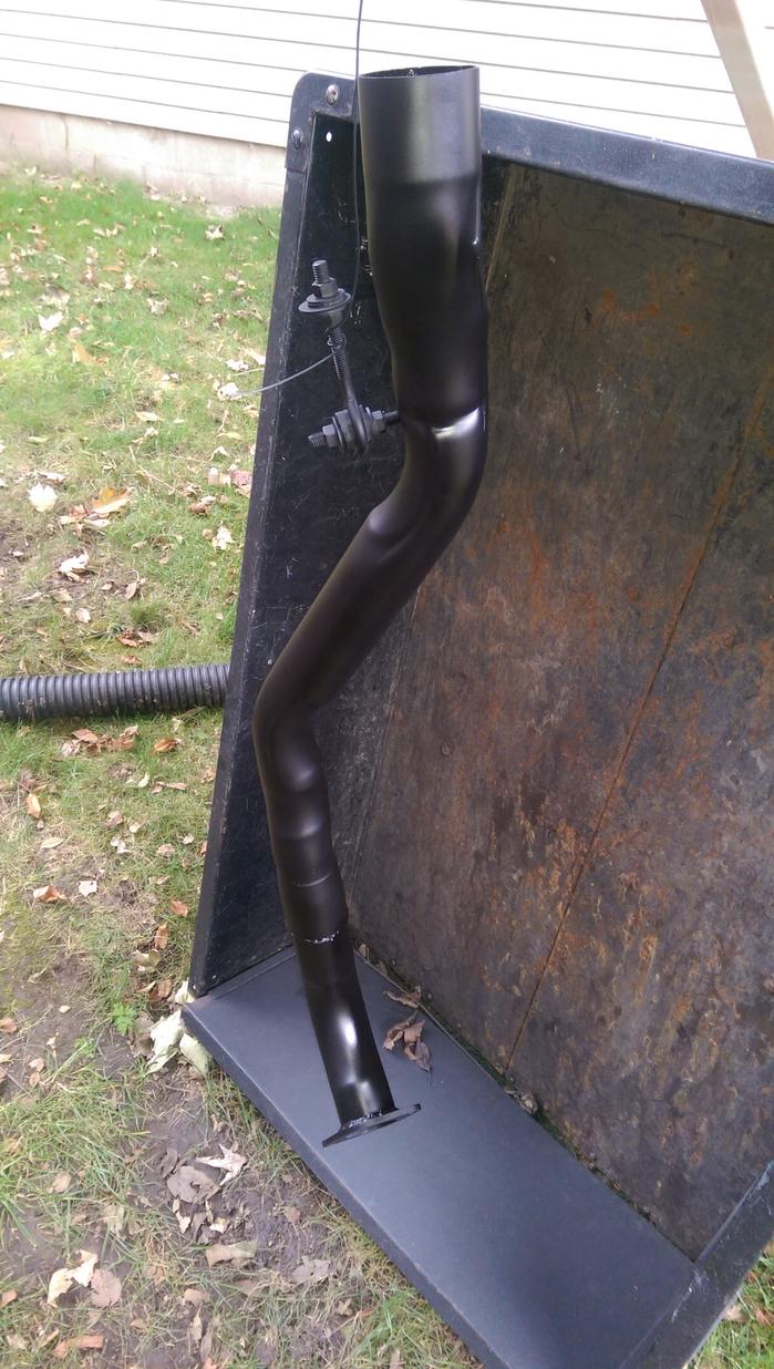

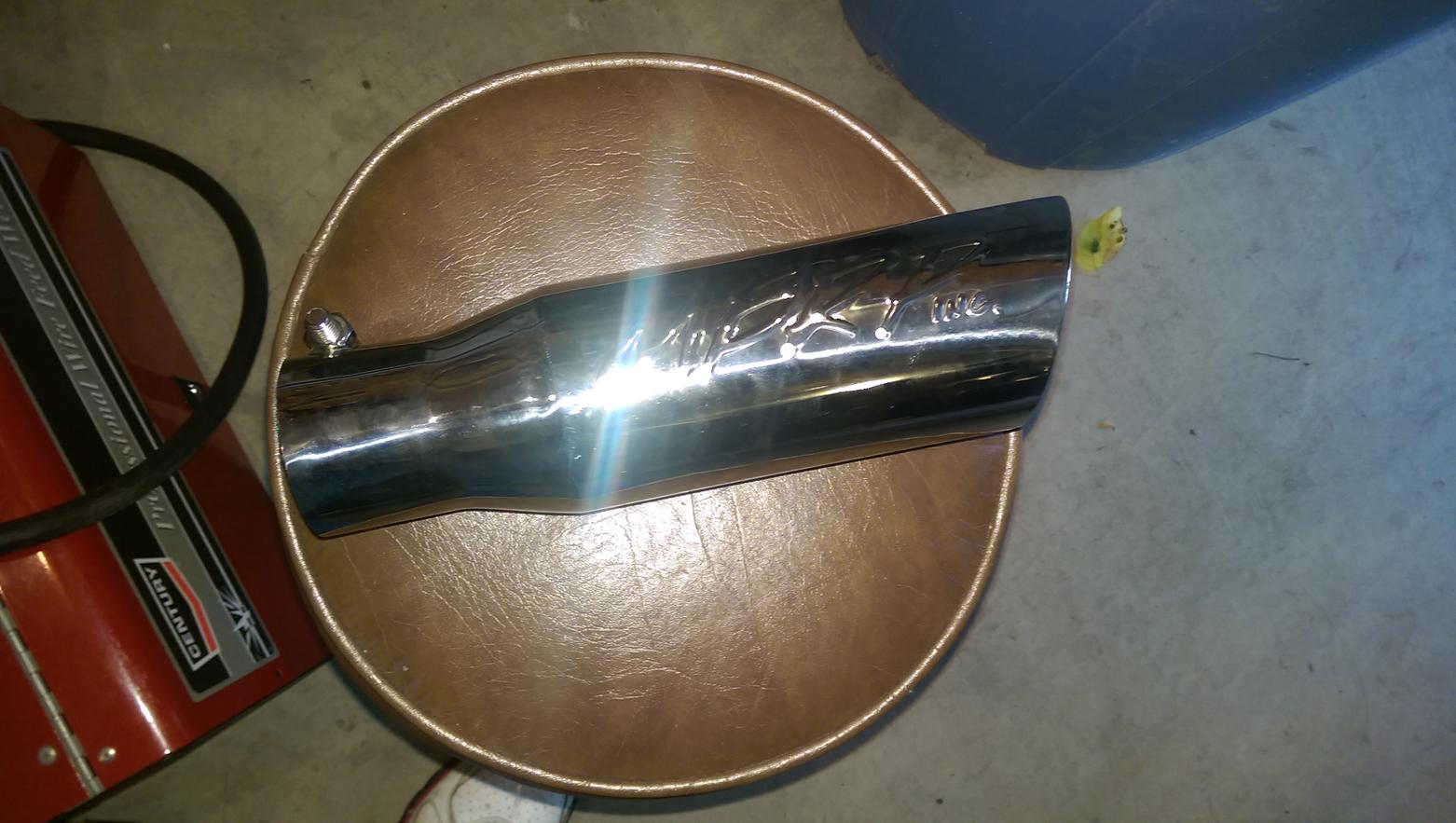

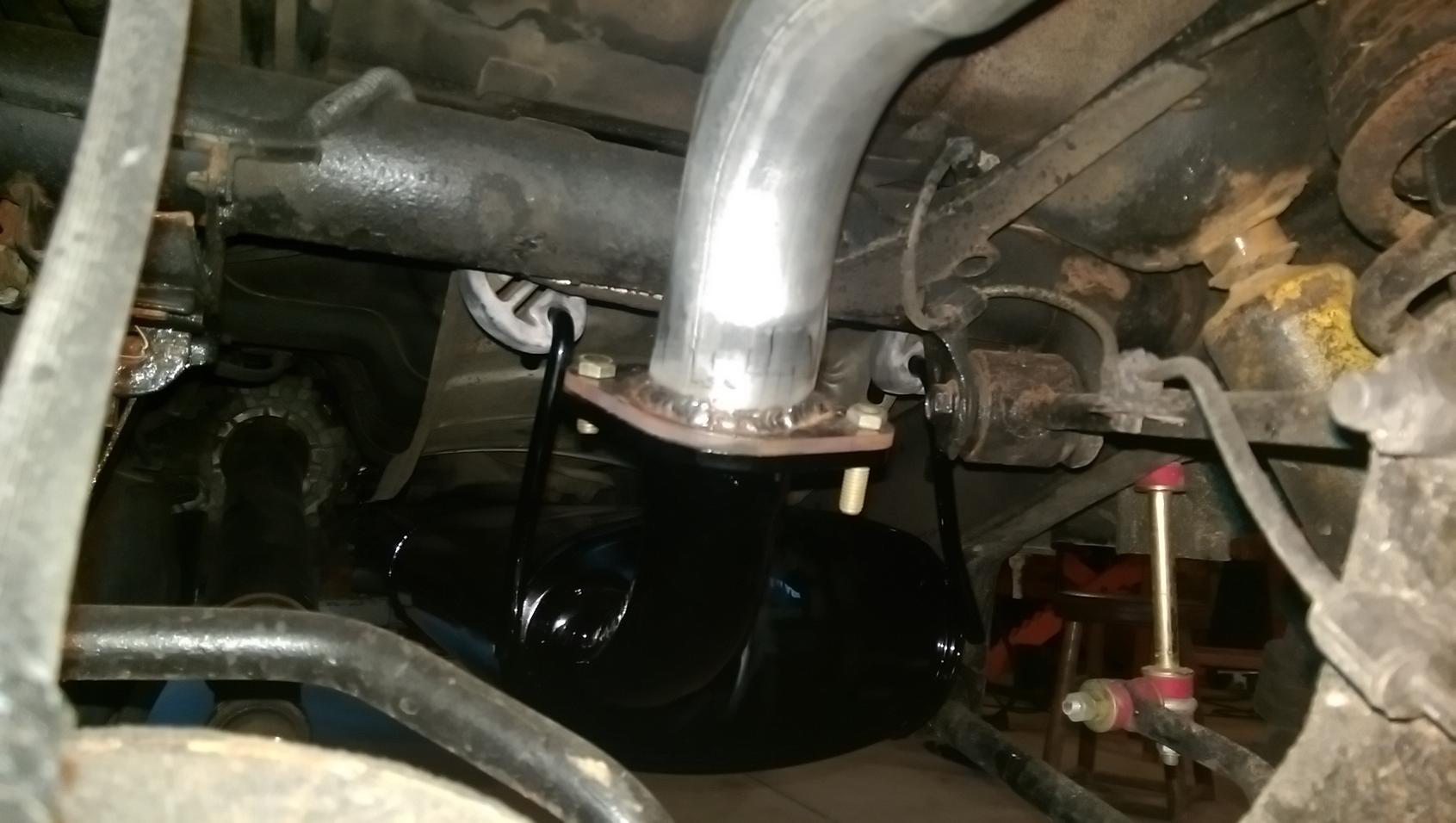

As for the tail pipe. I had the local exhaust shop bend me a single 2.25" pipe from the muffler to the location that I had cut for the exhaust tip that I had planned to use. The tip I have it a MBRP, I t was surprisingly one of the few exhaust tips I could find at the local truck shops but the OD of the tip is 3.5" originally I wasn't looking for a slash cut tip but I think it fits very well with the contour of the bumper. When it came to hangers and flanges for the new tail pipe, my dad has a water jet machine available to him at work, ( future plate bumper in the works ) where he has new 1/4" flanges cut, I only had to use one hanger and it is a piece of all thread with a series of screws through one of the cross members within the chassis. The gaskets were purchased ( multiple times ) at autozone and advanced.

more of the tail

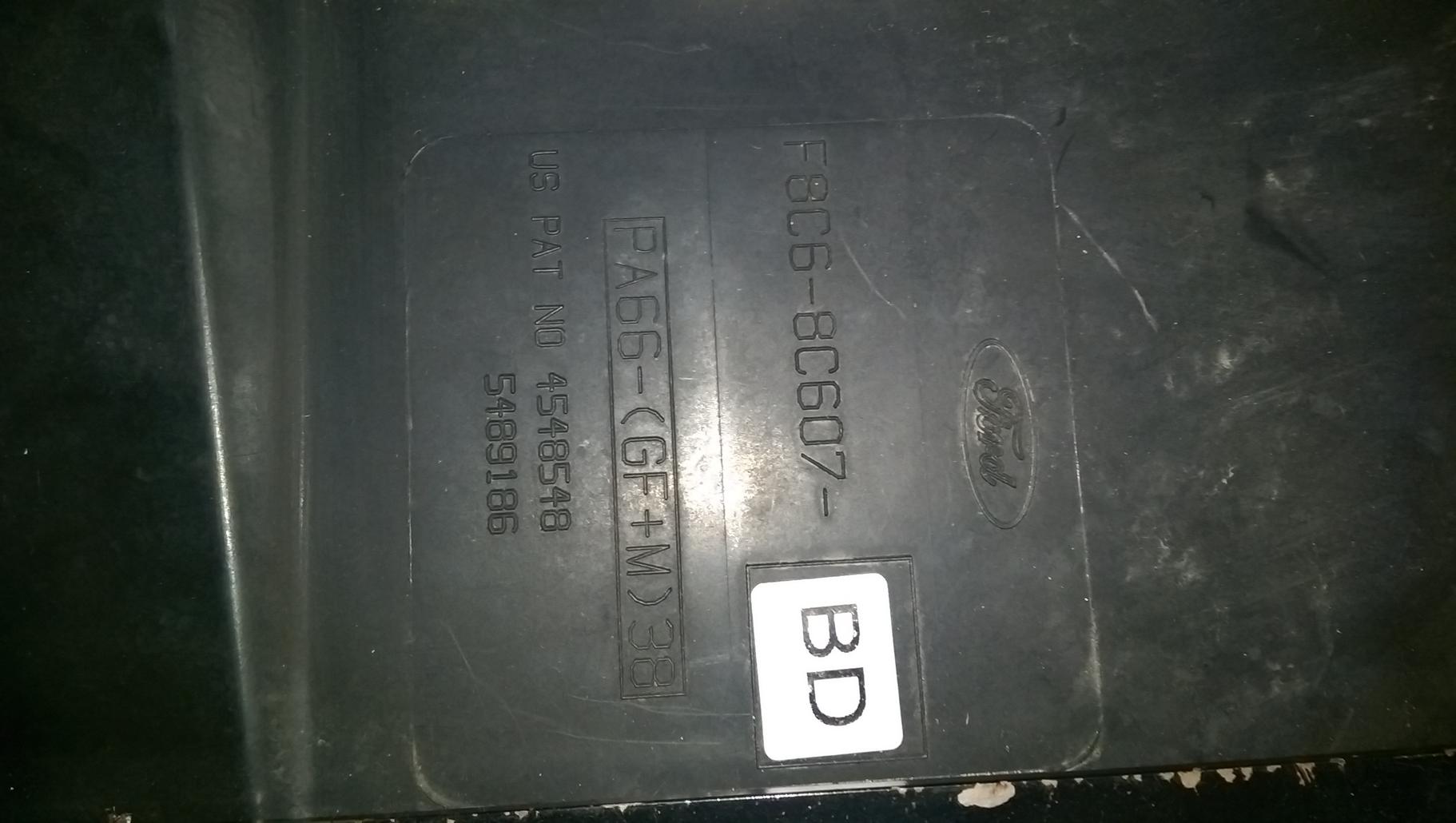

One more since I got it cleaned up, and a picture of the Numbers on the electric fan shroud that I have finally gotten a picture of, from a ford Zr2, I have been looking for some help as to how to wire this sucker up into my 4runner, as I have already built a full sheet metal shroud for it that I used one of my old radiators to use to mock it up on day. thanks for looking
Sound it just the way I liked, It has a great deep tone to it a idle and when it takes of the volume die down relative the the rpms but still maintains a good pitch throughout the entire power band. As for an increase in power, Behind the wheel I can say it feel a lot healthier! but I also changed my fuel filter with a wix 33319 at the same time of this project so the results of the muffler replacement itself may are probably skewed, I can obviously see better starts but will have to wait to see if fuel economy is increased at all or not. Glad to not have a obnoxious 4runner anymore!
