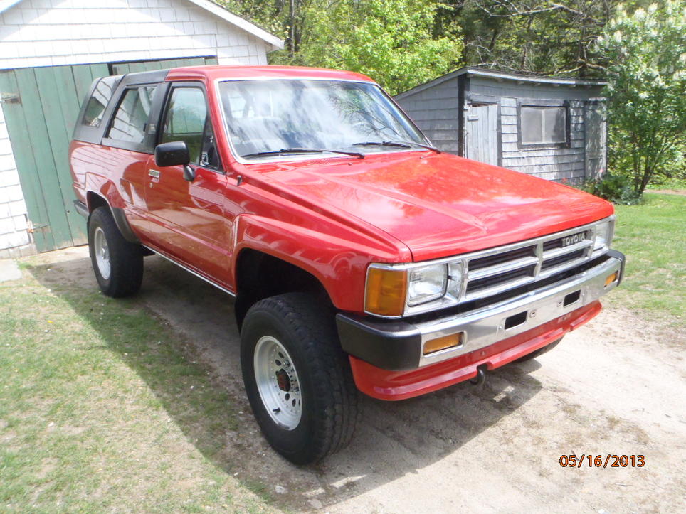

no build, as i bought one in pretty good condition, with low mileage - 97,097 when i purchased it in may 2013. previous owner had replaced both front fenders and rear quarters. it was a rear-seat delete runner, which i have converted to a normal 4-seat runner.
before putting it on the road, i finished por-15 painting the underside and frame, as well as repairing the rocker behind the driver's front wheel. this had rotted out i believe because of a leaking master cylinder, either the brake or clutch. both have been replaced, and don't leak.
pics from the day after i brought it home, followed by other pics. interior was in pretty good shape, with a single small dash crack to the right of the inclinometer.
plans are not to deviate a whole lot from stock configuration. i bought this to be my work vehicle, replacing my 300K-mile '95 subaru wagon. i don't need it for wheeling, as i have a decently built '75 cj-5 for that, which is my toy.

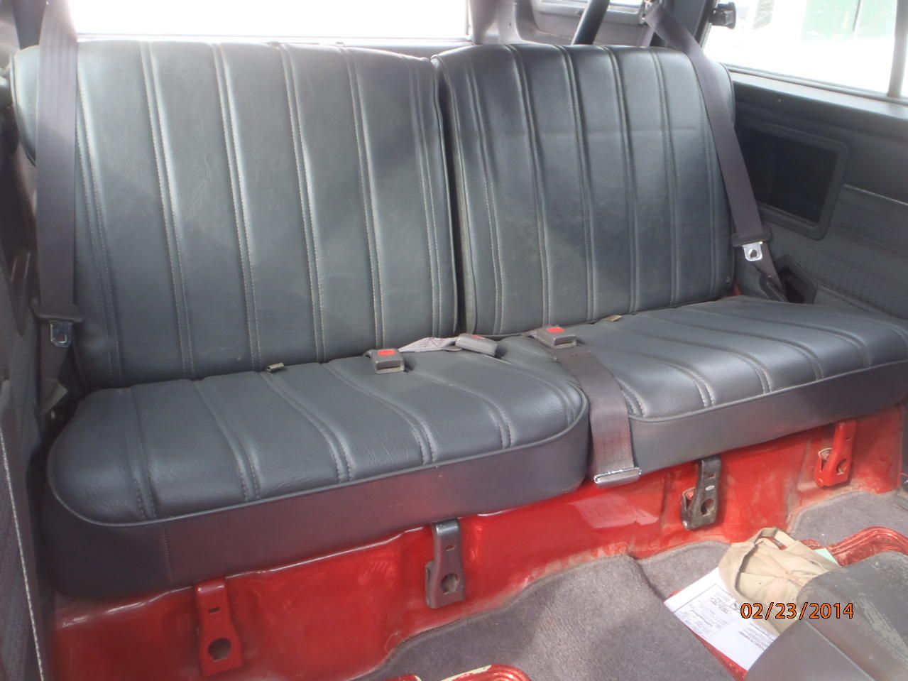

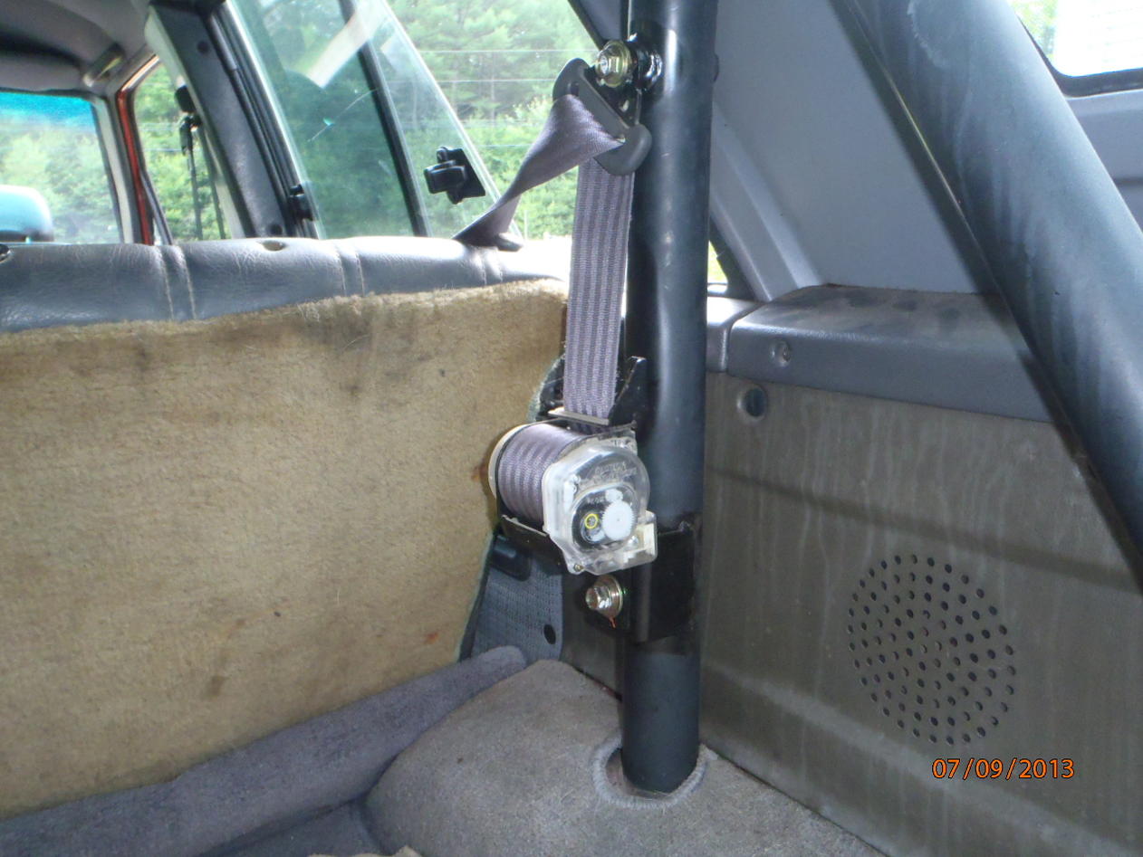

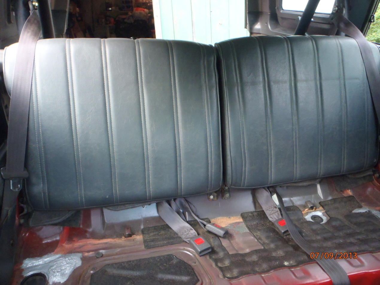

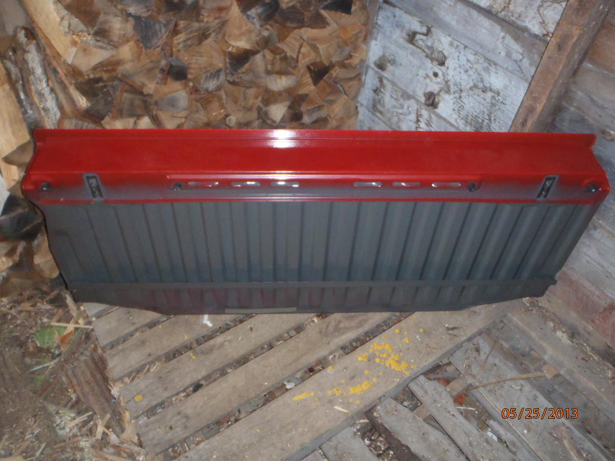

a local guy parts out 80s and 90s toyotas, and i've managed to pick up a bunch of stuff from him. the list includes the rear seats, radio antennae, spare tire, lug nuts for the stock wheels (4-spokes) which have brand new snows on them, a dash speaker, rear seatbelts (which i ended up not using), a clutch slave cylinder, the gas filler neck rubber gasket assembly, and a front skid plate.
the rear seats were mixed. the bottoms were in tough shape, but the backs were in pretty good shape. i took the bottoms to a local auto upholsterer and he did a really great job matching the fabric from the backs. it did take a few months, though. meanwhile, after no luck finding factory rear shoulder belts, i tried, and installed, the rear belts from my retired '95 subaru wagon. they fit perfectly, using the stock 4runner mounting points, including the roll bar. http://www.toyota-4runner.org/classic-t4rs/118545-installing-seat-belts.html#post1425471

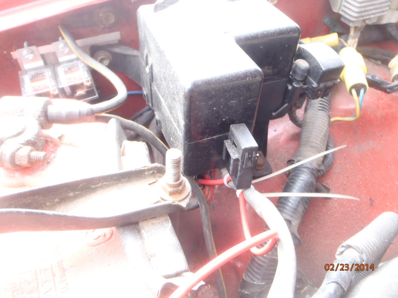

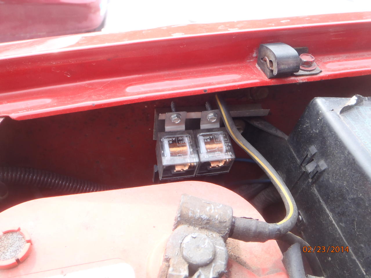

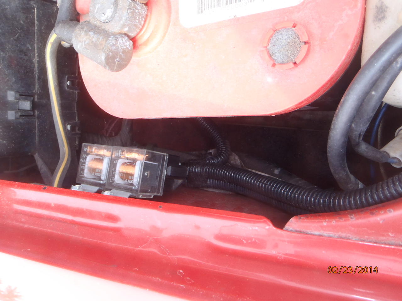

i read quite a bit about RAD4r's build, and did some electrical upgrades based on that (again, many thanks to ray for his insight and expertise).
i fixed the factory mistake for the headlight wiring, which can lead to a burned out column switch, and installed a ceramic harness/relay next to the battery. i also addressed the poor factory wiring in the starting circuit, so that the majority of the current goes through the relay rather than the keyswitch contacts. although i wasn't having any issues with either the high beams, or starting, it seemed to be a really good way to avoid future known problems.
edit: i've added pics of the new headlight relay assembly that i installed. i mounted the relays next to the battery & fuse box, using some thin sheet metal and screws to attach to factory holes on the inner fender. the relays are visible mounted to the sheetmetal, while the new fuse is visible zip-tied next to the fuse box.

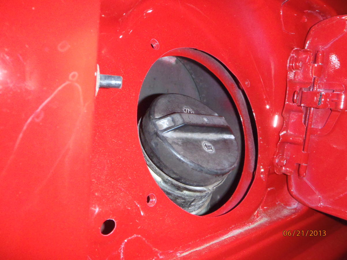

after driving around a bit, i could tell the gas tank had a leak. i purchased a replacement and took it up to my brother's shop in burlington, vt to install it. this went pretty well, and i even got to replace a few broken-off bolts in the skid plate assembly.

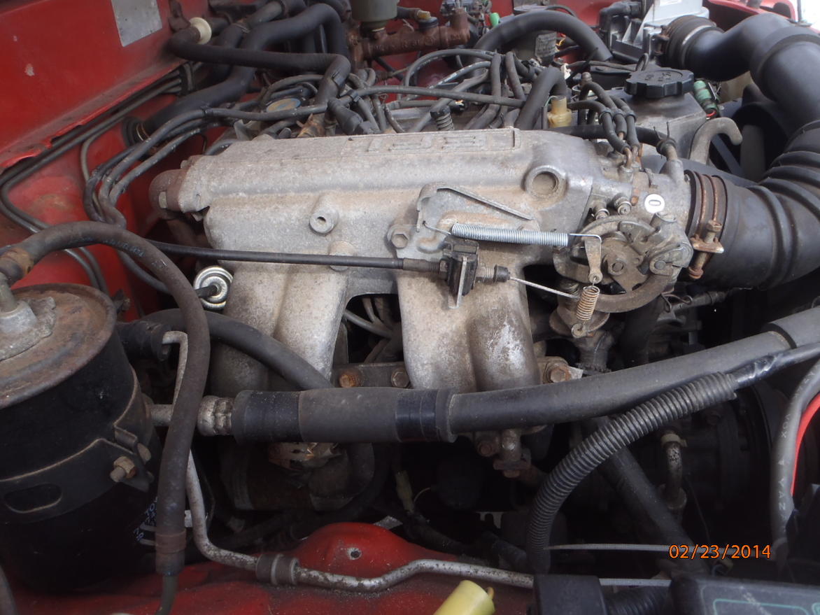

tested the AFM, and got some out of spec numbers. plus, the CEL kept throwing codes for the AFM, for a failed temp sensor, and position. i replaced the AFM with a rebuilt, and the codes went away (and haven't returned). still had hard starts. also got a repeated code for failed O2 sensor, and replaced it (no more codes, either).
in bottom pic, you can just see the new AFM. the extra spring on the throttle assembly was added to deal with a sticky high idle issue. once the spring was added, the high idle at stops disappeared.
i couldn't get it. took it to a good friend's local shop, and he solved it in about 30 seconds. the fuel pressure regulator diaphragm leaked, allowing gas up into the vacuum line, directly into the manifold. thus, the overrich condition most times, unless the truck sat for 5 or more days. he replaced it, and the starting issues disappeared. the new regulator is visible to the far left in the bottom pic.

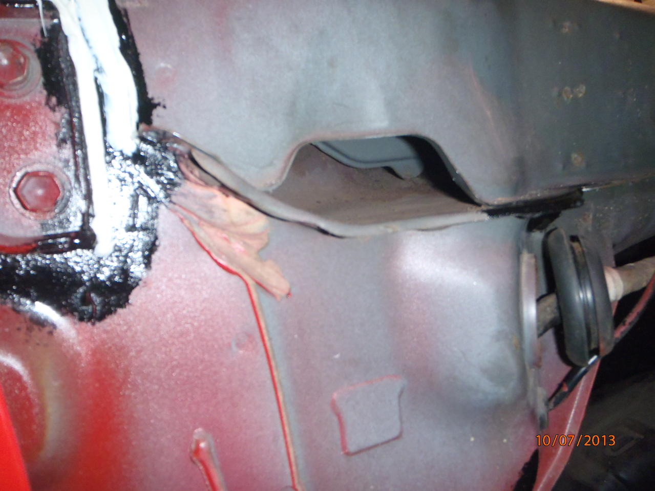

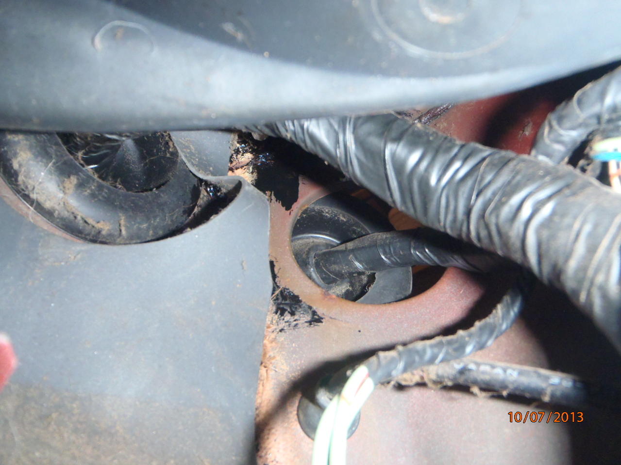

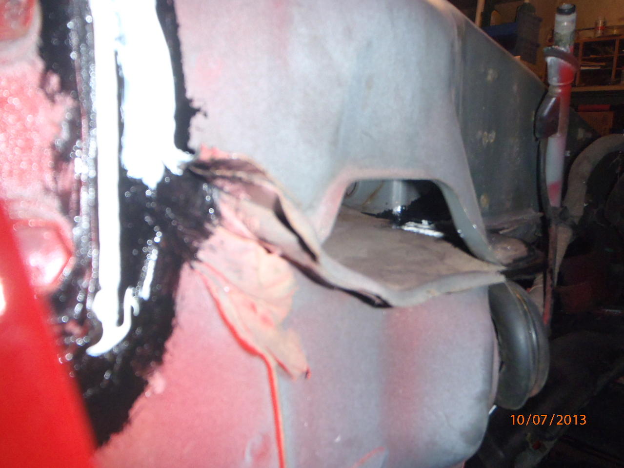

had a leak in the passenger side, below the windshield, up under the dash, which was getting the ECU damp. i eventually traced this to a leak on the inner fender, above the wiring grommet, at the weld behind the hood hinge area. this is a REALLY difficult place to reach.
i took off the front fender and the air inlet piece that runs below the windshield. with difficulty, i could clean out/scrape the rust behind the hinge, and painted it with por-15. after painting, i added silicone caulking, just for insurance, using a popsicle stick to reach in and apply it.

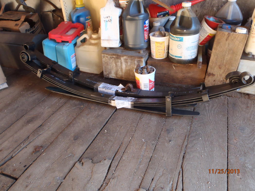

i've ordered some stock rear springs to replace the flattened ones that are 26 years old. the new ones have thicker steel individual leaves, but should provide stock height. they came with the spring anchor bushing, but no shackle bushings, which i orderd from toyota. (actually, i've had the springs in my garage for a while now, just need to take the runner back up to my brother's shop for the install, along with a 4 wheel alignment on his new rack.

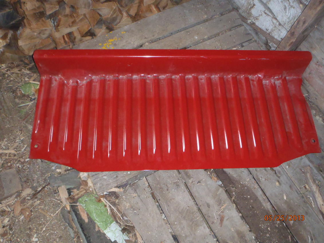

Wanna sell that rear seat delete panel?
absolutely. make me an offer, and if we can find a fair price, it's yours.
i've got the side hardware for it, too, which attaches the plate back at the seatbelt retractor hardpoints. the front attaches using the factory seat hinges (the outer two). there are absolutely no dents or any rust on this thing.
edit: i believe it's in such good condition because the rear carpeting extended all the way to the front. i'm still using the carpet, just rolled it up behind the rear seats, rather than slice it. i believe the runner was red originally, and was repainted in close to factory red. this delete panel may have been repainted, or it may be factory paint. i don't know. it isn't twisted or bent, either. minor paint wear is visible, and some scrathes. but no rust. no surface rust. no rust through. NO RUST.
I honestly don't know what it's worth, and shipping might suck. If you can get me the exact dimensions and the weight, I could work up a rough shipping estimate and we could go from there...
replacement springs that hopefully go in this weekend. these are replacements, not lift springs, so should more or less keep it stock height. also picked up new shackle bushings from toyota. once installed (springs), i'll also switch to the stock rims which are mounted with brand new snows, and get a 4wheel alignment.

springs successfully installed. brings the back up so it sits level, rather than sagging. smoother over bumps now, too, since the springs aren't flat and have some flex in them. switched over from the summer tires/aftermarket wheels to the stock 4-spoke wheels with snow tires, in the 30x9.5x15 variety. actually quieter than the generic tires that were on it when i purchased it.

Cool ride. Lets see a post install pic with the springs.
I gotta question about the contents of the white jug labed "Used Turd" in the pics of the leaf springs though. Whatcha got in there? :confused: :bounce:
i'll get some "after" spring pics soon.
although it looks like "turd" it really reads "turp" as in turpentine. :toilet:
pics with new stock rear leafs installed.

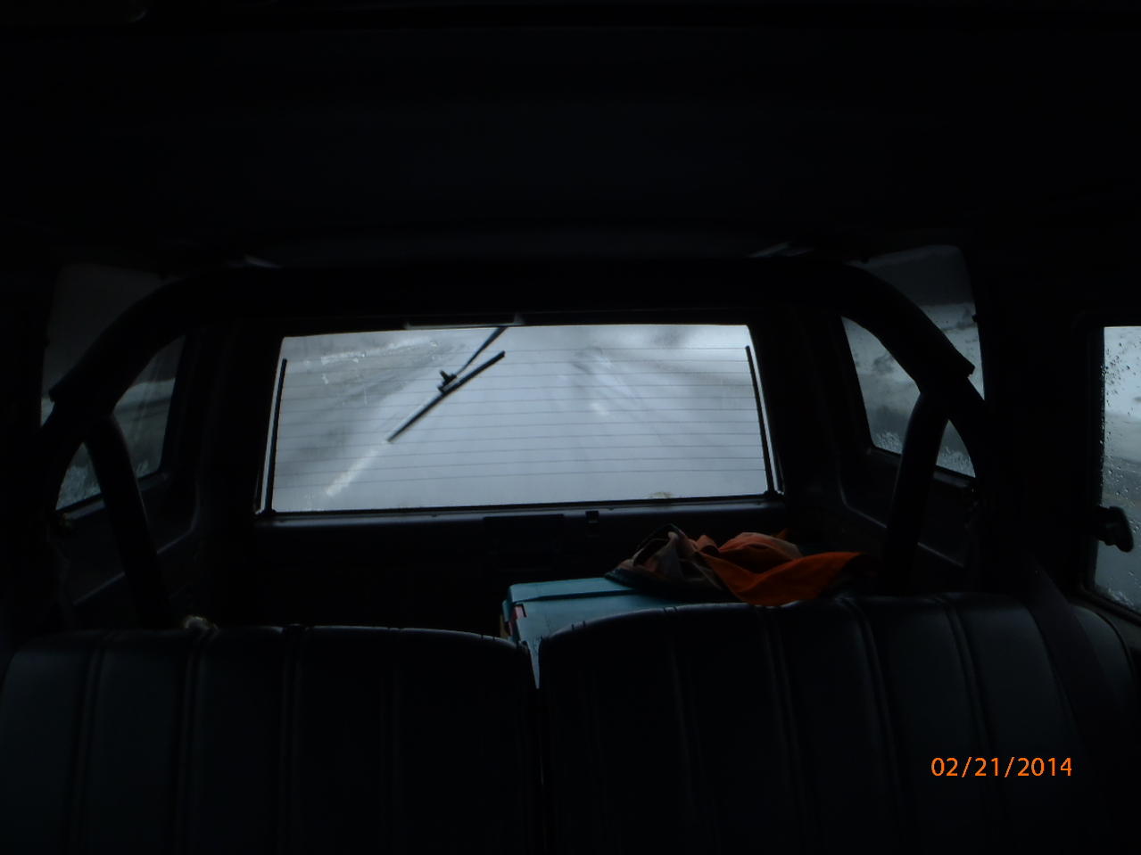

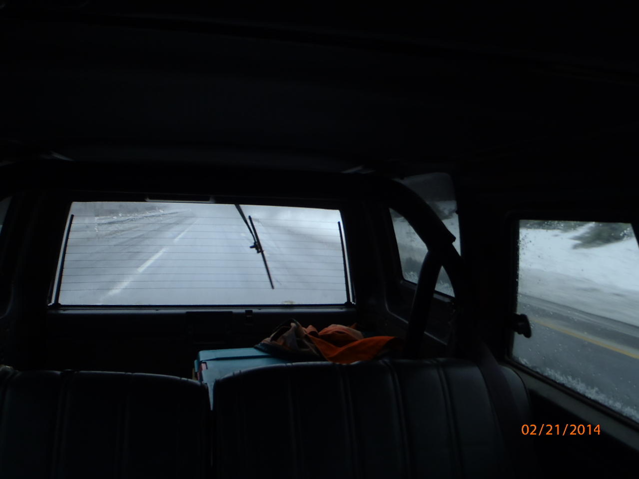

finally got around to making the rear wiper functional. it operated all along, it just wouldn't touch the glass - too much corrosion in the wiper pivot/spring mechanism/bushing.
so, i took the whole thing off, and sprayed it liberally w/WD40 while working the pivot up/down repeatedly (oh, and i removed the spring to make it easier to do this). eventually, it got loose. i then sprayed the bushing with a small amount of PB'laster and worked it in. reattached the spring, and and went back out to the 4runner, and put the wiper assembly back in place.
the moment of truth. put ignition switch to on, pressed the rear wiper button, and it worked, cleared some glass - and the washer works to boot. not perfect, but at least 75% of the wiper blade makes contact with the glass surface. much better than it waving in the air above the glass.
some "action" shots:

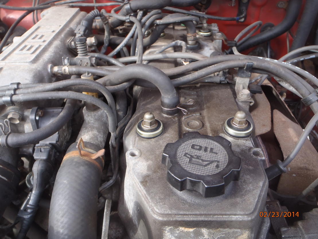

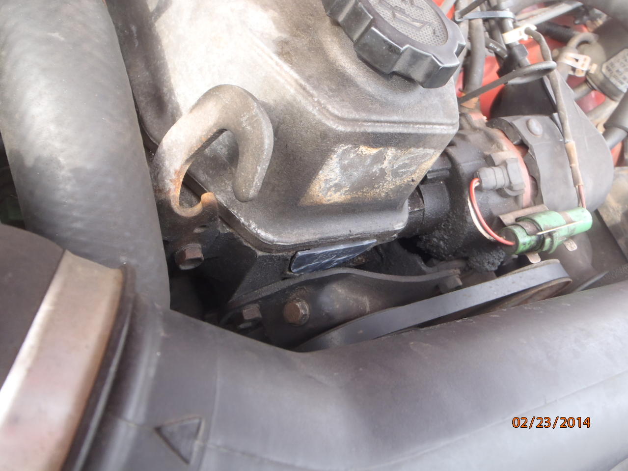

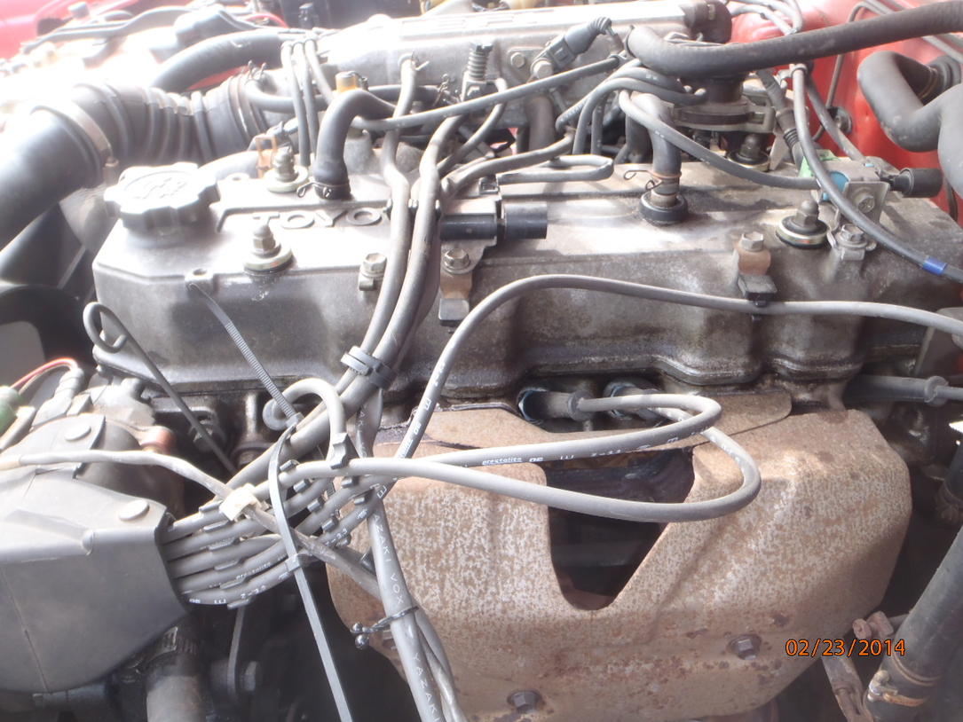

figured the valve clearances were due for checking/adjustment, as i've put 11K miles on since buying the runner, with no clear record of the last time they were adjusted/checked.
i must say, for all the glowing/fawning over the 22re, there are plenty of features that i find irritating. perhaps it's more the design of the engine bay than the engine. really shouldn't have to disconnect the coolant lines that feed the heater in order to easily remove the head cover (note, i didn't disconnect them, but it is a real PITA to get the cover off with them in the way). this is a potential mechanism to introduce dirt into the valvetrain, as whatever is still on the cover can be scraped off/dislodged while finagling the cover away from the heater hoses. stupid.
all the other hoses/connections were easy to remove or tuck out of the way. rotating the engine isn't particularly easy, either. the front skid is in the way, and prevents easy access to the crank pulley bolt for easy turning. instead, i used the power steering pulley bolt while pressing hard against the belt between the idler and crank pulley to get the engine to rotate to line up the timing marks.
once the marks were lined up, the adjustment itself is very simple and takes only a few minutes. then the laborious process of rotating the crank 360 to adjust the other four valve clearances.
at least the kit came with the head cover gasket, the four stud nut gaskets, and the two half-moons. visually inspected the timing chain and guides, which look to be in excellent condition.
i suppose the next time i'll be able to do it a little faster.
edit: added some pics of completed project. can see the new front half-moon, and the new gasket/bushings that go under the acorn nuts.

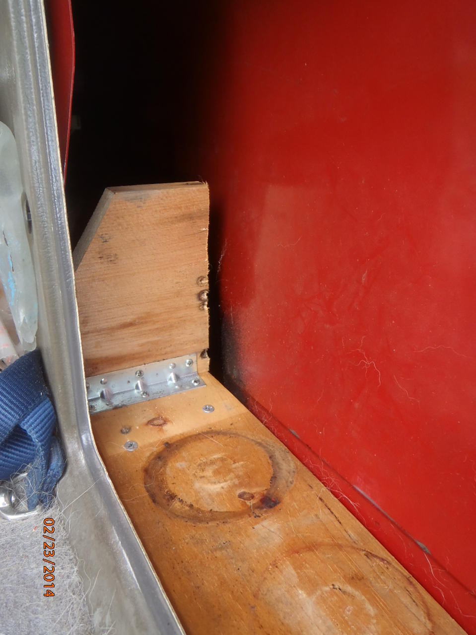

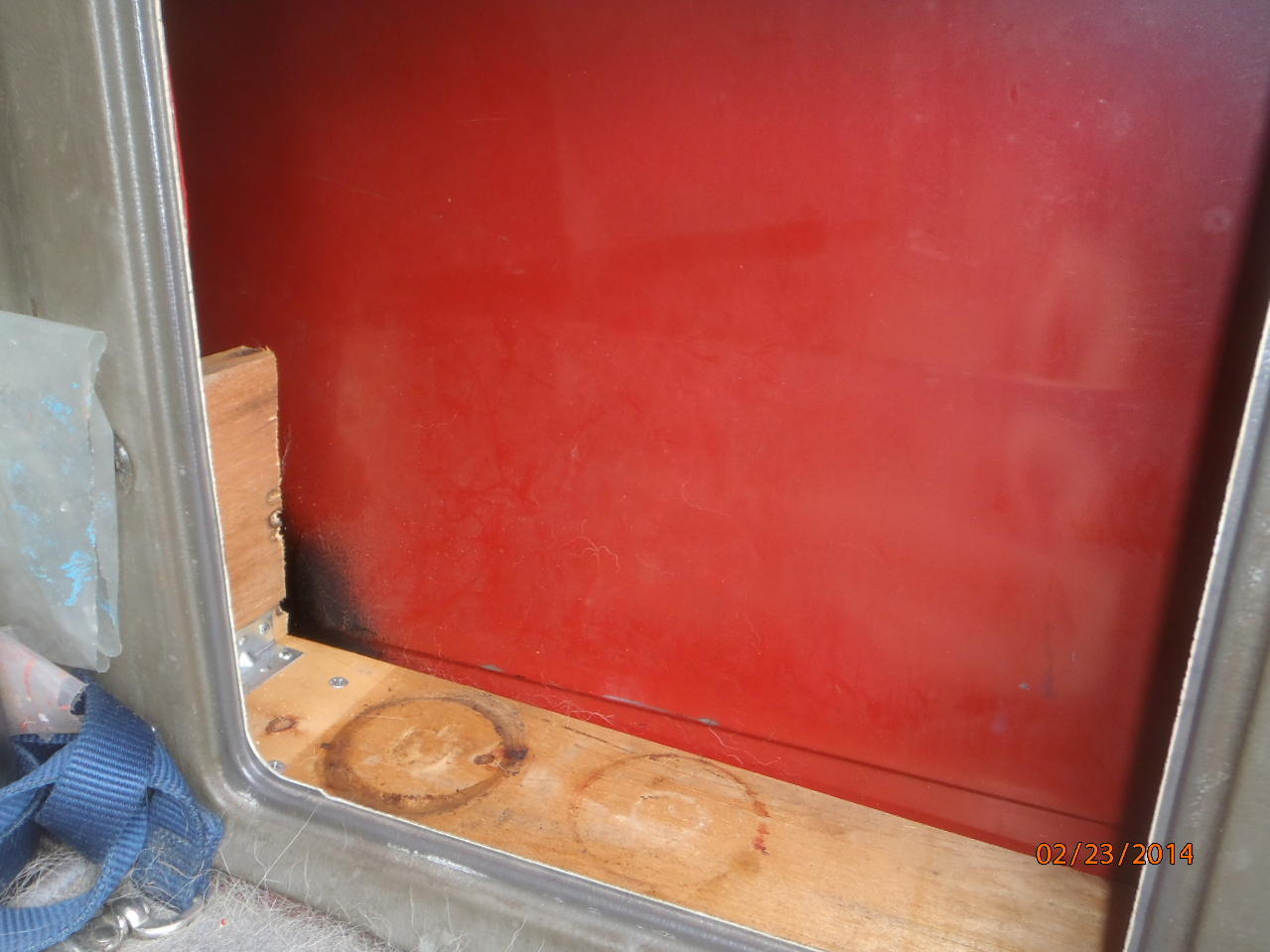

i didn't like the rear storage "box" on the passenger side. too deep, and stuff just sits at the bottom in any moisture that might get in the inner rear quarters. so i added a simple shelf to store some things that i prefer to keep dry or out of the way. it's a 1" thick pine board, trimmed to fit the space, with a brace and another trimmed piece of 1" wood at the forward end to prevent the stuff from disappearing inside the panel. the two screws in front of the hinge attach a "foot" to keep the shelf at the correct level. keeps the stuff clean and dry so far (about 5 months).
