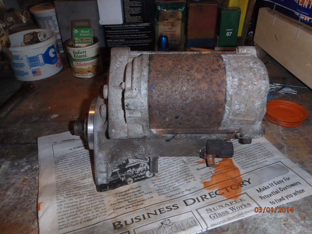

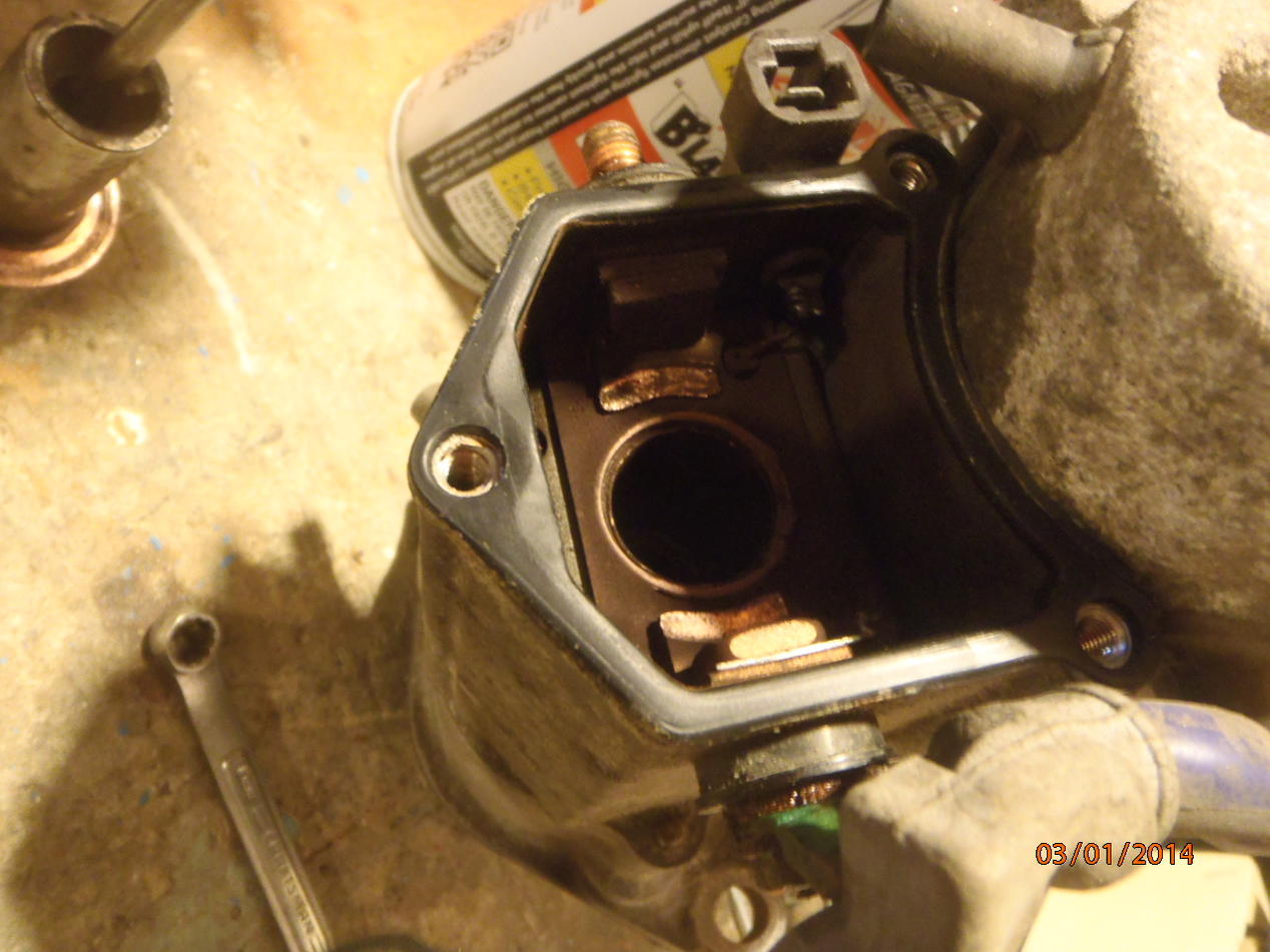

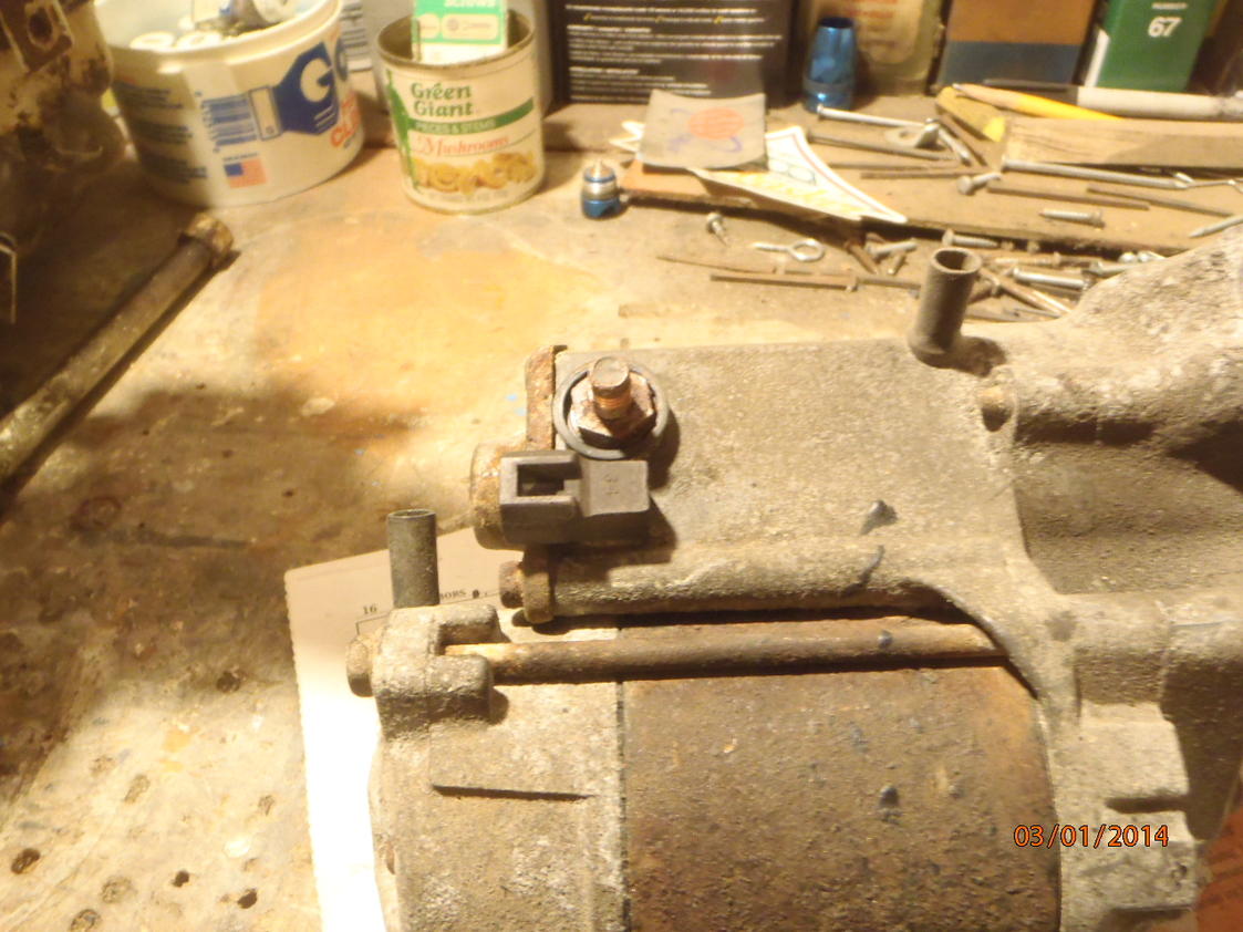

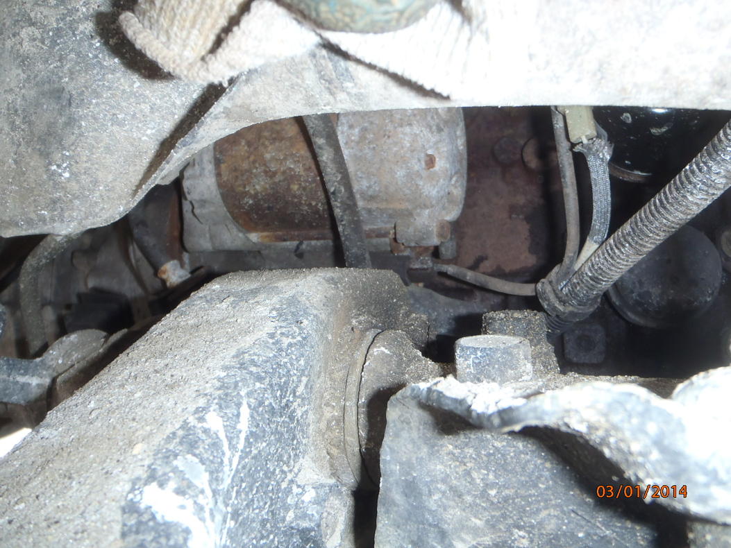

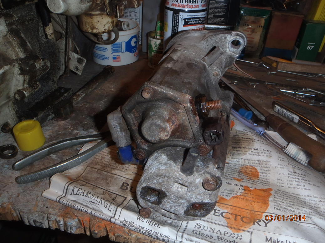

had a click-no start today. first time that's happened with my 4runner. after about 15 key-turns, the starter finally engaged and it started right up.
i've already addressed the factory wiring flaw in the starting system as outlined and broken down by RAD4r. and, a few months ago, my wife's '97 corolla had a solenoid contact issue, which i fixed by replacing the worn contacts with new. in doing this, i discovered that my 4runner has the same starter series as the corolla, so when it didn't start today, i figured it was the solenoid contacts.
and i took pics of the process.
there it is, in all it's so close yet unnecessarily difficult to remove glory. requires 14mm sockets or wrenches to remove, along with extensions/swivels. i chose to remove the fender flaps to get a better view.
second pic shows the 27 year old starter on the bench. a little corroded on the outside, but not bad. i wire brushed the bellhousing contact areas, so they are shiny.

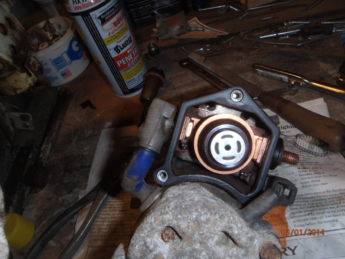

third pic shows the cover that needs to be removed to access the solenoid parts - the contacts and the plunger. the three bolts (w/philips) are 8mm. i squirted the bolts, along with the contact studs, with PB'laster. the cover bolts came out with no problem.

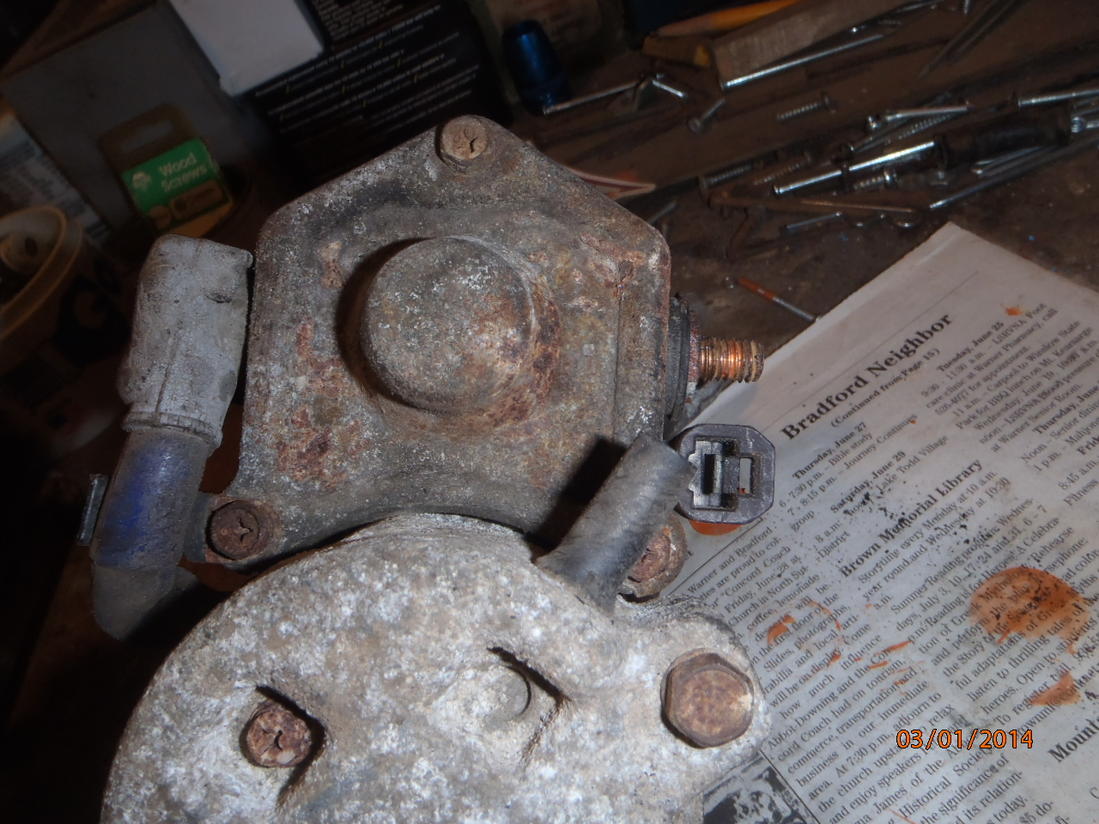

fourth pic shows the battery cable connection and the solenoid energizer wire.

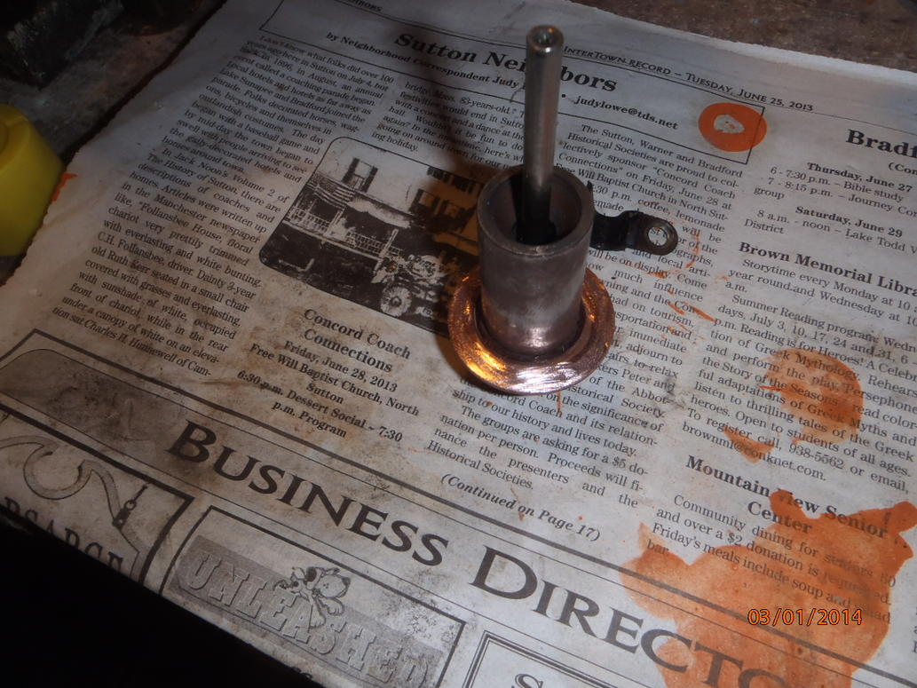

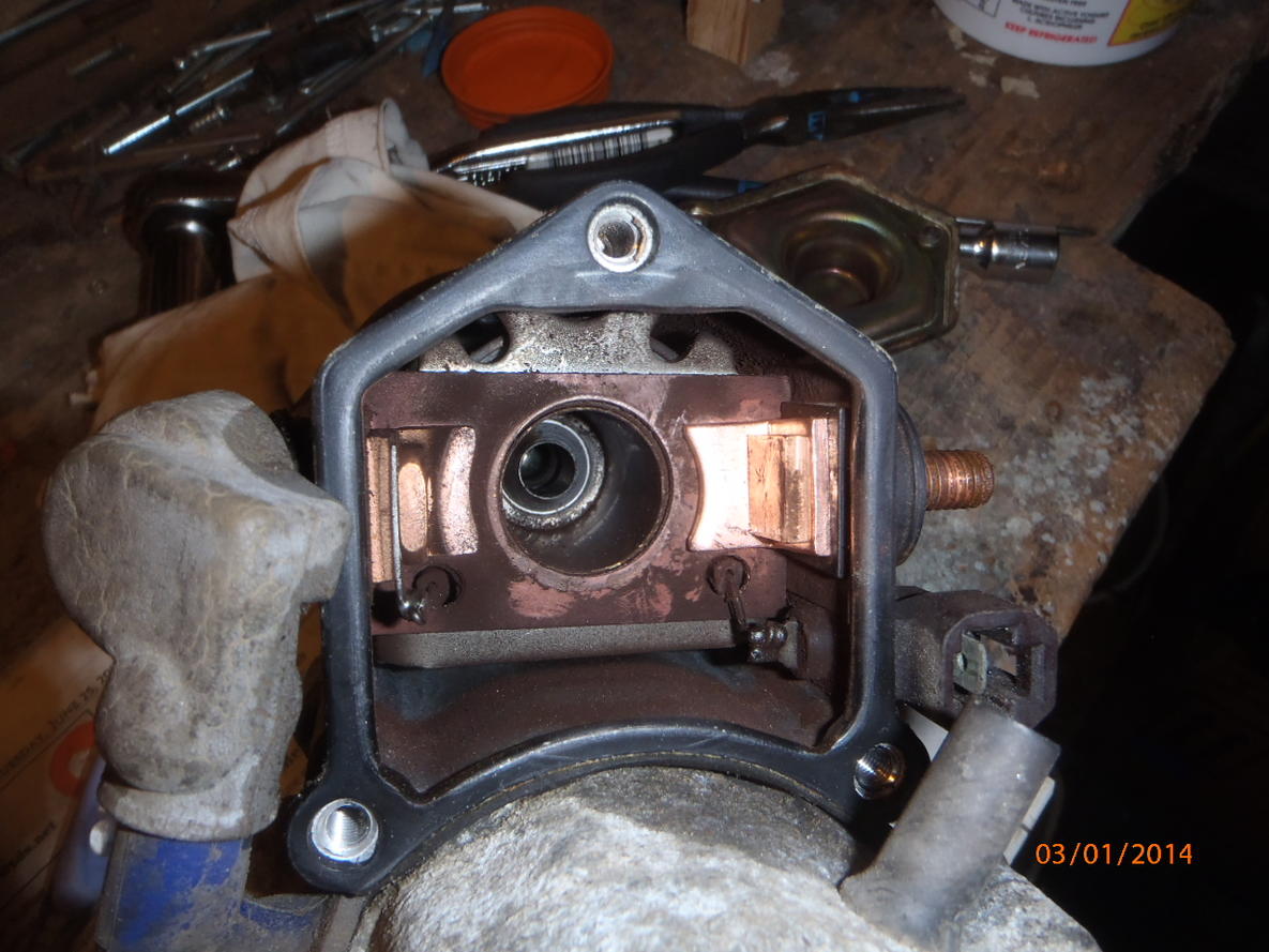

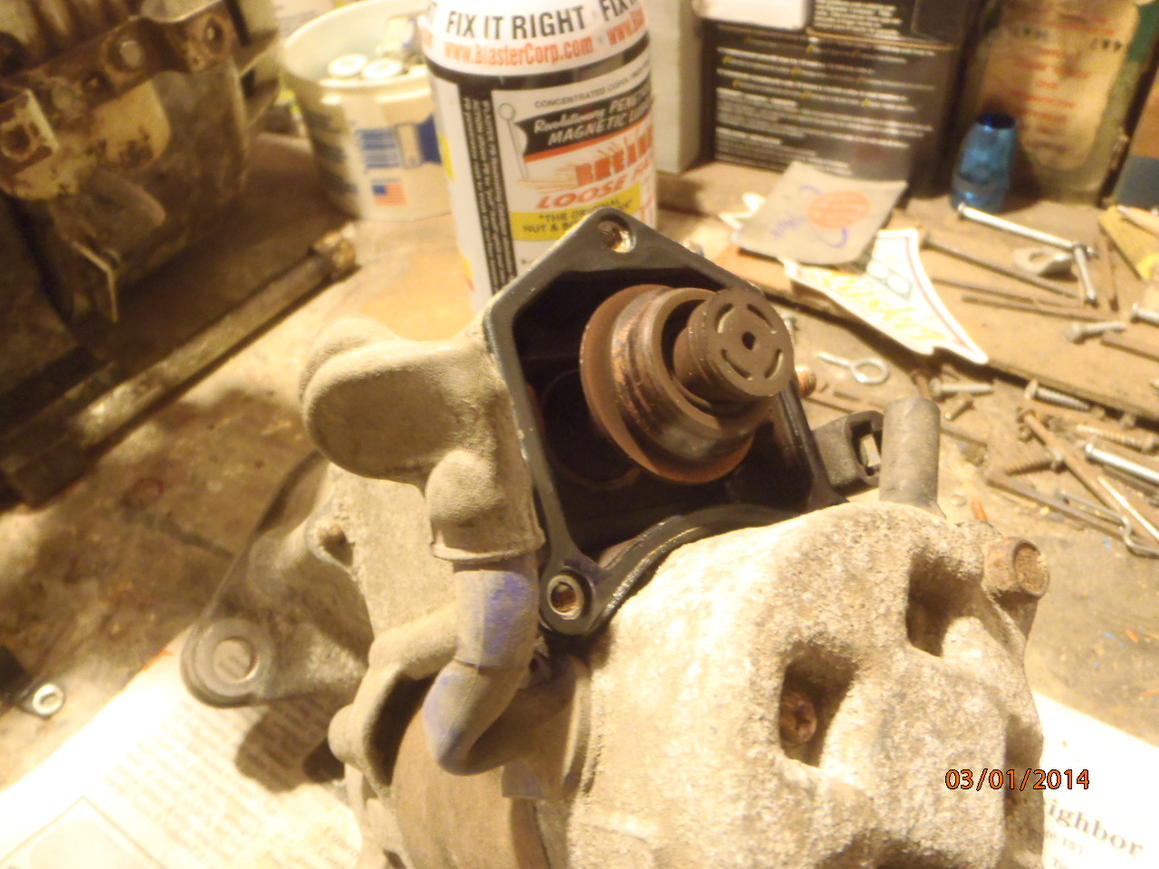

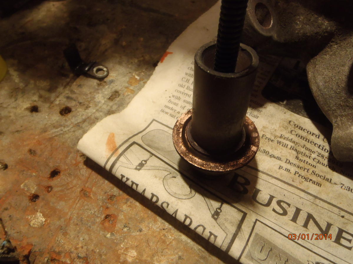

first pic shows the solenoid plunger, which is under the 3-bolt cover. also visible is the rubber gasket under the cover.
second pic shows the corroded contact surface of the plunger. it is only slightly worn, but pitted. third pic shows the plunger that came from the corolla next to the 4r plunger.
fourth pic shows the cleaned contact surface of the plunger. i used a small file to clean it up.
fifth pic shows the solenoid contacts still installed to the housing. the contact at the top of the picture is the worn out one (the contact area was paper thin), while the lower one has minimal wear, and i didn't replace it.

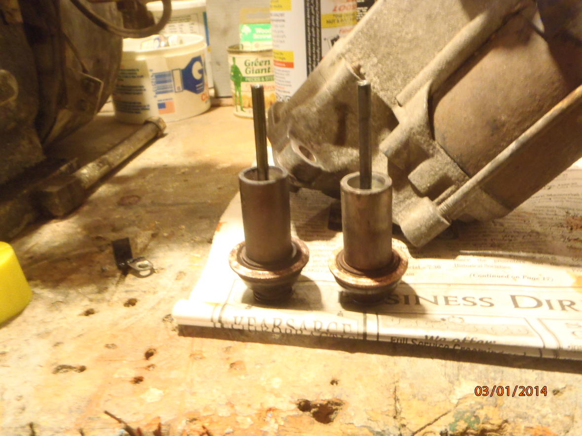

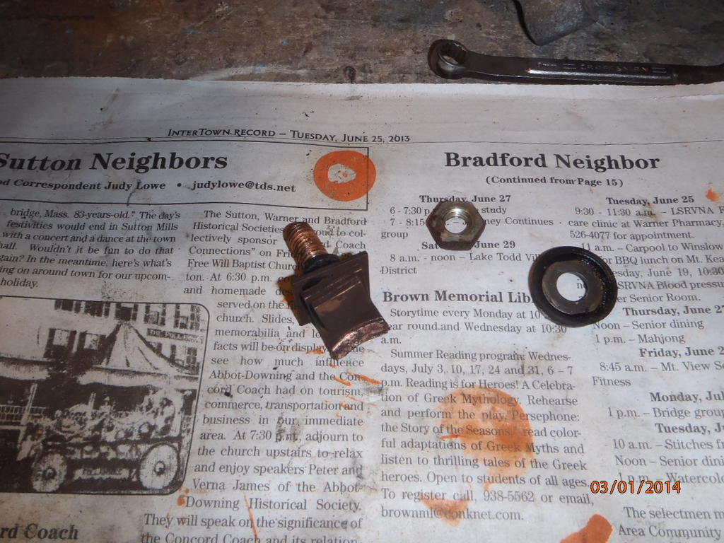

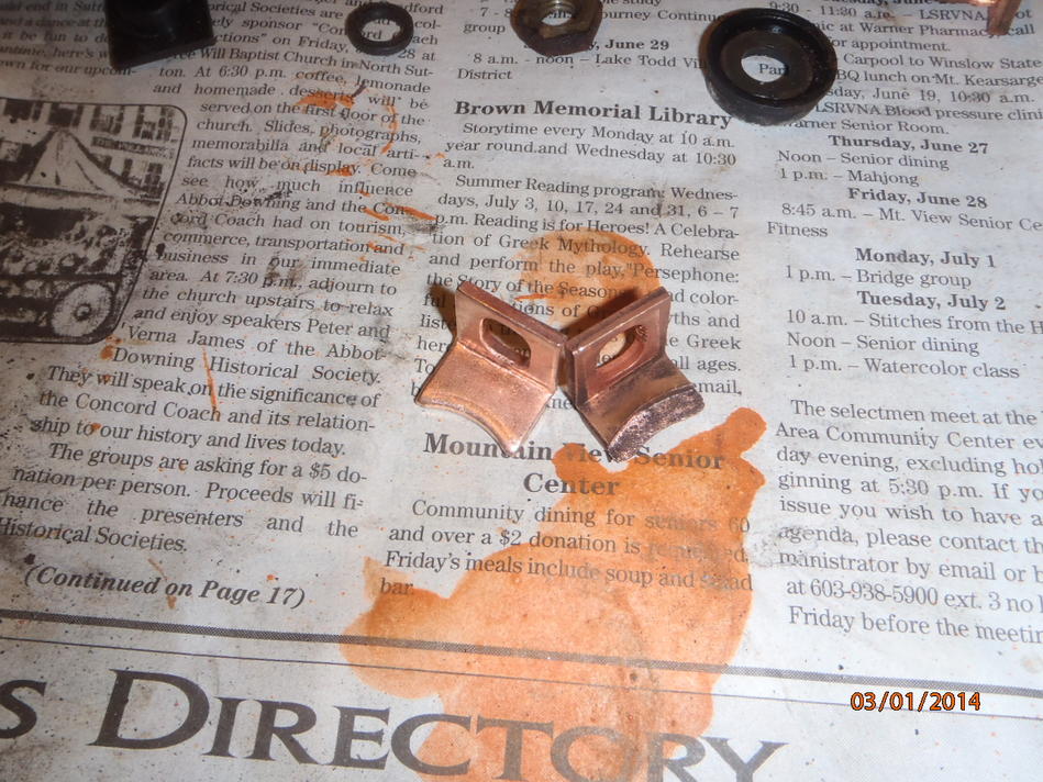

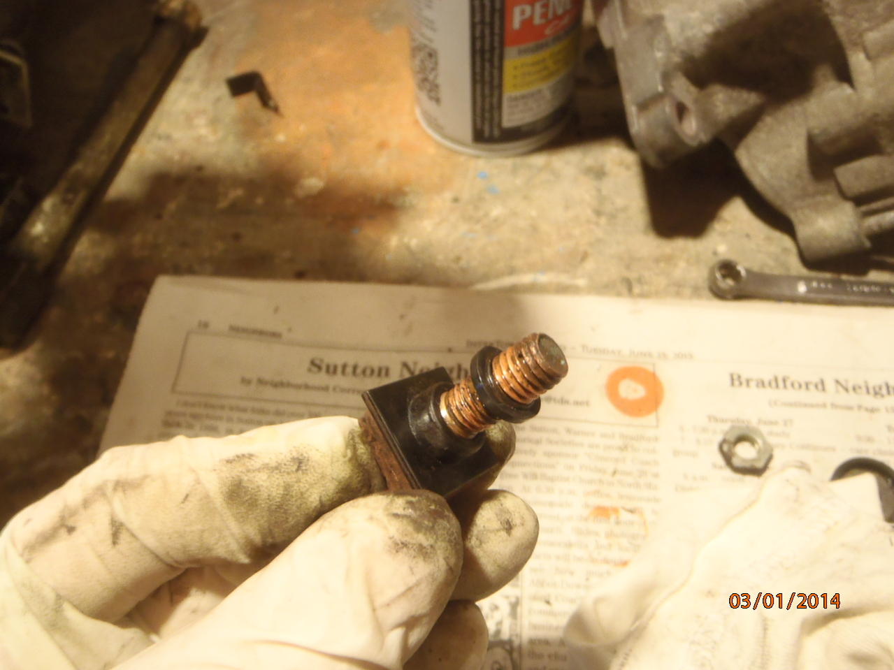

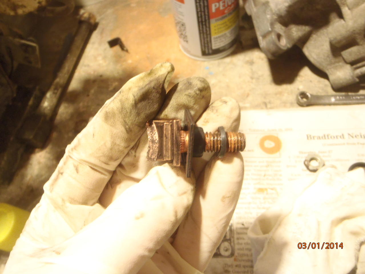

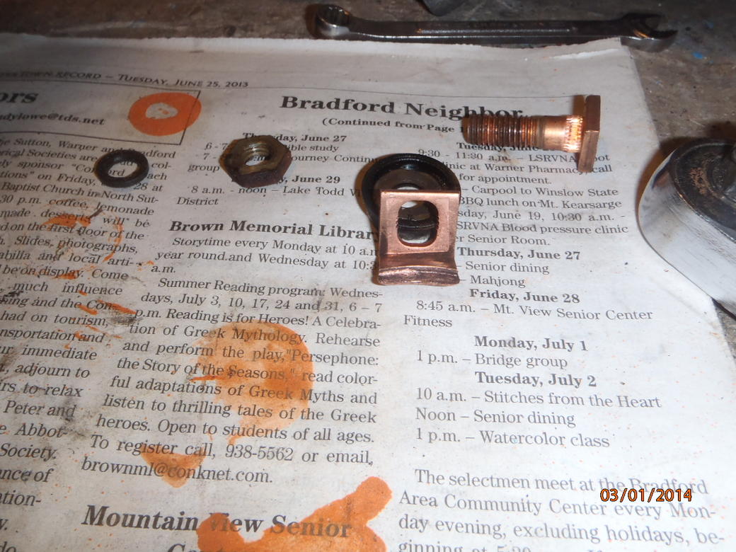

first pic shows the removed contact. this stud is the one that connects to the battery cable directly. the rubber gasket and washer attach to the outside of the housing.
second pic shows a small gasket that seals below the washer, along with a larger square insulator that isolates the contact from the housing.
third pic shows the stud/contact/insulator/gasket assembly, and the wear on the contact is clearly visible. this worn area really is paper thin.
fourth pic shows the area worn on the contact.
fifth pic shows the new contact next to the old contact.

inside the housing, with the new contact installed. shows the slightly worn contact that wasn't replaced, too.
second pic shows the cleaned/filed plunger being installed, and the last pic shows the starter reassembled on the bench.
took it out and put it back on the bellhousing. tested it, and it worked without a click/no-start. done. reinstalling it revealed another poorly designed toyota feature, namely that the clutch slave cylinder bracket is attached to the lower starter bolt. this makes it very difficult to get the bolt back in, since it is a "blind" operation. wtf attach that bracket to the starter attachment bolt?

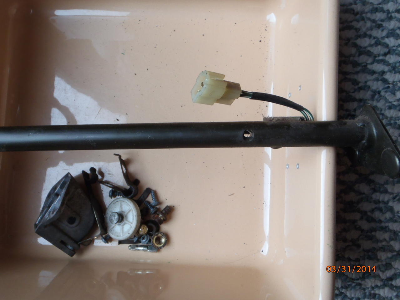

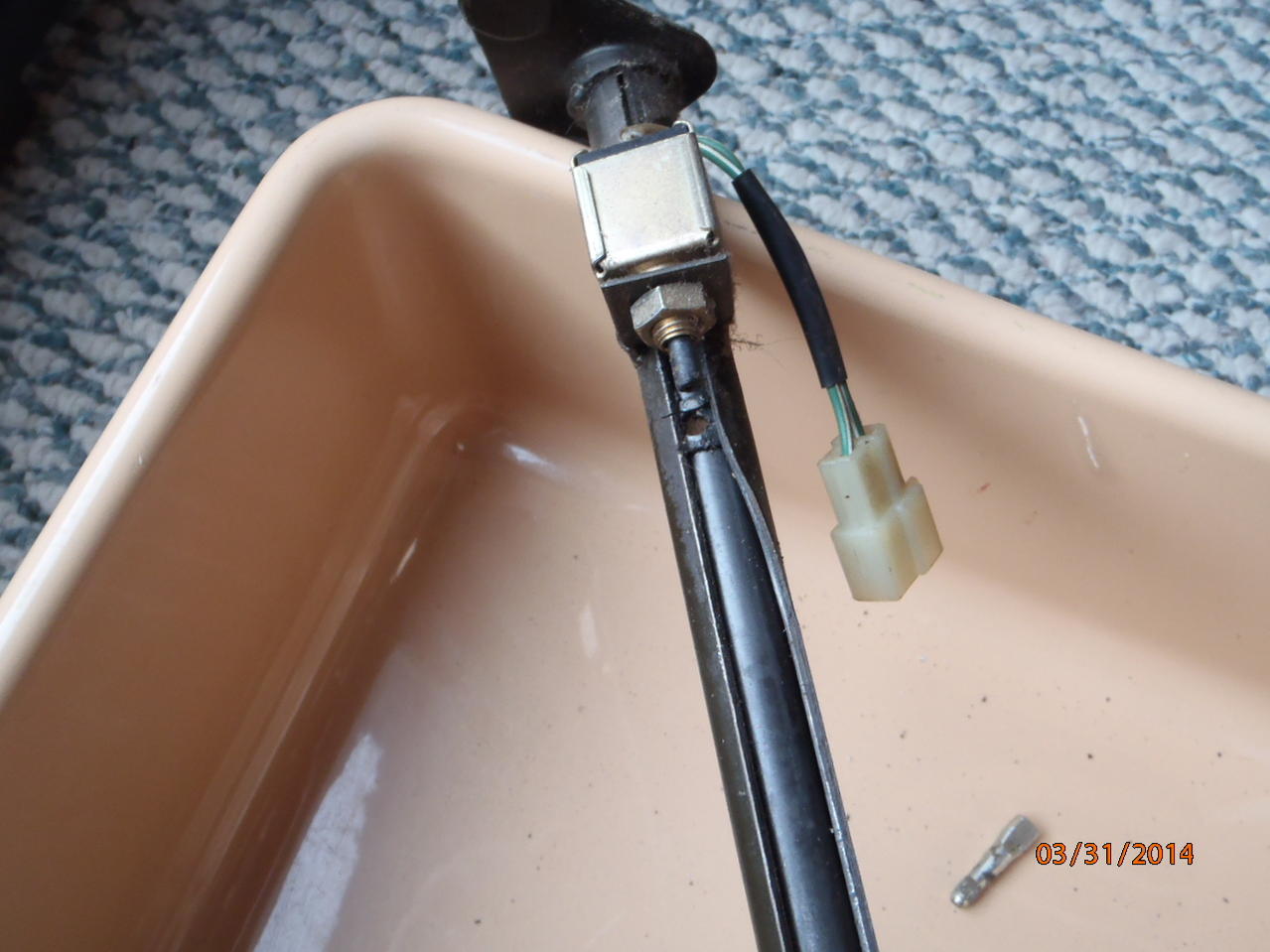

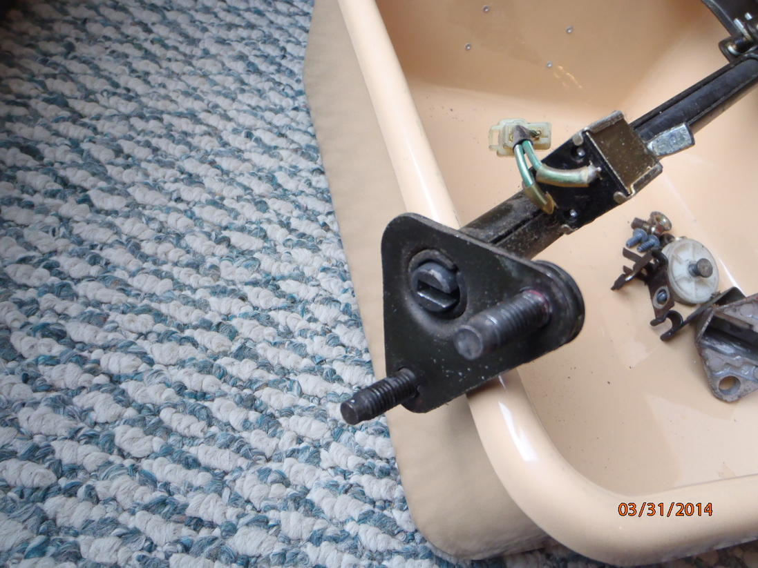

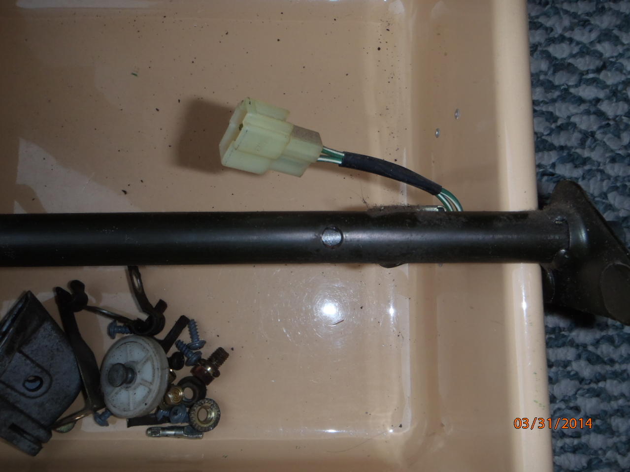

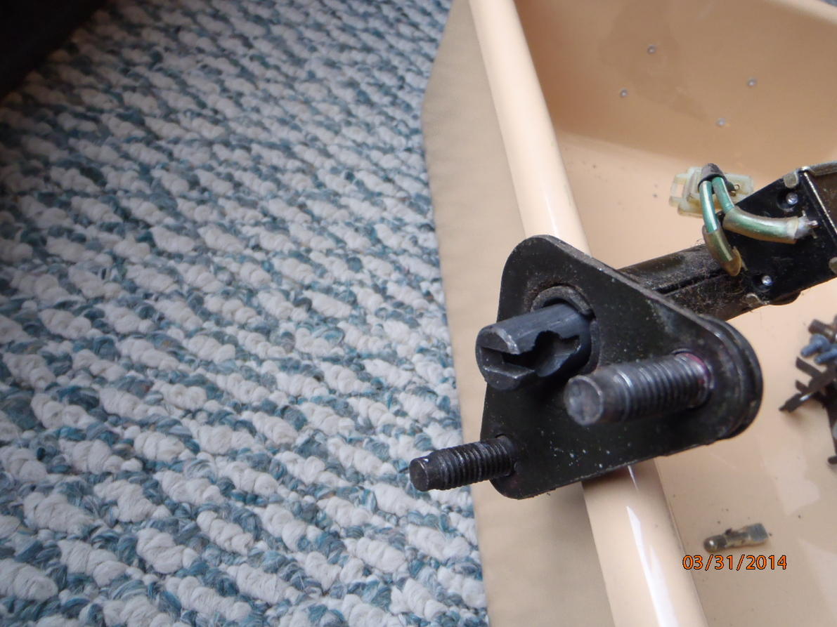

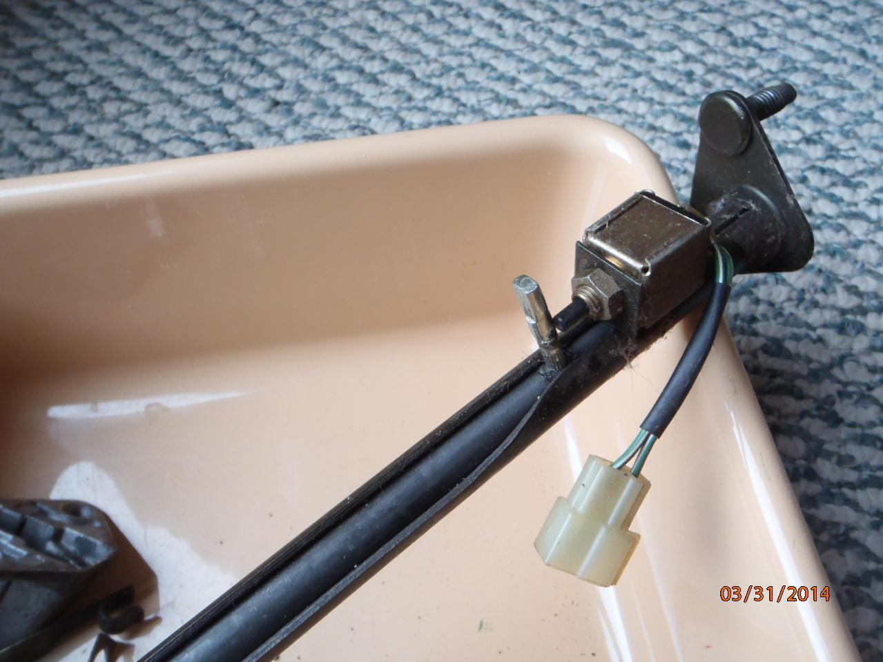

i broke the parking brake cable (the front cable) where it connects to the rear cable assembly, just in front of the gas tank. finally got around to removing it today.
the FSM is useless - no description of this process at all, and the design pretty much sucks.
after doing it the hard way, i've figured out the correct way to remove the front cable. it would have been very helpful if the FSM had this information in it.
here goes:
from the engine bay, pull the speedo cable from the clip that attaches to the pulley housing through which the parking brake cable passes. then, remove the two 12mm nuts to remove the pulley housing from the firewall (although the housing will still be "trapped" by the cable).
from inside, pull the parking brake lever slightly out, but not very much. this should expose the backside of a pin through a hole in the firewall-to-dash brake assembly (this is the pin that depresses/releases the "brake warning light switch") [first pic shows the pin, second pic shows the hole in the assembly]
the cable ferrule will not be able to be removed until the pin is removed so that the parking brake lever can be pushed fully inward [third pic]
drive the pin out the opposite side (drive it from the hole, not out the hole).
[fourth & fifth pics]
once the pin is out, fully push in the parking brake lever. this will extend the assembly into the engine compartment enough to allow the cable to be removed from its "slot". without removing the pin, the assembly can not be pushed far enough out through the firewall in the engine bay to get the cable out of its slot, and nothing else will work. [last pic shows fully extended lever through firewall, with ferrule capture exposed.
from here, the rest is easy. gently pry away the retaining tabs that secure both the parking and speedo cables to the underside of the body (one is located above the transmission, near the back of the engine, the other is located just in front of the crossmember through which the parking cable is clipped. there is also a cable clamp that attaches to the parking cable, and it is secured directly to the body with a 12mm bolt.
remove the other clip from the pulley housing, then pull the small cotter pin from the rear of the cable, and the entire parking brake cable should be removeable at this time.
from the pics, you can see that i removed the p-brake assembly from under the dash. that isn't necessary, as the pin can be driven, with difficulty, with the lever installed. you still have to remove the pulley housing from the engine bay side of the firewall, but you do not have to pull apart the lower dash covers and remove the lever. driving the pin from under the dash will be difficult, as there isn't much space to work in, and the hole to drive the pin out faces the middle dash/heater/etc. all in all, this is a piss-poor design and is totally unnecessary.
another edit: you can also see the various parts associated with this in the bin, including the pulley and pulley housing, and the speedo cable clip that attaches to the pulley housing.

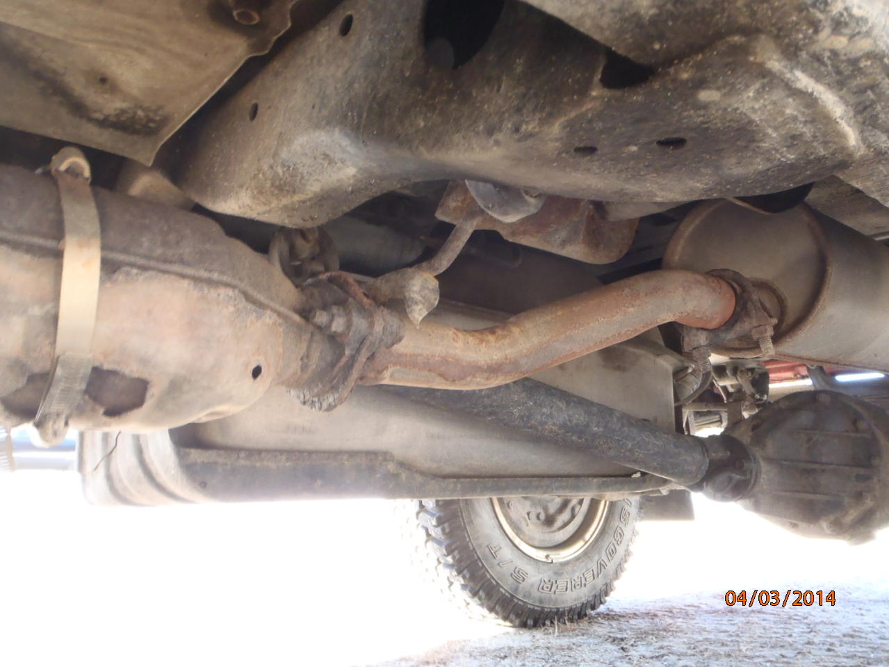

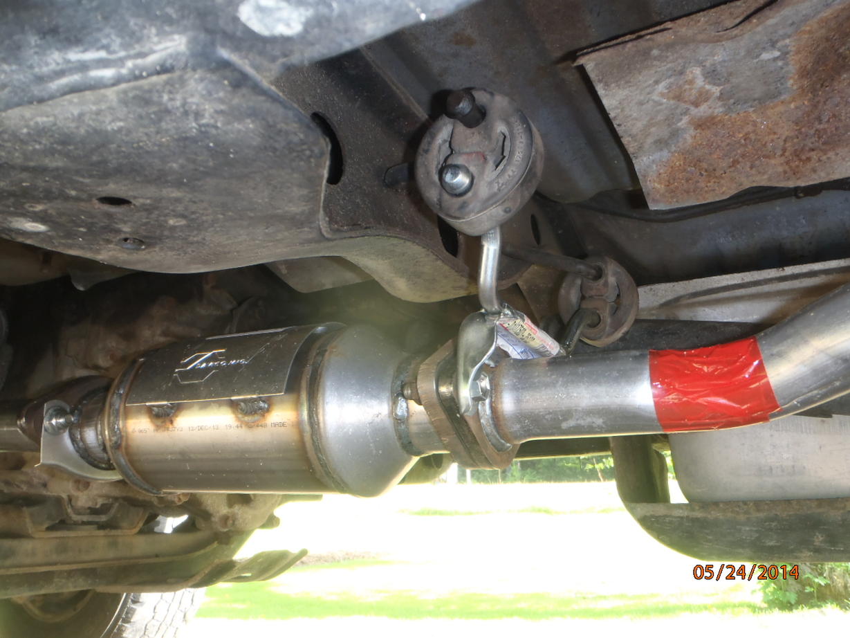

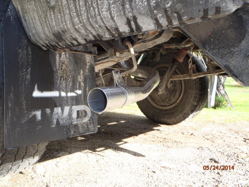

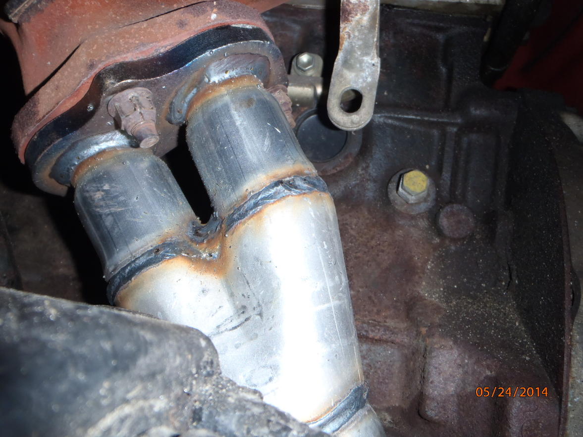

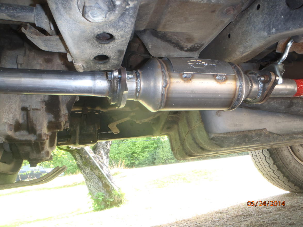

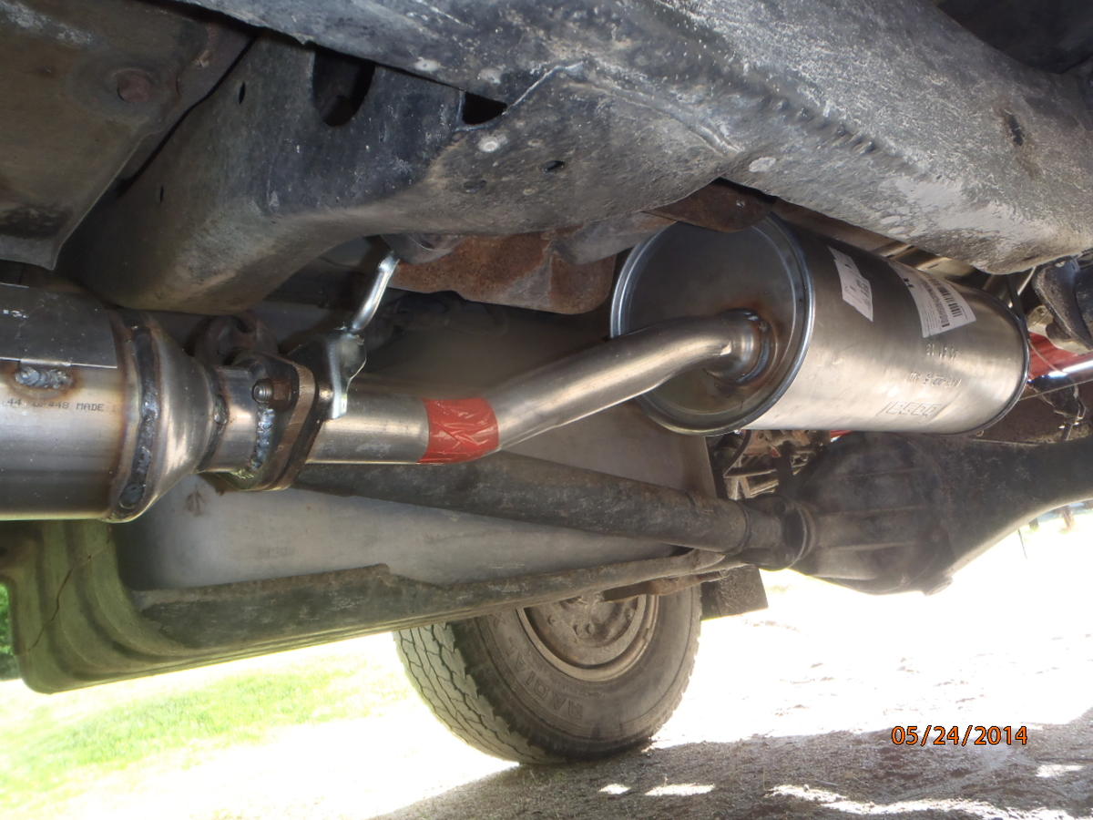

the 4runner had an exhaust leak at both flanges of the catalytic converter. the flanges on the head pipe and intermediate pipe weren't great, and the cat was in poor condition. i ended up purchasing an entire new exhaust system, in stock form, from mostly rock auto, but also toyota overstocks. so, brand new front (head) pipe, new cat, and new muffler/tailpipe assembly (i went with a single-piece unit, rather than getting a new intermediate pipe, muffler, and tailpipe), new cat hanger (that was hard to find), new tailpipe hanger, and new gaskets (both for the cat and for the head pipe at the manifold).
the entire project took only 4 hours, which include removal of the old system, and installation of the new one. i used a grinder to sever the pipe between the cat and muffler, which made getting everything out much easier.
the nice thing about the stock pieces was that everything fit just right. i didn't have to do any bending, stretching, cutting, etc.
and now i've got a leak-free exhaust that is quiet.
edit: added photos - old cat, new cat

^^^^I need to do that too. What cat did you get and how much did it cost? Were the exhaust parts Borla or Walker? Nice 4Runner BTW. It's in excellent shape for California much less NH.
parts from rock auto:
bosal 885867 front pipe $71.79
davico 16075 cat $84.79
walker 35199 hanger/insulator $5.70
bosal 284873 muffler combination $90.79
bosal 256061 pipe flange gasket/seal $2.82 (2)
bosal 255031 hanger/insulator $3.14
parts from toyota overstock (oem)
17503-35130 bracket sub-assembly $25.62
18495-35011 retainer $11.64
90105-10388 bolts/washer base $1.04 (4)
that's it. total $303.27 plus shipping (about $110.00) less than the going rate for a catalytic converter. you can eliminate the 18495-35011 retainer, don't need it, though i used it (instead of nuts). i also used nuts from my "parts jar" to bolt the cat in using the bolts/washer base, and to attach the front (bellhousing) hanger and tailpipe hanger.

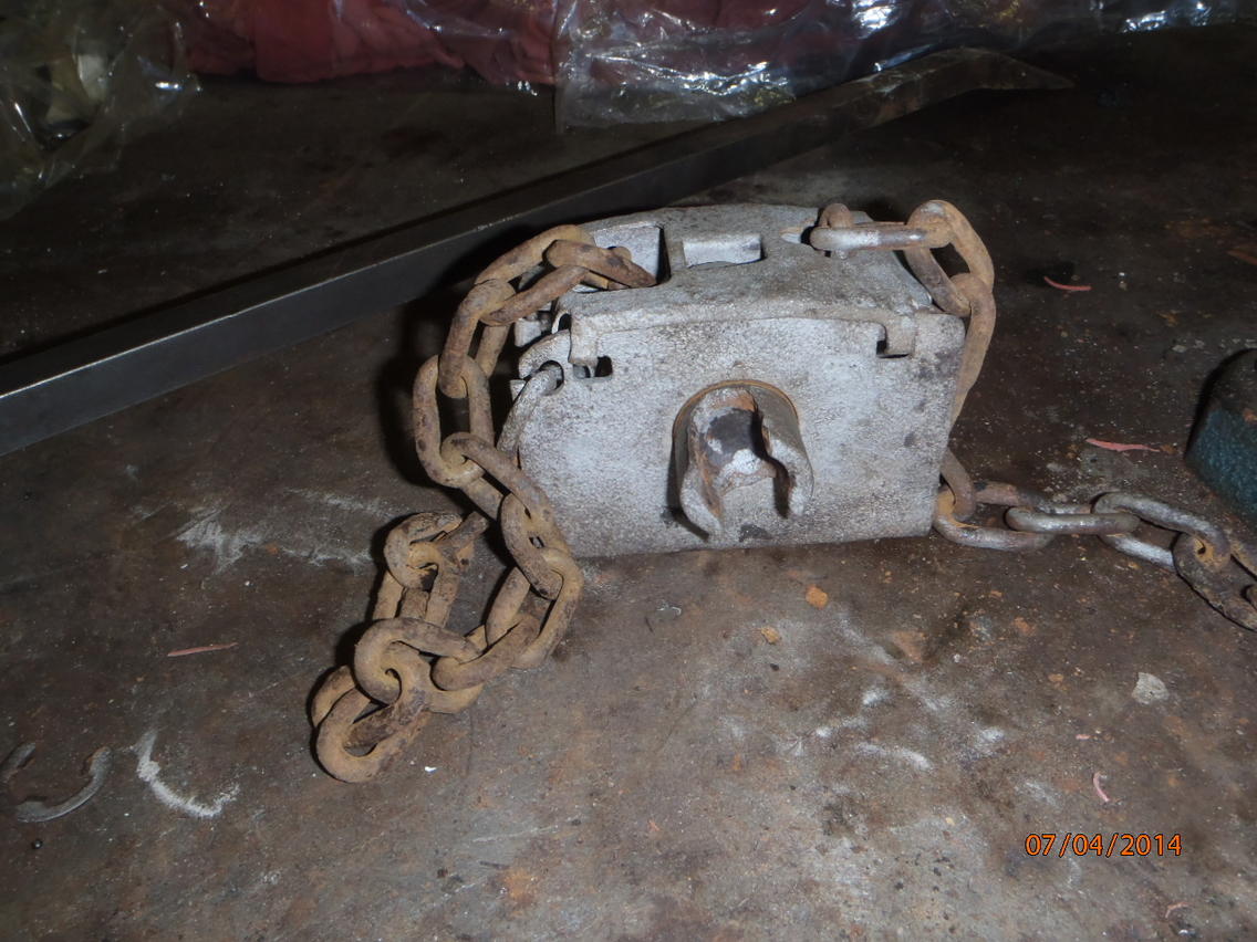

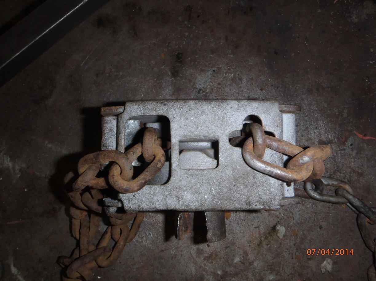

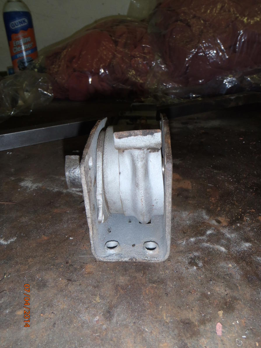

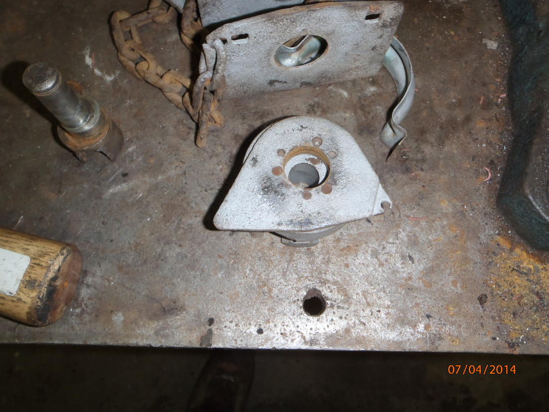

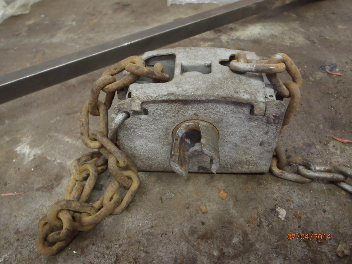

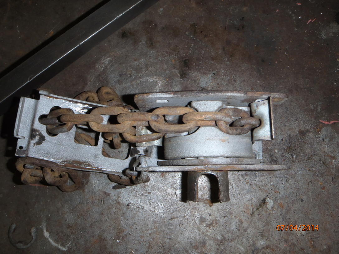

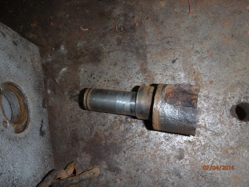

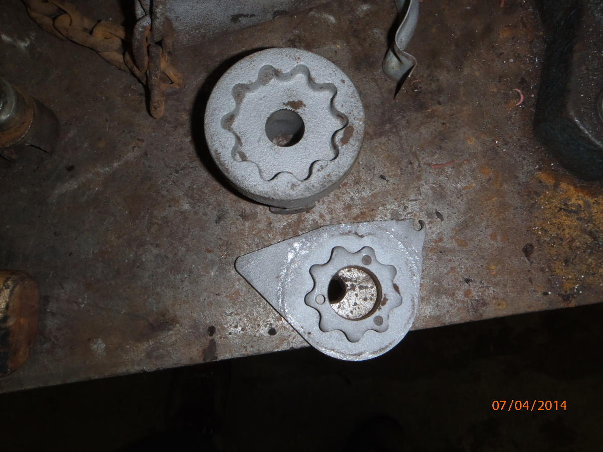

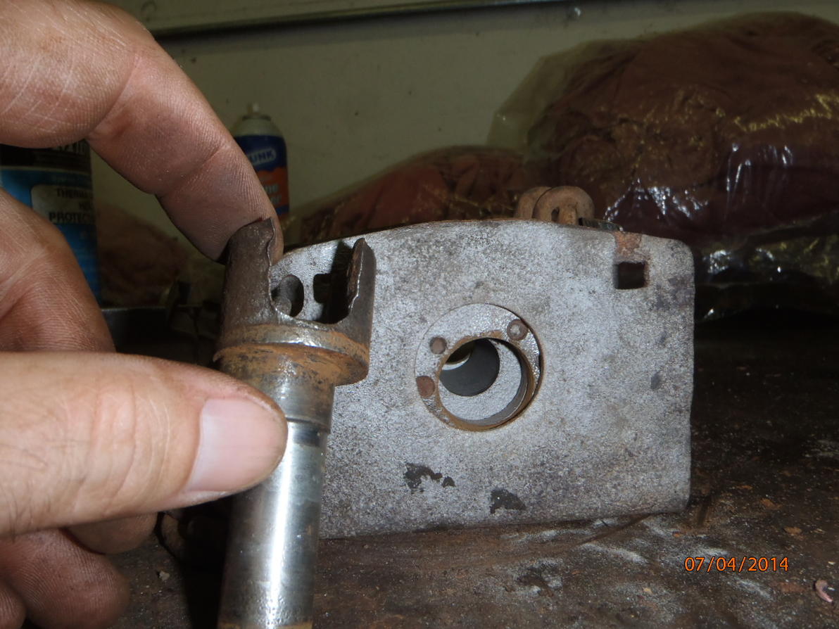

another project that i did a few months ago, and forgot about until a current thread was posted. the spare tire hanger/lowering mechanism didn't function. so, i removed it to try to get it operational. there are three bolts that attach the body of the hanger to the "spare tire frame sub-structure". these may or may not be heavily rusted. i was able to remove all three without breaking them, using torches and lube.
the inside of the hanger was full of dirt, rust, and crud. the moving pieces were solidly fused together. i disassembled the entire mechanism, and sandblasted everthing. to get it apart, gently pry the tabs open on the cover (the piece with the cross through which the chain passes) and lift off. pry off the c-clip at the opposited side of the slotted pin, and the rest of the "innards" should be free to come out.
the mechanism is pretty basic, and actually fairly stout. it fails because dirt, roadwash, salt, and rust can freeze the parts together. with regular lubing, from a clean start, it should probably work for quite a long time.
