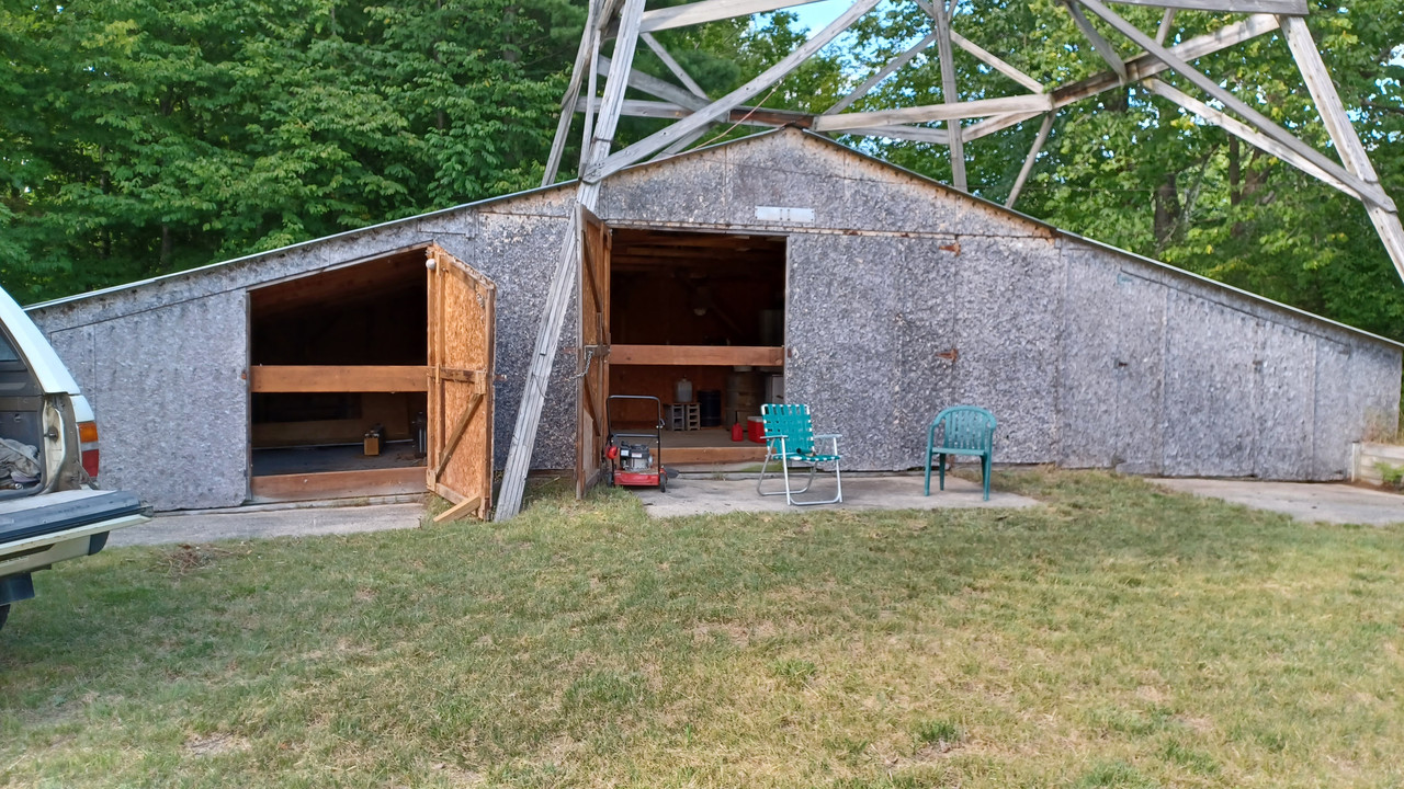

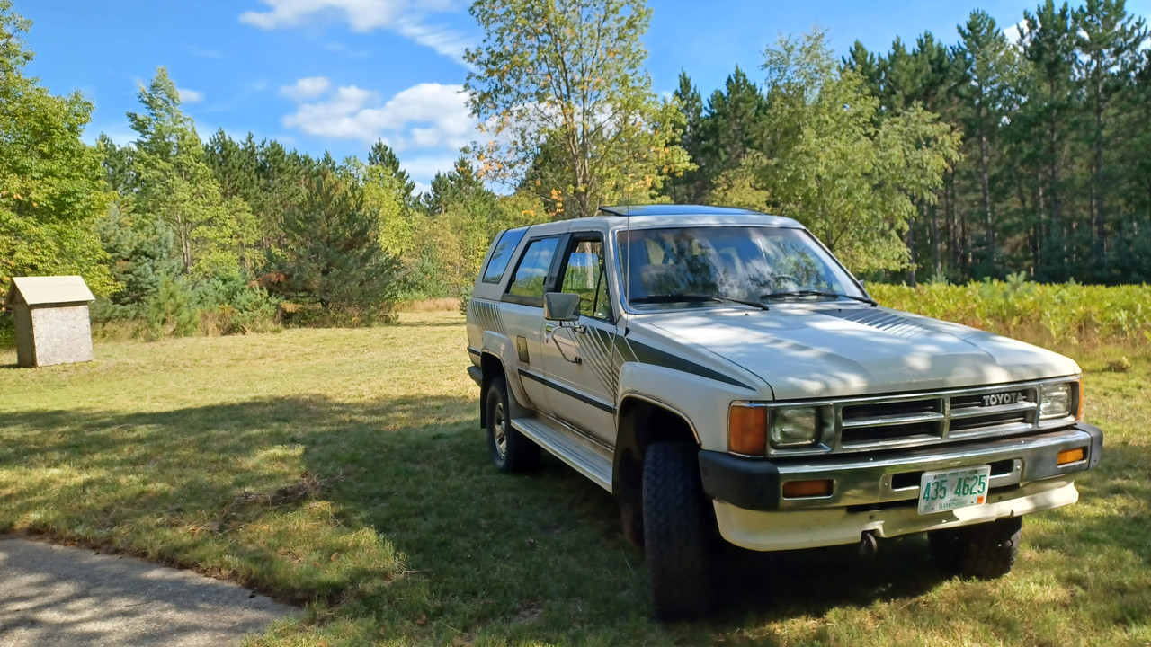

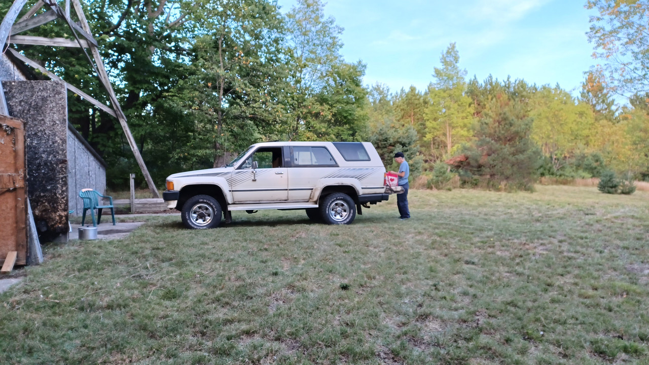

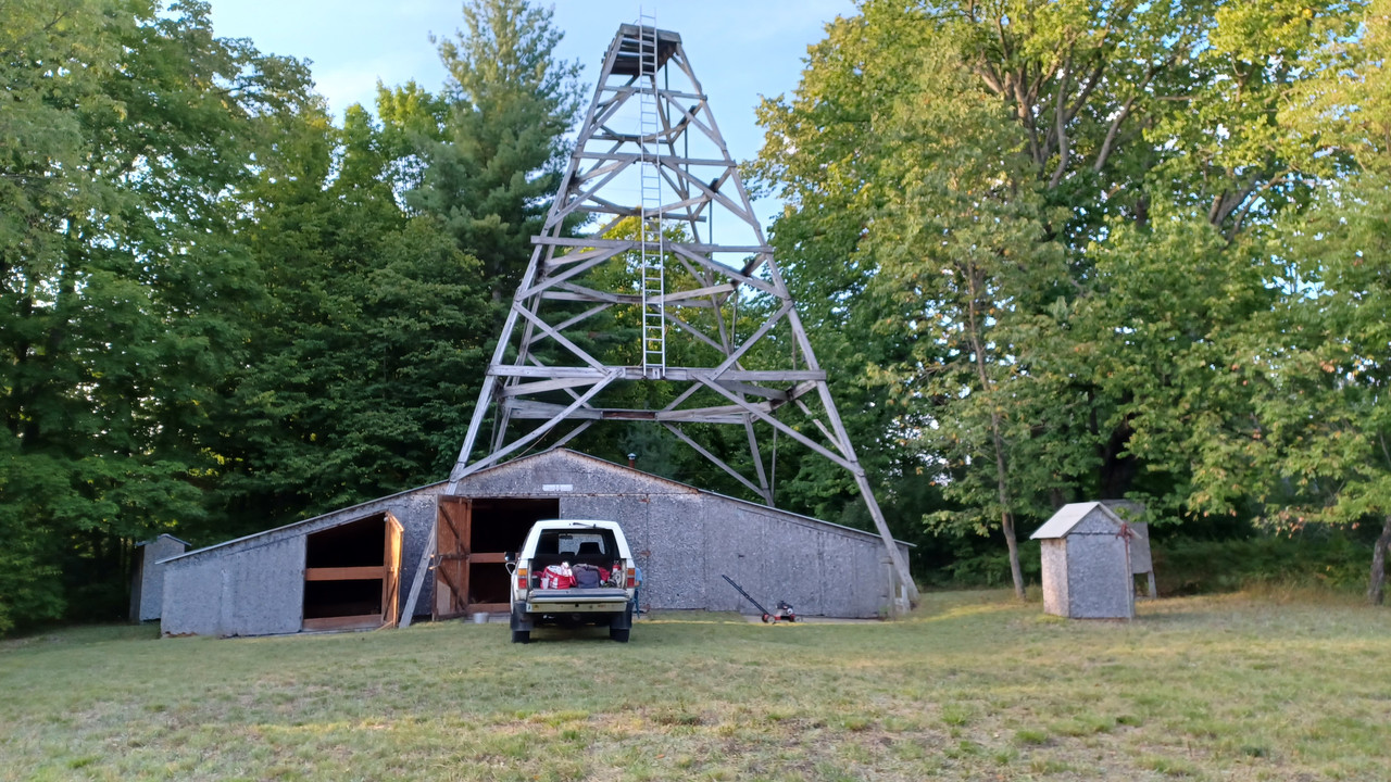

took #2 again on a round trip from NH to MI. visited the inlaws in southern MI, and then went to north central MI to the camp.
drove great, mostly kept it to 65 or less, even in northern MI where the limit is 75.
2,040 miles, left last thursday, got home today (6 days). averaged a tic over 23 mpg.
overnight accomodations
coffee water heating up
