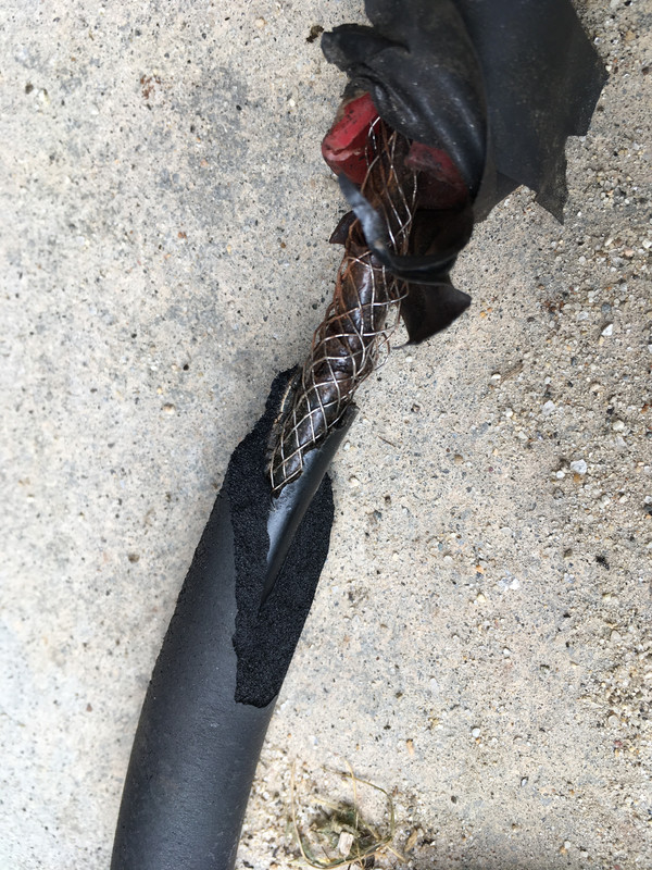

driving on the interstate a few days ago, the speedometer quit, along with the odometer. the cable broke, which was not a surprise; the surprise was how long it lasted.
when i bought it [the 4runner] in october of 2018, the cable had a sharp kink just after it exits the firewall. i was amazed it even worked, let alone kept working for almost three more years.
this is the bend angle:
close-up of the condition it was in for the whole time:
pulled a bit of the insulation away to show more of the break:
but, since i was near the dealership where i usually buy parts, i stopped in and ordered one. got it the next day:
installed it yesterday - speedo & odo back working again.
That's quite the kink! Did your speedo have any issues prior to it breaking? Mine bounces around a lot, I'm guessing that's just the way it is though..
it had a minor bounce, quite rhythmic, almost a clicking. but it basically held steady by what we can perceive (there was movement, but not noticeable while driving).

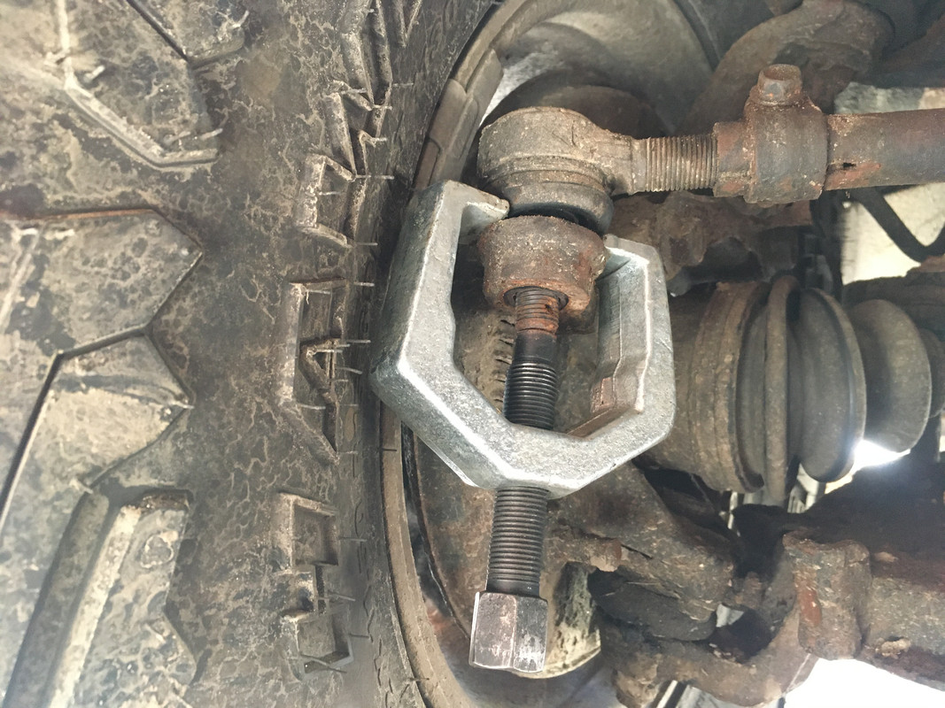

when swapping on the 32x11.5 wheels/tires, noticed that the passenger side outer tie rod end was loose (failing, the nut was still tight). ordered a replacement, and installed it the other day. having the pitman arm/tie rod puller makes it a breeze.
took care of the slight wobble, which wasn't noticeable when driving, but could be felt and seen when gripping the tire with it raised with a floor jack.

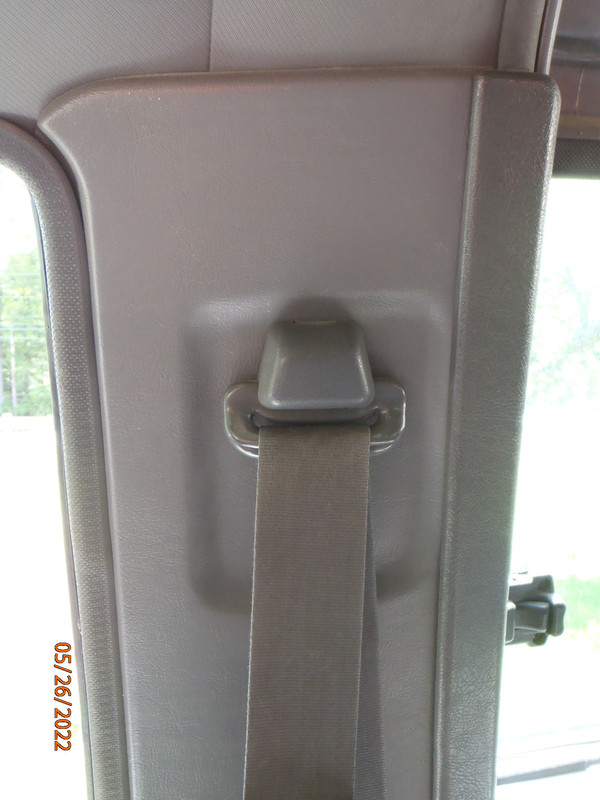

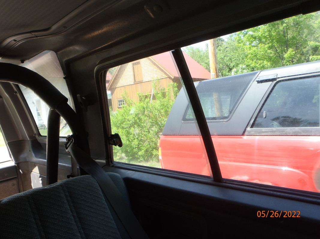

#2 was a NC vehicle up until i bought it in 2018. as such, some of the interior plastic trim was a bit brittle, but complete. the panels on the B-pillar were a good example - not bad, but some minor cracks and tiny pieces broken off.
i removed them a few days ago.
note the upper corners
to replace them, i used the better panels from my '88 parts runner. no breaks or cracks, and nice flush/tight fit.
driver side
passenger side
