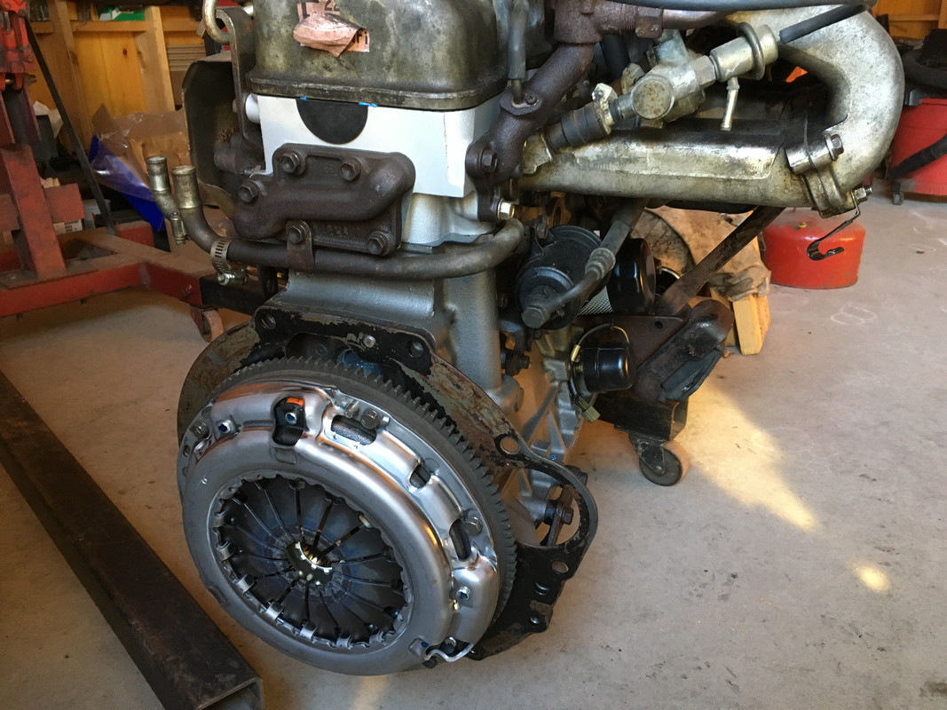

new exhaust manifold studs from yotashop

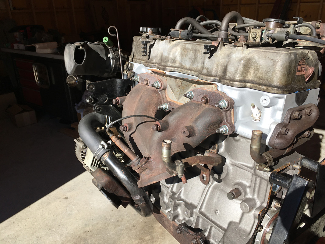

off the stand and onto the hoist to install the flywheel and clutch

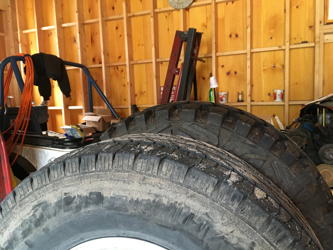

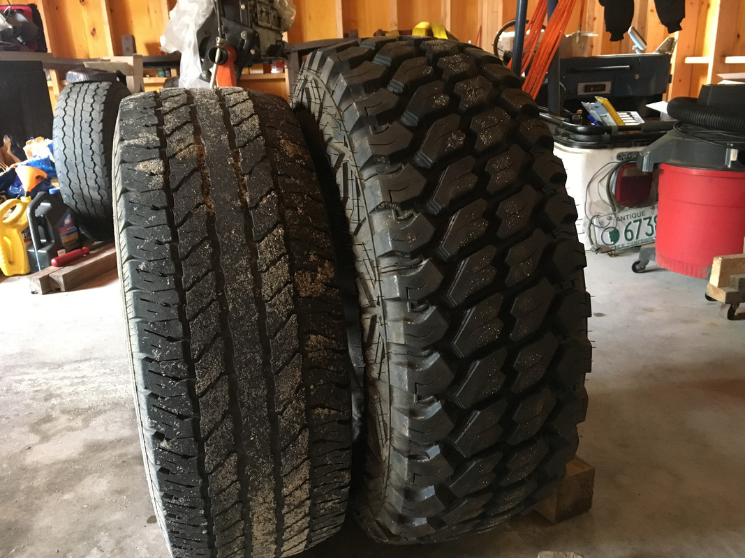

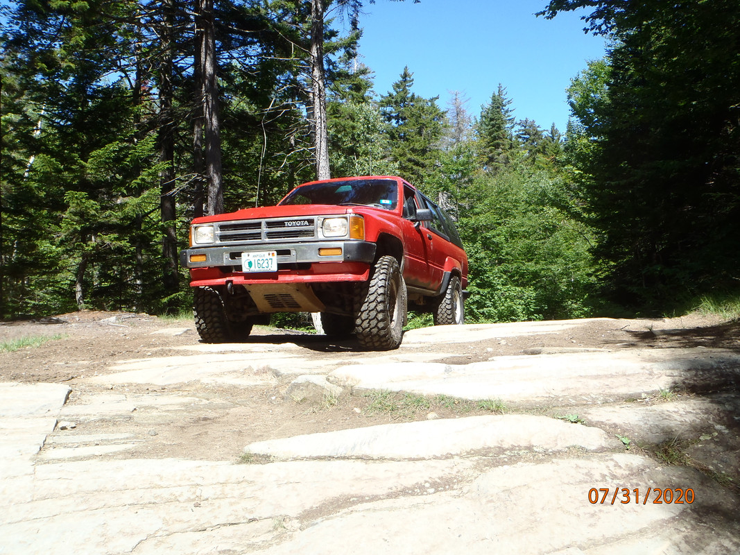

the 31x10.5x15 cooper discoverers that i bought 7 years ago are about worn out, but i’ve been running them this summer to get a bit more miles out of them. decided to swap on the 32x11.5x15 achilles desert hawks/aurora at02 set. the coopers are mounted on american racing outlaw wheels, and the hawks/at02s are mounted on offset 8 toyota alloys.
the outlaw wheels are wider, which makes for a smaller overall diameter than if mounted on a narrow rim, but this makes a nice comparison of admittedly worn 31x10.5x15 vs new 32x11.5x15 tires.
how the 32s look on the 4runner

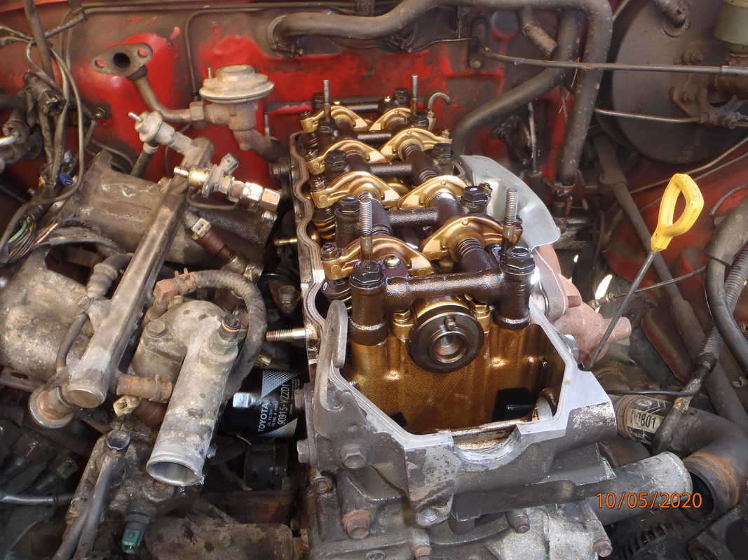

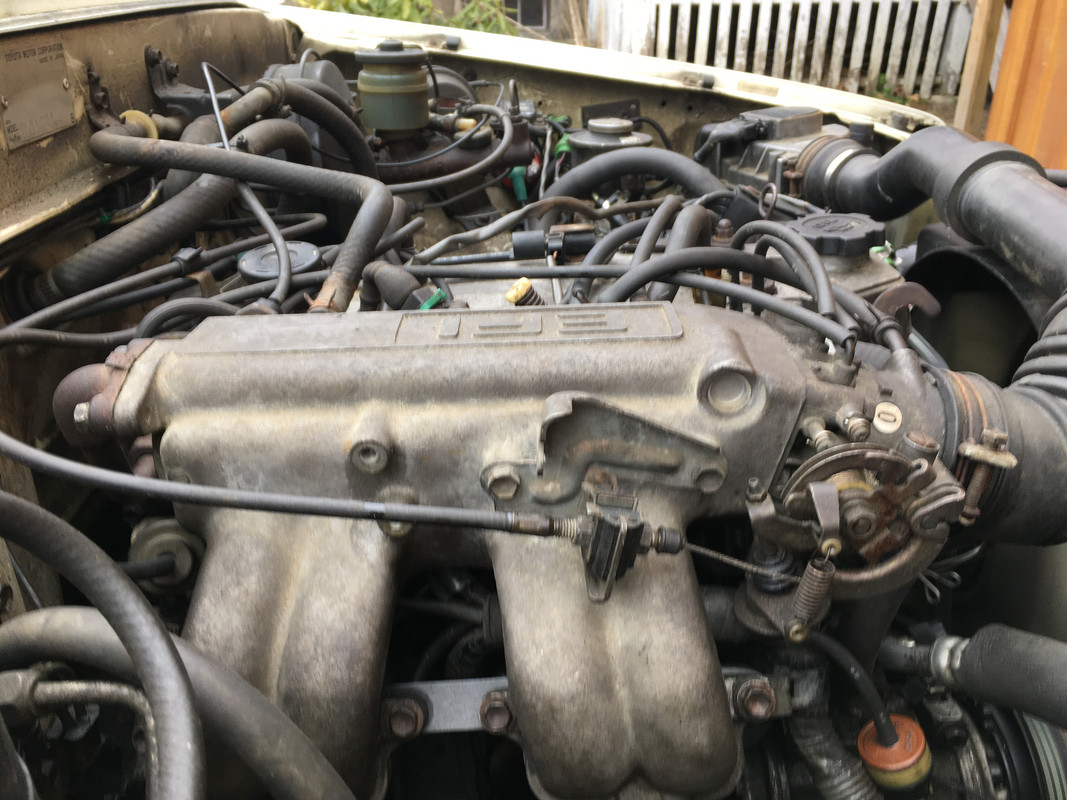

most excellent! headgasket in red '87 is leaking. however, it is an external leak, instead of an internal leak. either way, time to replace it. ordered a bunch of geniune parts from McGeorge Toyota to the tune of about $117.xx delivered. now to take things apart to remove the leaking HG. yay.
Have you started the disassembly yet? Any photos?
oh, yeah. i’ve started. and finished. no photos, since i’m terrible about taking them in the middle of projects,
i ended up doing the timing chain, too. the drivers guide had a small piece missing around the upper bolt, so i just replaced everything (i had a complete internal timing kit on hand anyway). new guides, tensioner, cam sprocket, crank sprocket, and gaskets, along with a toyota head gasket and intake gasket.
head gasket looked to be original. not bad, 34 years and a tic under 200k miles (196k).

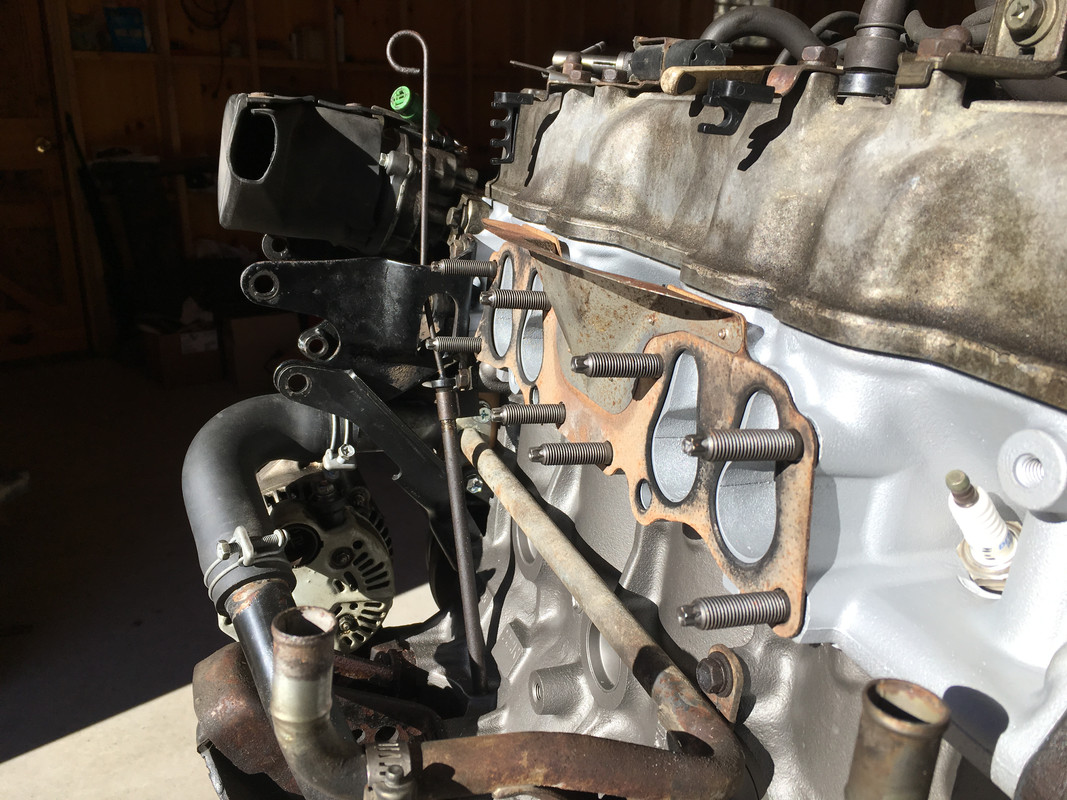

well, now i have some photos. got to do it all over again, as the timing chain broke after about 2 weeks (my fault - i didn't torque the guide bolts, and they were all loose. one backed out and dropped down between the chain and the crank sprocket, which broke the chain). so, replaced the timing set with another OSK set from yotashop, and another head gasket from mcgeorge toyota.
the good news? the whole process went faster, because i had just done it two weeks prior, and thus knew exactly what to remove, and what only needed to be loosened, etc, ie, i didn't remove the fuel damper, because i could set the lower plenum assembly to the side enough to clear the head and intake studs.
i made damn sure to torque all of the guide bolts this time. and, like last time, once everything was reassembled, it started instantly. no leaks, timing was perfect.

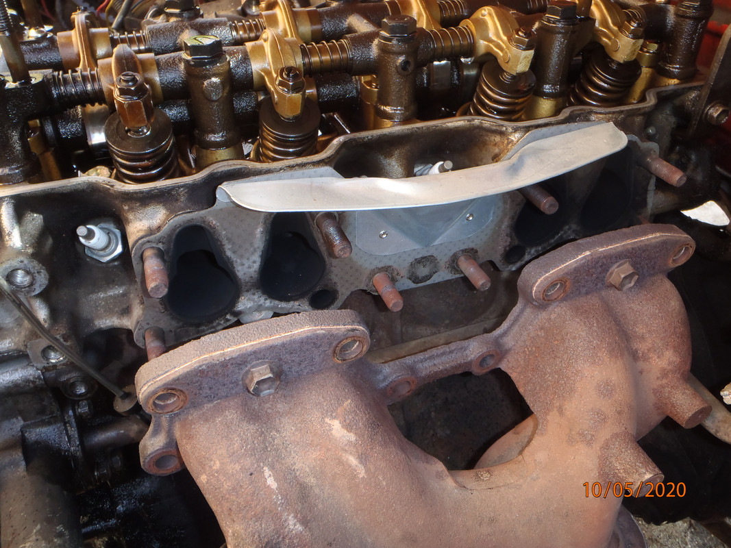

cover removed, along with distributor, cam gear, and timing sprocket (and broken chain)

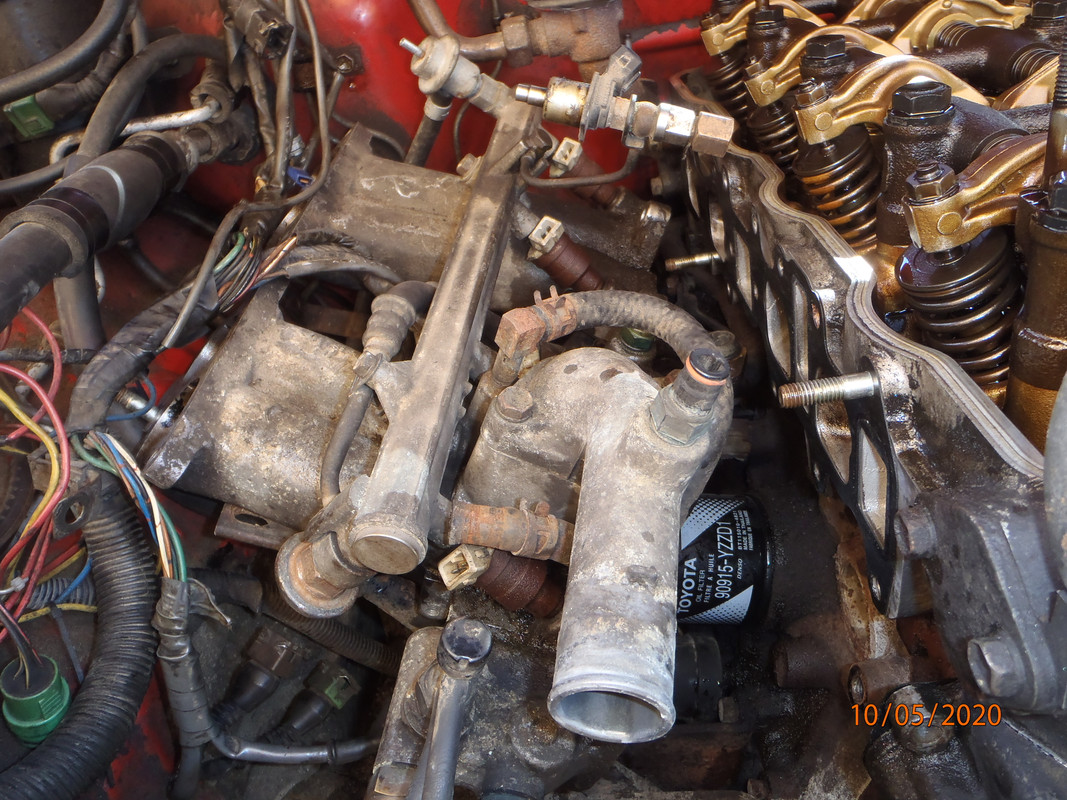

lower plenum disconnected and set aside enough to clear the head
exhaust manifold disconnected only at head

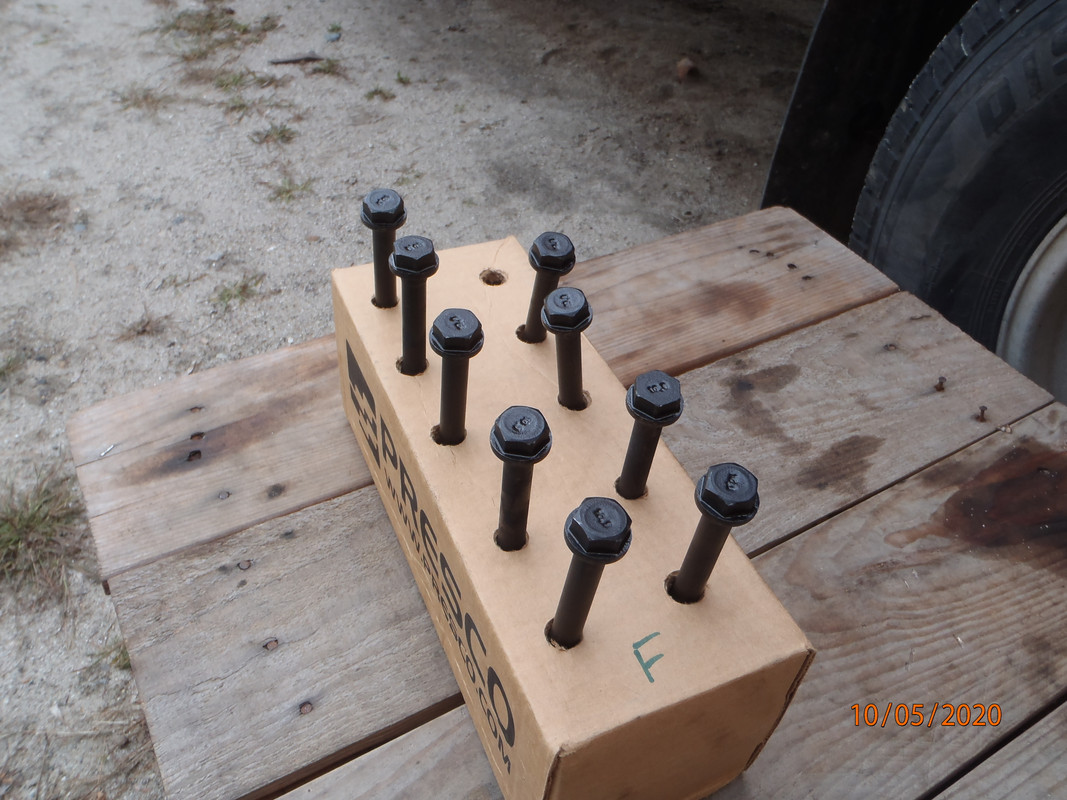

head and timing cover removed
head bolts

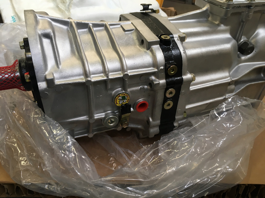

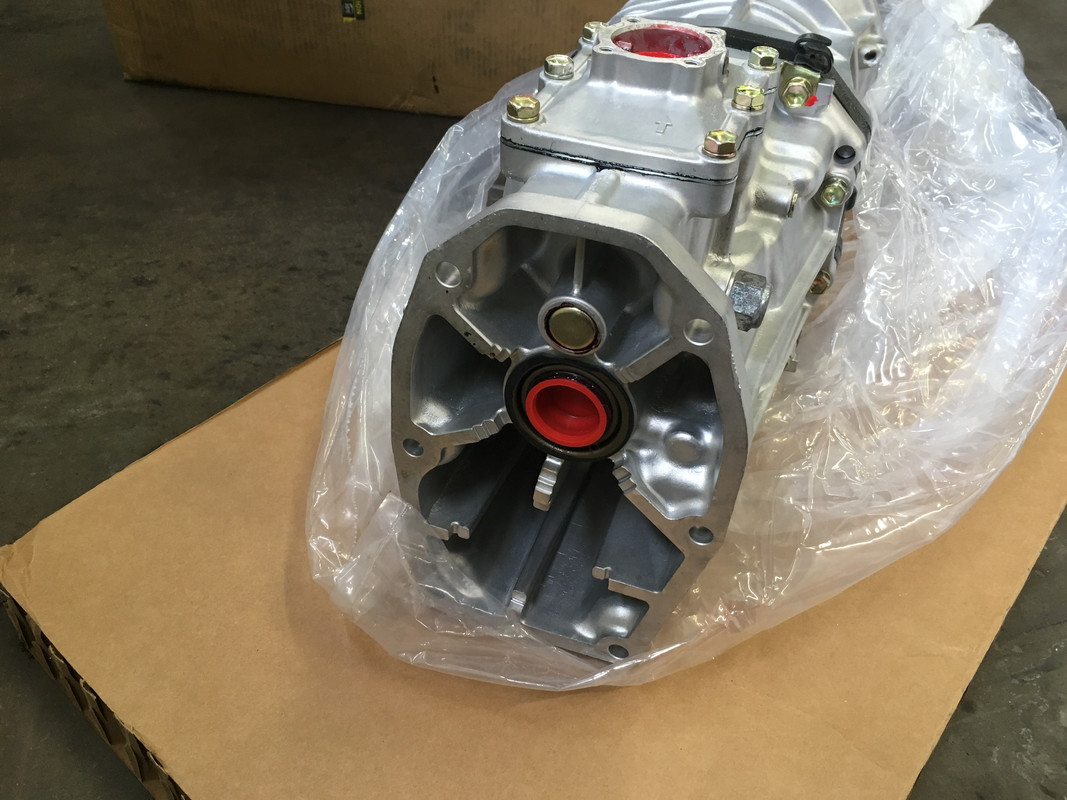

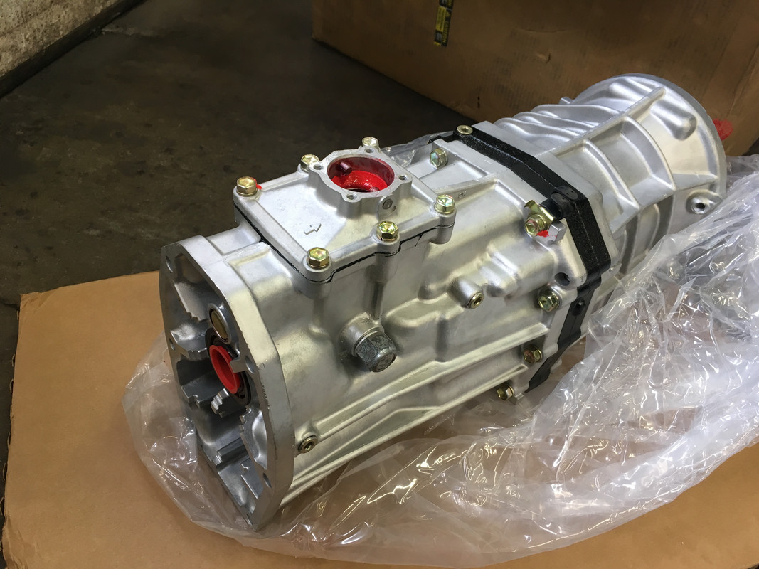

bought a marlin crawler w56b 5-speed back in may 2020 to replace the original in my 2nd '87 4runner. finally got around to installing it yesterday!
the install went very well, and the fact that the 4r came from north carolina didn't hurt, as the bolts etc came loose without breaking stuff. while in there, replaced the rear main seal and used a sleeve (i did use a new seal when i installed the rebuilt engine, but the seal still leaked).
minor grrrr, the marlin crawler transmission was supposed to come with a gasket for the transmission/transfer case interface, but when i unpacked the transmission, no gasket. other than that, it looks excellent, and the test drive confirms - no more "rocks in the transmission", and no longer hit the transfer case lever when shifting into reverse. very happy so far.
