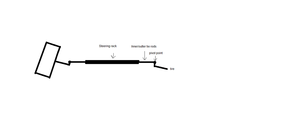

So the truth about wheel spacers . . . wheel spacers are going to make your front end feel even more sloppy. I posted this picture a while back to illustrate this in a different thread where wheel spacers came up. Your wheels swivel at a pivot point, and when you add a spacer you increase the distance between the wheel and pivot point. That creates more leverage for swiveling the tires. Its like adding a cheater bar to create more leverage when trying to remove a bolt (granted on a very minor level). But with the influence of 5000lbs pushing the tires, that small spacer will make a noticable difference. I added 1.5 spacers to my stock wheels several months ago, and the front end wandered like crazy.
Maybe the extra leverage/stress just makes apparent an existing problem? I'm not willing to give up my 1.5" spacers without trying many other possibilities... can't anyway due to tire rub.
