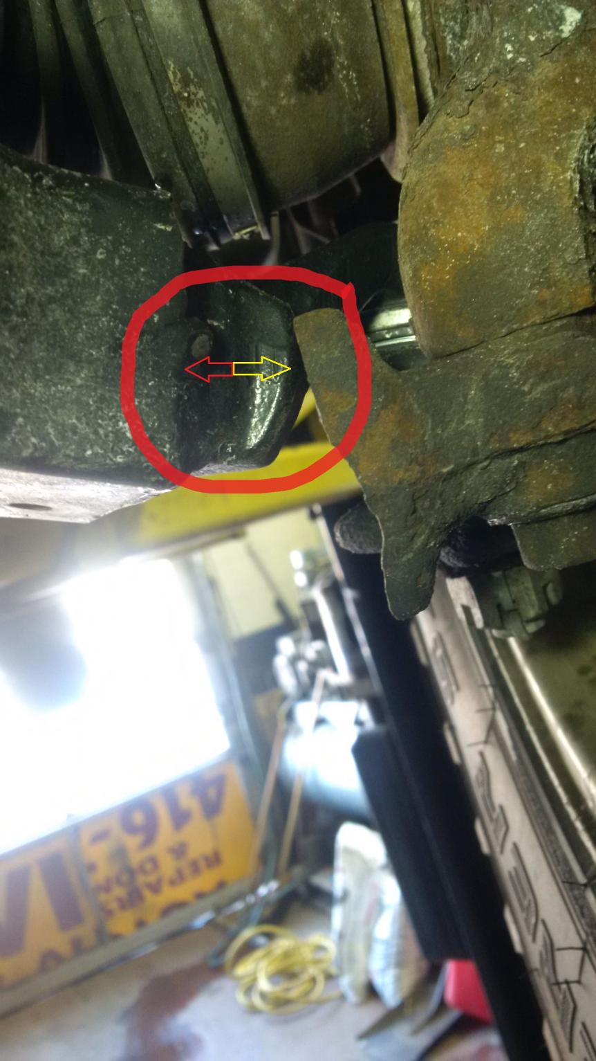

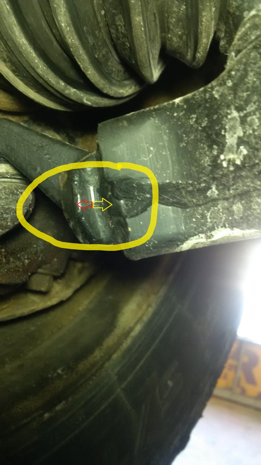

Hello Lady's& Gentlemen,
A word of a warning. I got a pair of lower LCAs from Amazon and I thought I got an awesome deal. Until I realized that after repairs my steering wheel is not turning all the way to the right. After inspection I found L/S arm balljoint flange was installed incorrectly before welding and is protruding by 0.5 inch further than it should. So angles for caster/camber were messed up. I'm not even sure how alignment shop corrected that. Anyway, here is a link on Amazon.
https://www.amazon.ca/Prime-Choice-...s/B07F1WR67K/ref=dpx_acr_txt?showViewpoints=1
Even without any measurement tools you can see the difference on the pictures between left and right side.
I've heard too many horror stories about non-OEM lower control arms.
I went OEM and have not regretted it.
I did leave a negative review on it. It hasn't been posted yet.
