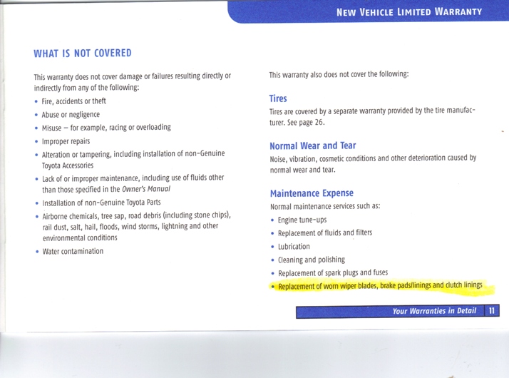

Typically the brake pads/linings are only covered for 1 year or 12,000 miles. They are considered a wear item. Brakes are not covered under the 36month/36,000 mile bumper to bumper or 60month/60,000 mile drivetrain.
Brakes are specificly listed as "WHAT IS NOT COVERED" in the Owners Warranty Information Guide with your owners manual. See Highlighted text in pic below.
I agree that your brake job done at 18k when they turned the rotors was the cause of your brake problem. So from that point it would have been 1 year or 12,000 miles.

I paid for the pad replacement at 18,000 miles because as you stated, warn brake linings are not a warranty item. My warped rotors were treated as a warranty item though.
