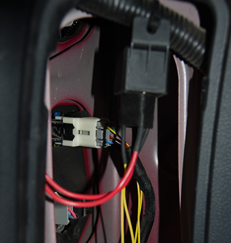

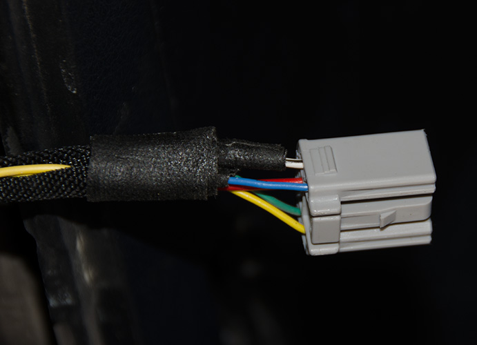

Which wire is the brake light in the harness? I want to do brake lights up top on the rack also.
Ok, here are a couple pictures:
The relay and brake connector in the background:
This is where I tapped into the wiring. The White/Black stripe and the blue. Polarity didn't matter since they are just driving a relay.

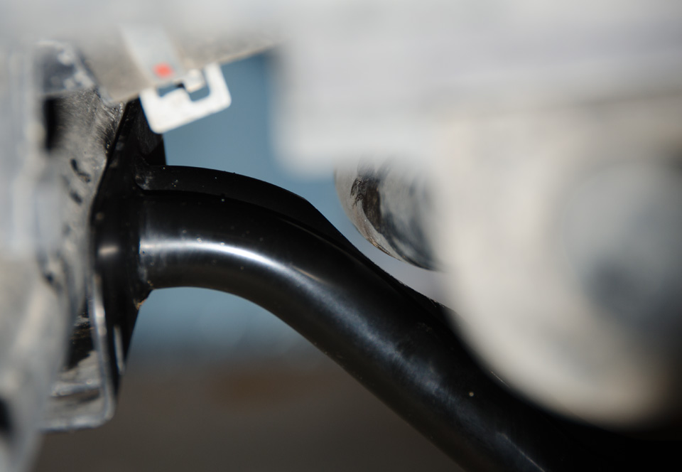

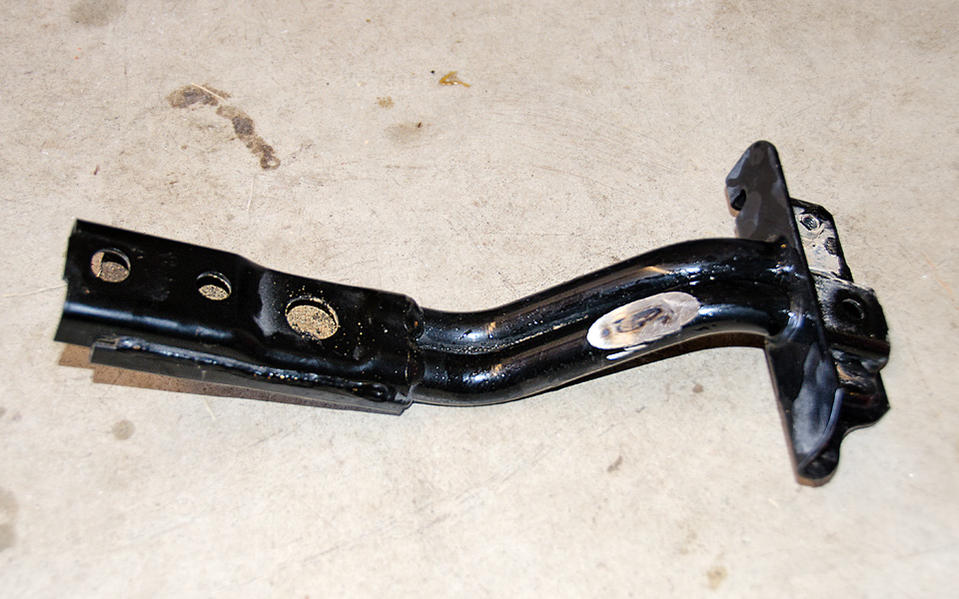

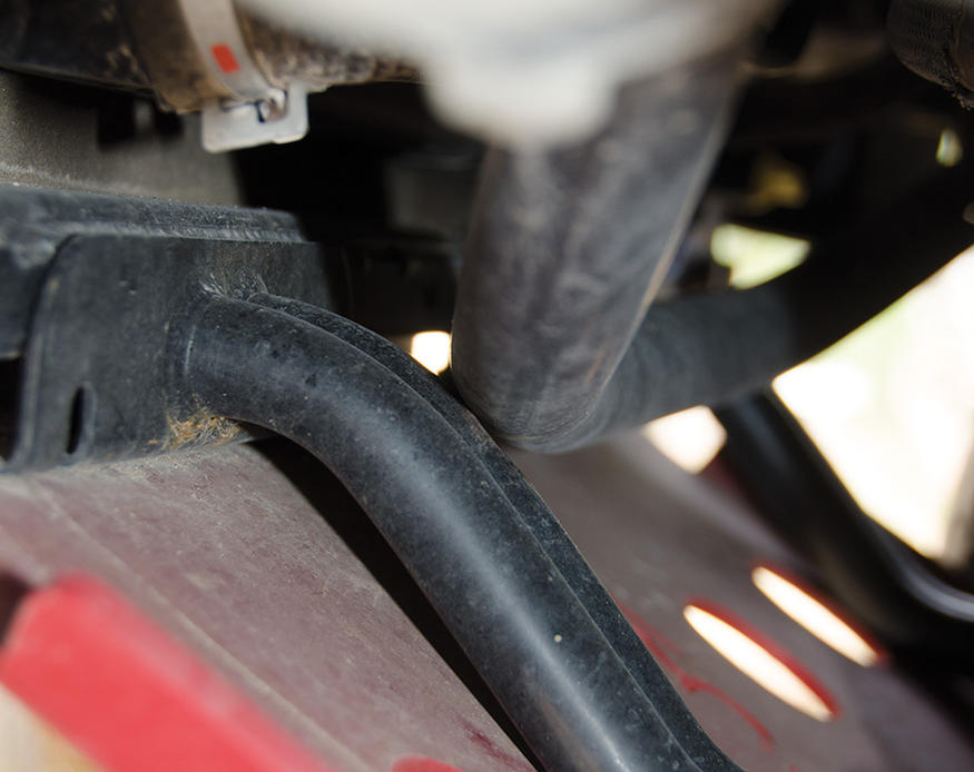

Anyway, my front sway bar has been clanging against a front body support ever since I had my front end lifted and a sway bar relocation bracket installed. Was only audibly annoying on the trail, not during DD so I put it off, but today I was going to fix it.
Here is an older picture I took of it contacting:

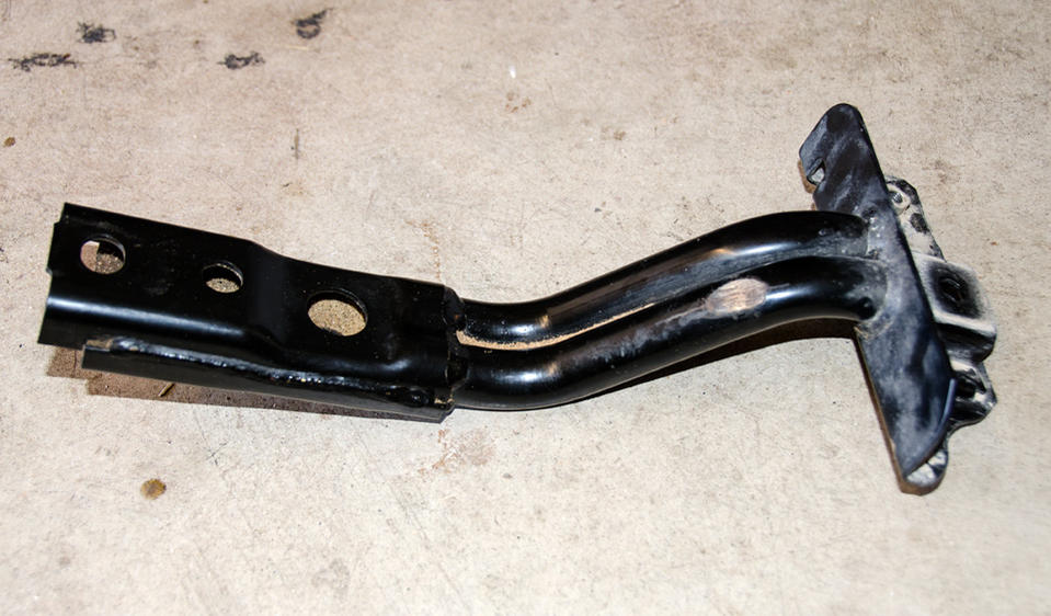

After taking the front skid off, it turns out that the part it was rubbing on was entirely removable. Here you can see where the sway bar was wearing against the part.
Initially I was going to try putting some washers between the part and the frame to move it away from the sway bar, but that would have lowered the front of the skid 1/4 or so which was not ideal.
After examining the part and it's placement it really didn't seem to be something that was a serious structural part. Not REALLY sure what it's main purpose really was other than maybe rear support for the factory skid? So if you went over anything it would ride on these rails from the front to the second cross member?
SO anyway I decided to just use the wear mark and grind the one tube down enough to clear the bar instead:
And attached:
There is a good gap now when attached. However The sway bar can move around a bit in those rubber bushings, it may hit again. I painted it so if it does I can see where and grind some more off.

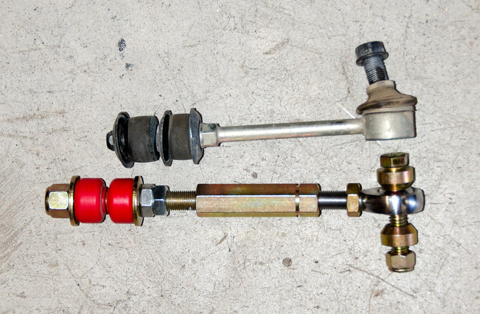

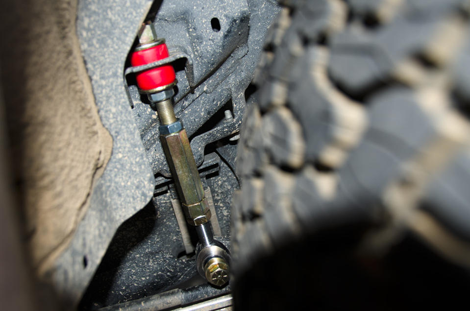

The second thing was lengthening the rear sway bar links. After the lift they were pulling the sway bar ends up quite a bit and that was limiting droop.
I had bought some of MStudt's releasable rear links and a set of adjustable front links some time ago but never installed them. Turns out the front links you cant adjust too much due to the lower end already being really close to the CV joint so it didn't seem worth putting on. The rears I put on but the releasable mechanism rattled like CRAZY just driving down a normal paved road. Drove me crazy after one day and I took them off :(
So using parts from the two sets I made ONE set of adjustable but not unlinkable rear links:
And installed:
The sway bar ends are now down about as far as they can go and should give as much droop as I can get without removing it entirely now :)

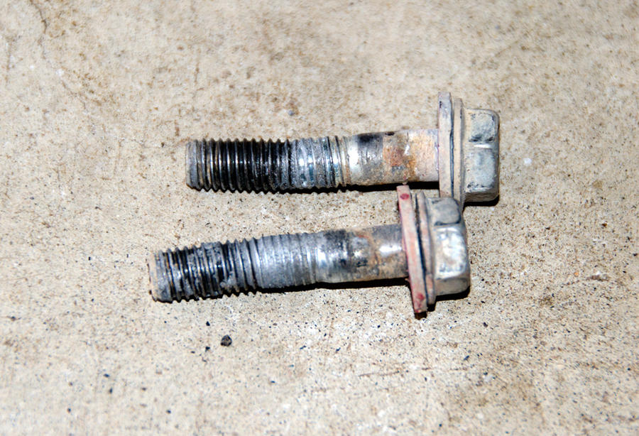

So also: I removed the front skid to get at the part I needed to modify for the front sway bar clanking and the two rear bolts were really bent out of shape from skid plate "use"
I went to Lowe's and bought some replacements but they aren't the same quality at all. RCI sells replacement bolts which I'm going to order. I'd suggest anyone with RCI (or other) skid plates to buy a few replacements!

2014 I went to Lowe's and bought some replacements but they aren't the same quality at all. RCI sells replacement bolts which I'm going to order. I'd suggest anyone with RCI (or other) skid plates to buy a few replacements![/QUOTE said:
McMaster Carr also sells the bolt you need.
http://www.mcmaster.com/#standard-cap-screws/=wqfe27
Look at the Flange Head Cap Screws and scroll down to the bottom right of that page and look at the JIS metric high strength steel ones. I just ordered a bunch of replacements for the various skid plate bolts as I usually damage the heads pretty good when off road.
McMaster-Carr
Awesome thanks! :)
Awesome thanks! :)
No prob. The RCI replacement set is about $30 if I remember. For just a little more you can get the equavelant of about 10 replacement sets from McMaster Carr. I think this is where RCI gets his hardware anyway, as they are identical. Just make sure you have a damaged bolt remover kit! I've had to use mine after every off road trip.
spin_prod_207242301
Heh you aren't kidding about this. One of the bolts was too mangled for the 13mm socket, though I got lucky with a 14mm this time. I was very Unlucky though that the bolt had been hit hard enough that it cracked loose the poorly tacked on nut inside the cross member :( Now I got a loose but not removed bolt and jammed on nut rattling around in the hole.
I'll probably be able to torch the bolt head off and then, through some amazing contortions, use a magnet to pull the rest of it up and out of the cross member through a hole somehow. But getting another bolt in there... ugh.

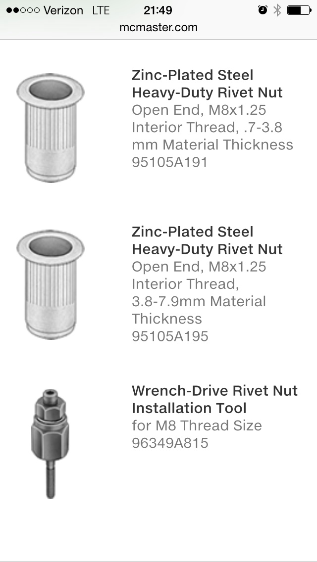

Do they make something like a Jack Nut that's strong enough to hold a skid plate on?
Edit: Looks like I can get a but with a flange on it (A Weld Nut) and try welding it to the surface of the cross member. Luckily the cross member there can be detached to work on it though there are several things bolted to it :/
That sucks. Which bolt was it? Something like a jack nut might work.
I used these on my FJ when I lost my skids on the trail and my weld nuts broke off. Works really good and are simple to use
Ah I was looking for something like that... I'll order some of those and some weld nuts just in case... :)
It was a bolt in the cross member that the rear of the transmission mount is on. But I've heard of other people breaking the nuts off of other places. They are just tack welded on unfortunately :(
