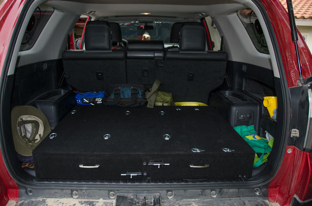

Drawer system
Well my tiedown rack has worked well, but it doesn't provide any real storage space and I have to remove it every night for sleeping so I'm making something new to replace it.
A pair of drawers with a carpeted top to match the interior will be permanently mounted in the back. On the Pass side will be a place for mounting the fridge. On the Driver side there will be a removable extension that goes up to the back of the folded seats that will be a sleeping area. The entire top will have several hideaway tiedowns for securing gear while moving, then I just need to move the gear off the sleeping area for the night. Nothing else has to be taken out.
I bought all the wood and some hardware and the fuzzy interior cloth covering material. So far the cost is $202. Some glue and drawer hatches and the tiedowns will probably push it close to 250 total.
One of the drawers will be slightly shorter than the other to accommodate a pull out utility table from beneath is as well :)

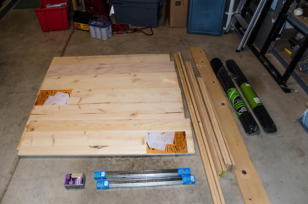

Pic of the materials. Will update as I put it together...
Final materials list
(Not everything shown above)
Note that this list is mostly accurate from receipts but not guaranteed to be 100% correct.

Wood:
* 1/4 x 3/4 x 8 foot trim molding (Drawer side/back topping)
* (2) 1 x 6 x 8 foot pine plank (Sides of main shell and drawer fronts)
* (2) 1 x 2 x 8 foot pine stick (Various places though out build)
* 1 x 12 x 48 pine panel (12 + 20 inch panel == 32inch deep platform top)
* 1 x 20 x 24 pine panel
* 1 x 24 x 48 pine panel (Sleeping extension)
* (2) 24 x 48 1/4in birch plywood (Drawer bottoms)
* (4) 3/4 x 4 x 36 "Craft" pine (Drawer sides)
* 1/4 x 24 x 48 plywood (Pull out table)
Glue:
* 1/2 bottle wood glue
* 2 cans of super 77 spray glue
Hardware:
* (2) pairs of 24 inch 150 pound drawer slides
* Box of 2.5 inch wood screws.
* (10) D ring Tie downs
* (20) sets: M6 x 30mm bolts, washer and locking nut
* (2) shallow drawer pulls (So to not hit the plastic on the rear hatch when closed)
* (2) Black barrel bolts (for securing the drawers closed)
* (20) large round head Philips screws (For attaching the metal brackets to the wood drawer frame)
I used spare bits of wood, shims and scrap metal in various places as needed.
Also used staples and staple gun already available.
Bolting to vehicle body done with on the fly welded scrap steel and existing frame nuts for rear slider tray which was removed.
Look closely at the pictures below for other details...
Covering:
* Three rolls of lightweight interior "carpeting" (Pep Boys). 2 black, one grey.
If you are not doing the bed extension, you can get away with only two rolls.

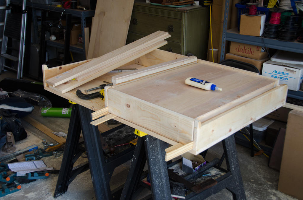

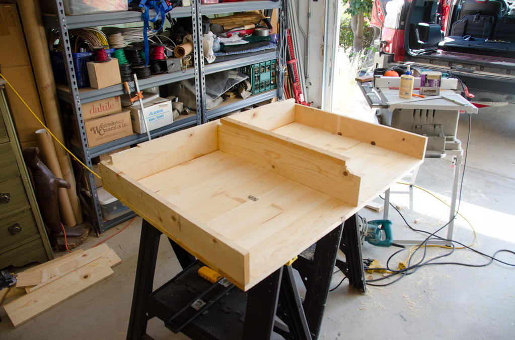

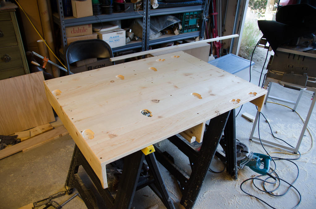

Basic shell. I am using pine planks specifically for a couple of reasons. It is somewhat lighter than plywood. And in the direction fo the grain is VERY stiff,
not requiring any further bracing across spans such as the drawer openings.
The top. I measured and placed several tie down D rings. Then routed them out so they would sit flush when not used.

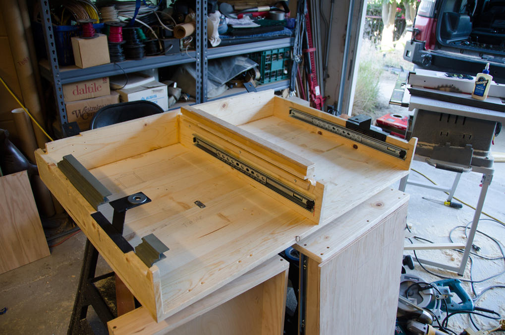

Making the drawers.

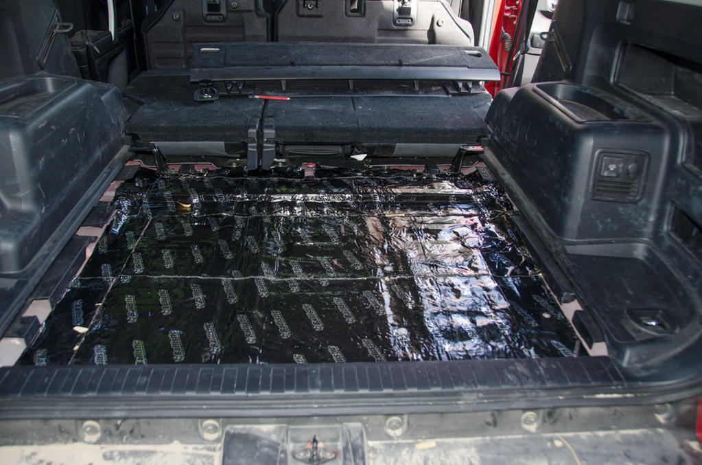

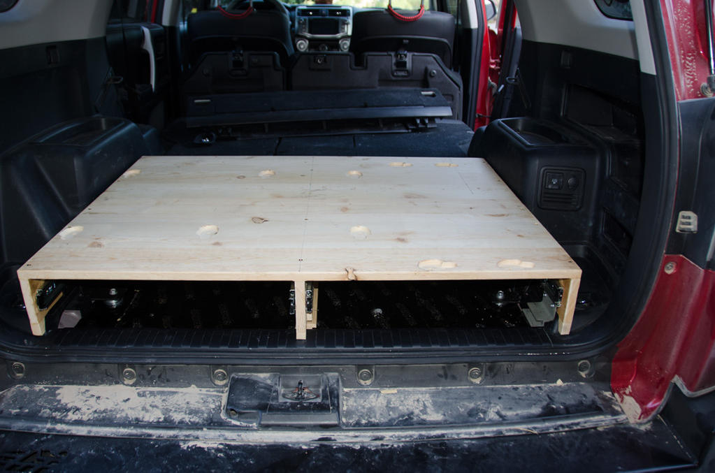

After removing the tray and the felt/wool/foam bottom(It stuck up to high to leave in) The noise from the back of the runner was MUCH louder!
So I bought some sound dampening material and it quieted right back down.

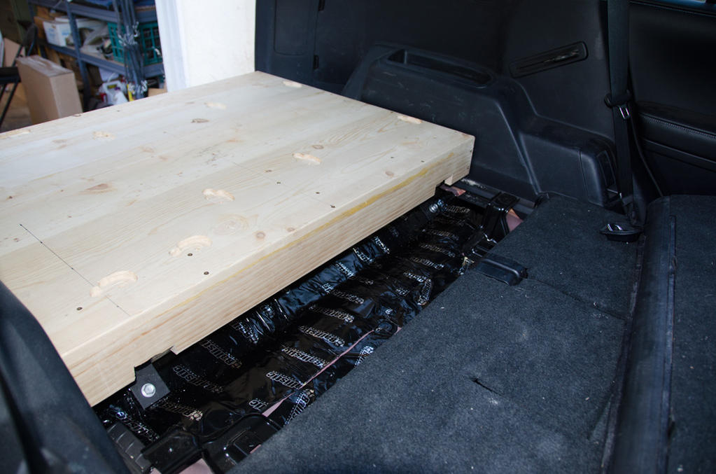

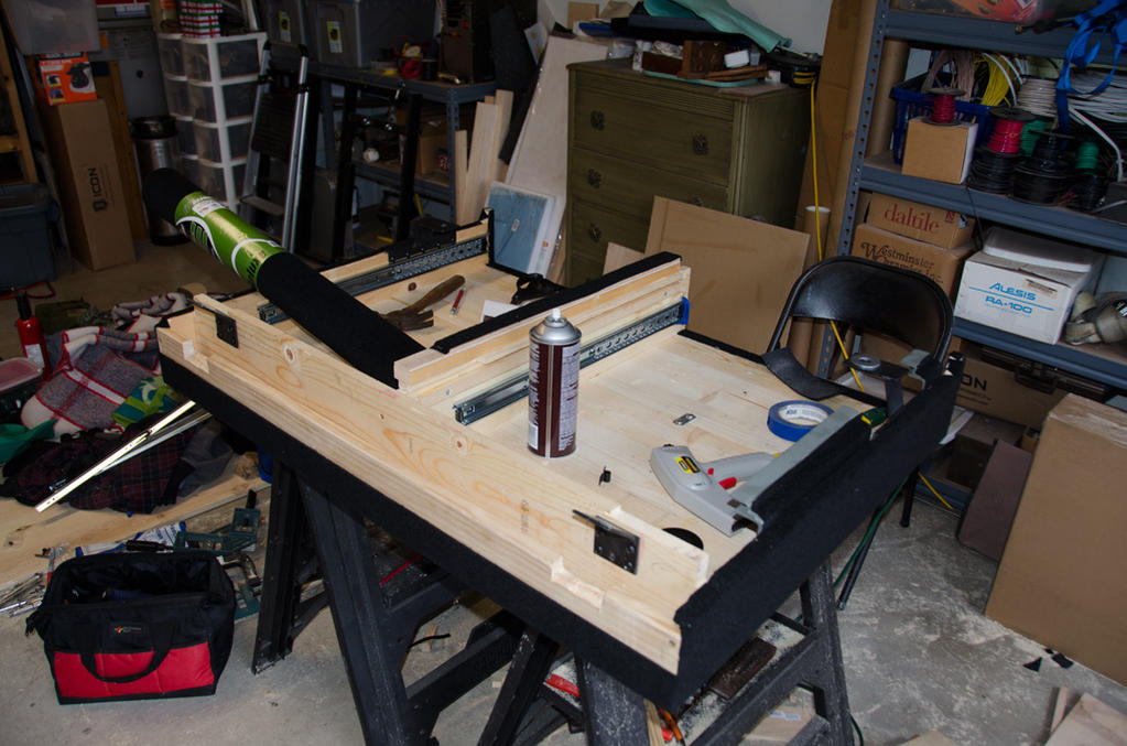

Drawer slides in as well as the fabricated mounting brackets to use the existing mounting locations for the slider. Also sliders for the little pull
out work tray I added.
Mounted in the back.
And the forward mounting brackets in use.
All done except for the covering!

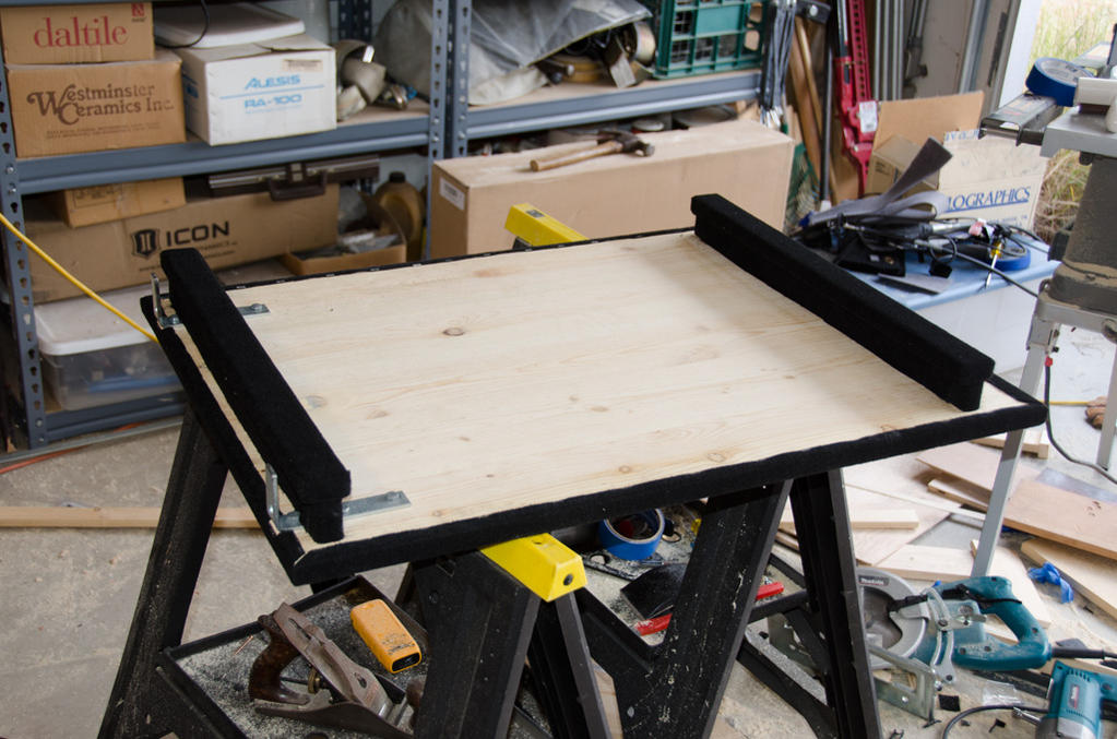

Applying the fuzzy "cloth" covering. Stuff looks nice, light weight, cheap and matches the car pretty well. Course it's a serious dirt trap and grass and
sawdust get really stuck in it :P
Easy to apply, use super 77 on both surfaces, roller down, trim edges then staple where the sun don't shine :)

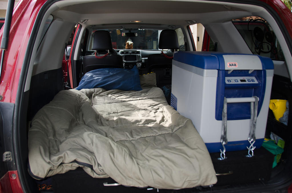

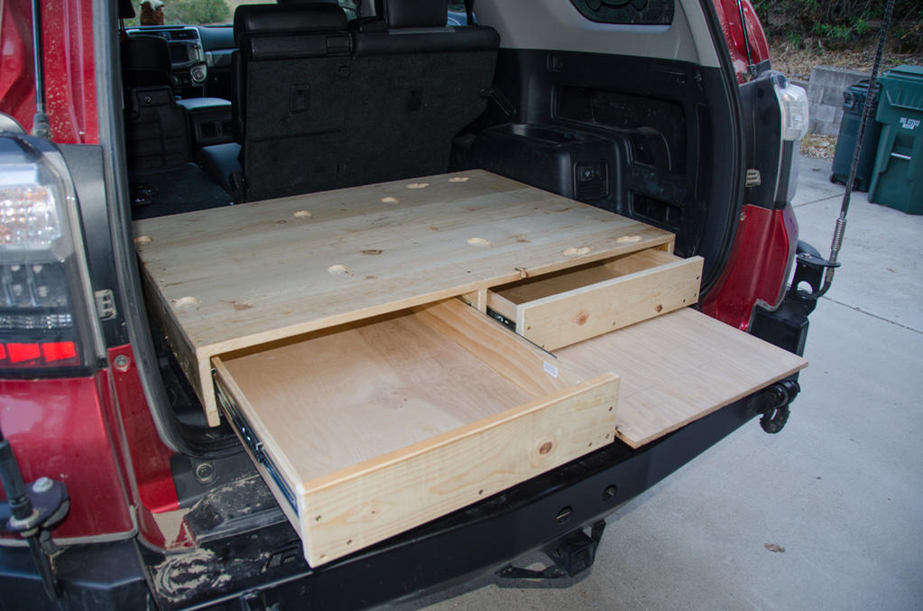

Final piece to make was the removable sleeping extension. Will be permanently installed for trips but removed so I can put the seats up for daily driving.

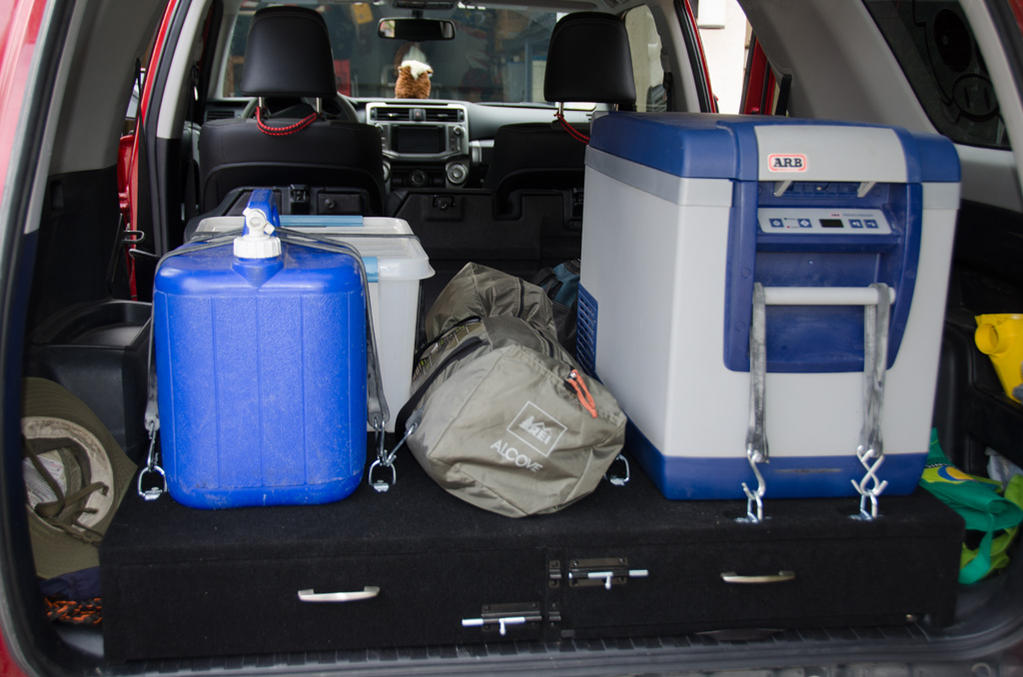

OK! Everything installed! There is a chance that the fridge might move around some though it is tied down tightly. If so I'll make more of a container
for the bottom of it.

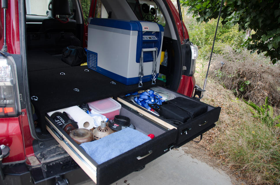

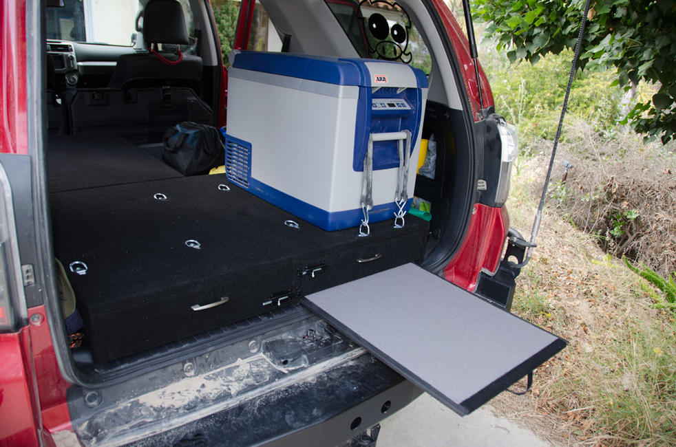

Storage! I plan on keeping all basic camping and recovery supplies so I can for short overnighters/weekend trips just pick up food and water and just
go and have everything else I need already packed.
Tying down the heavy stuff for offroading.
Sleeping configuration. Some stuff moved out or to the front seats, but no longer have to remove the entire tie down rack like before. I do need to
find another mattress solution now though :(

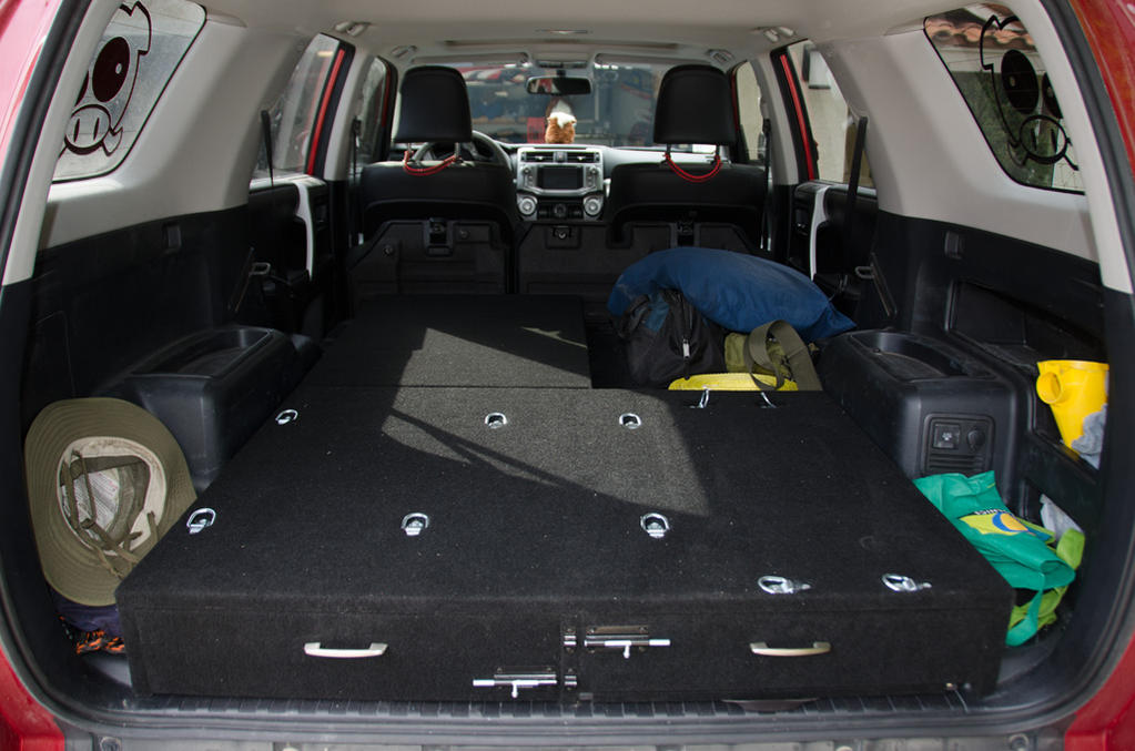

Daily driving config.
COST: $295 before tax. Including paint and glue and hardware of all kinds. Not including the scrap steel I used for the brackets. Also... not including an extra $20 I had to spend on a new pair of drawer slides due to an incredibly stupid accident during construction :D So realistically was about $350 for me in the end.
WEIGHT: The daily driving weight is 55 pounds not including extra stuff in the drawers. The sliding tray was between 30 and 35 pounds so only
an additional 20 pounds or so!
LOSS OF CARGO SPACE: The drawers are 3 inches taller than the sliding tray. SO that is lost vertical height and more lift to get things in the back.
BUT. t is /only/ three inches for a heck of a lot of utility so I am super pleased.
