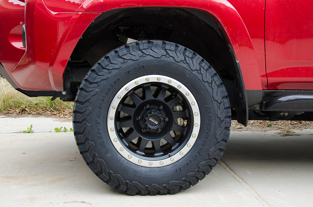

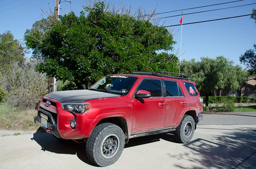

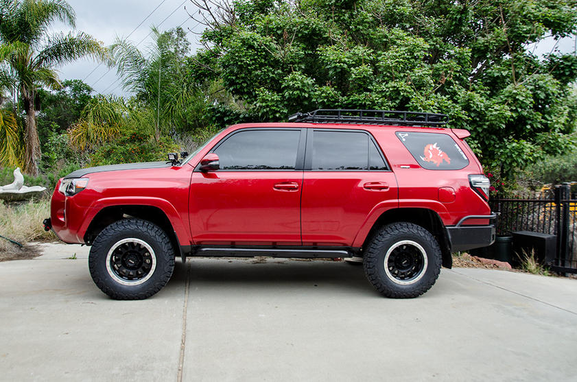

New tires and wheels!
Got a bonus at work so decided to spend it on new tires and wheels for the Warthog.
As I said above, my original tires and wheels were bought in haste and I wasn't ecstatic about them from the beginning, so took care of that today.
Method Wheels - MR304 - Double Standard - Matte Black/Machined
17x8.5 0mm offset (4.5 in backspacing)
275 70 R17 BFG KO2 tires
The tires fit well no rubbing at all... almost.

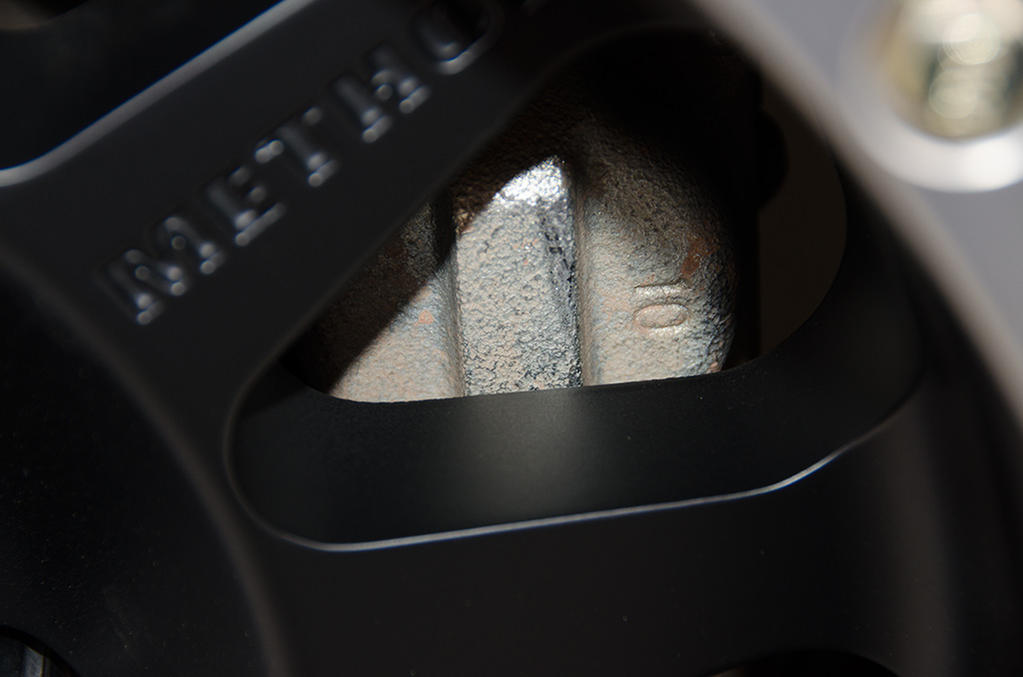

It turns out that the spoke design of these wheels curves back into the wheel and the spokes were just barely rubbing on a protrusion on the brake caliper! ?!?!? :(
So ORW put on a 1/4 inch shim spacer on the front wheels to get them to clear :/
And I thought I had it all figured out before ordering!! :doh:!

new wheels look really good.
I would take your 4Runner back to the shop and try to get your money back for the gears work. If they did a bad job then they are responsible and normally offer a 12 month warranty.
From what I remember a lot of guys were having the same issue with the method wheels. Thought they resolved it but guess not.
Otherwise looks great.
When I got 4.56s on my 4th gen the gears did the same thing. I took it to a shop that did mostly jeeps and they didn't do the preset right and it made the exact same noise at the same rpms!
I had it redone at a more reputable shop. Do you know the brand of 4.56 rear gear you used? Or did you keep your stock gears?
I suppose I probably should try but honestly, I don't know if I could prove a case really :/ He did open it up again and check things out, refill with new oil on his own dime already. I also saw on this forum since that several others that also had this happen after a locker install and just as many that had it happen without even opening the diff. SO not sure I could really argue negligence, it might have been or it might not have been. Maybe going to Big Bear before 1000 miles on them was a problem which was my fault. no way to really tell.
So I'm willing to just let it go.
Heh, man I missed that or I would have picked a different wheel :D I was so careful about width and backspacing and tire size... there's always one more thing you overlook :D
Wow looks Great! You can probably grind some material off of the calipers without any ill effects.
I need to check the thread depth with the shims on, if it's sufficient then I'll just leave it. If there are only like 4 turns and the rubbing is really only a little bit then yeah I should look at doing something like that.
I kept my factory gears. 4.56 just seems to high for me since I am not really a hard core rock crawler :/ I'd love to get maybe some 4.10s in there but there are no quality gear sets at that ratio for the 8.2 diff yet.
Maybe by the time I replace these new 275s there'll be a good 4.10 gear set and I'll do that and up to 33s then :)

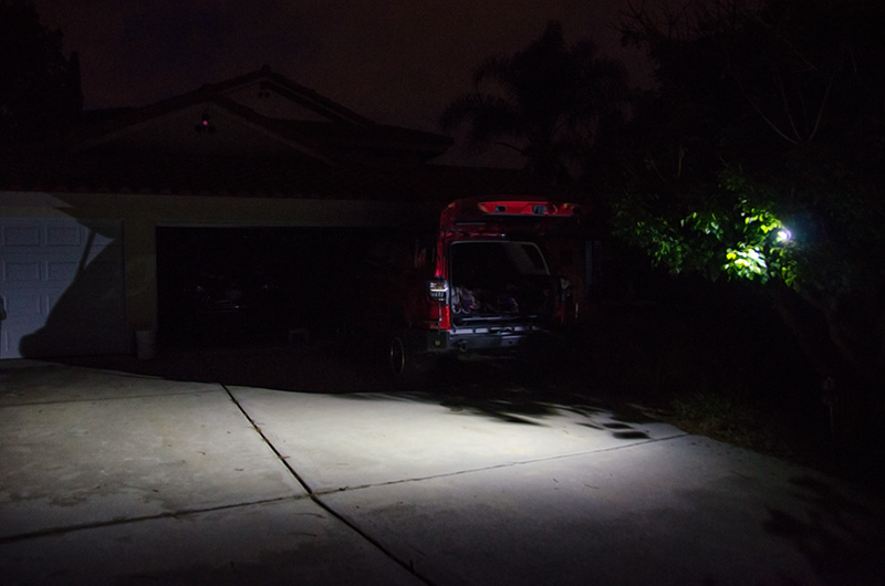

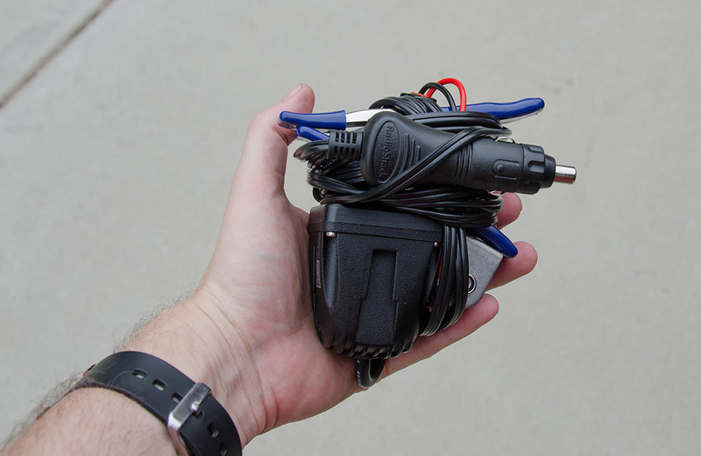

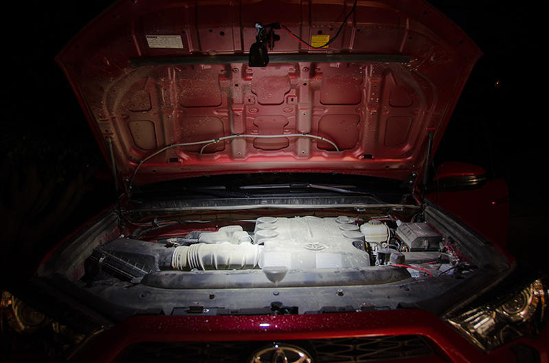

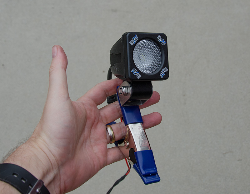

Versatile DIY Camp/Work light

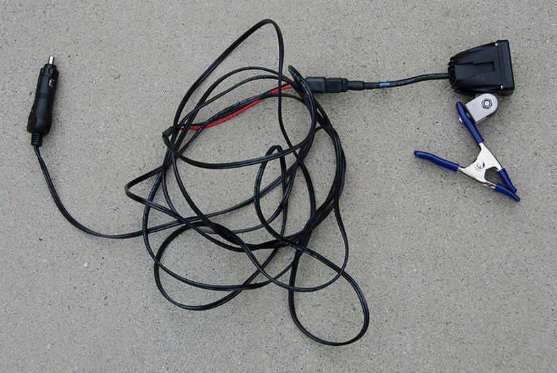

While I was lolling around ORW having the new shoes put on I of course drooled over all the other stuff hanging on the walls.
They had a nice 10 watt wide angle single let light module hanging there. It was kind of stupidly expensive but it had a really nice wide angle diffuser on it that is not easy to find. So I bought it.
Then got some other supplies and made this!
Unraveled we have a power plug, 15 feet of wire and the light module attached to a regular old wood clamp.
Here is a look at the diffuser

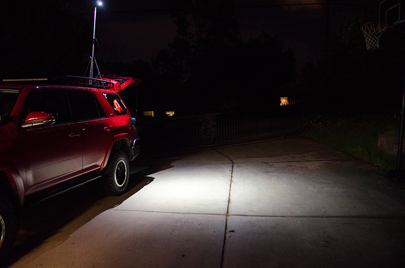

Campsite simulation pics!
Attached to rack.
Attached to tree at camp.
attached to lantern pole for wider coverage

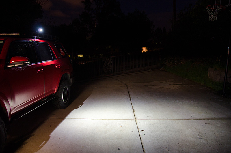

Emergency simulations too!
Fixing engine
Finding out what that clunking noise is in the dark.
It's fairly bright, could be brighter, but also only 10 watts. With the group 31 battery with a 4 hour reserve. It could power this light for 100 hours and still have plenty of power to start the car.
I had thought about putting camp lights permanently mounted on the rack but the logistics of it, seemed a bit much and overall not as versatile in the end...

Where u get the light at?
Off Road Warehouse...
You can find 10 watt modules on amazon for a reasonable price ($25?), but most of them are spot beams, more like a flashlight. Look for a wide angle one if you want an area light.
I sense that I have a trip to ORW in my future...
I could wire the LED to an SAE plug and then I could run it off my motorcycle or the 4Runner. The possibilities!!
