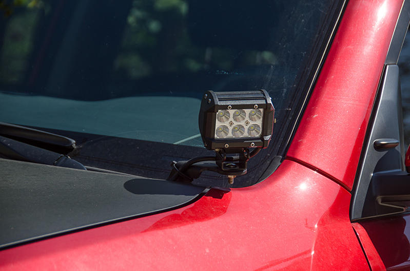

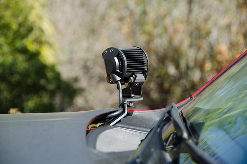

I had initially mounted my ditch lights on the rack up top. That was an ok place for them, though they lit up my mirror some, and they kind of stuck out and I was afraid they might be taking off more mileage up there. So I bought a set of CBI ditch light brackets to mount them to the hood.

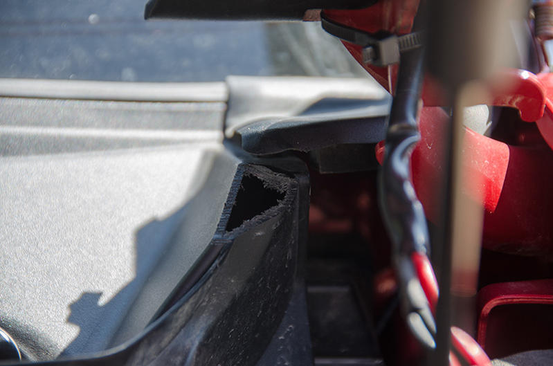

Clearance with hood open
Problem: The brackets actually hit the plastic drainage system when the hood closes. And that plastic is strong enough that it actually bends the hood hinge up when closed, exposing about 1/8 inch more gap between the hood and the quarter panel :(

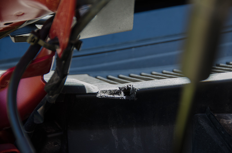

So... out came a loose hacksaw blade to trim down the plastic in order to make it fit...
Trimming on the passenger side

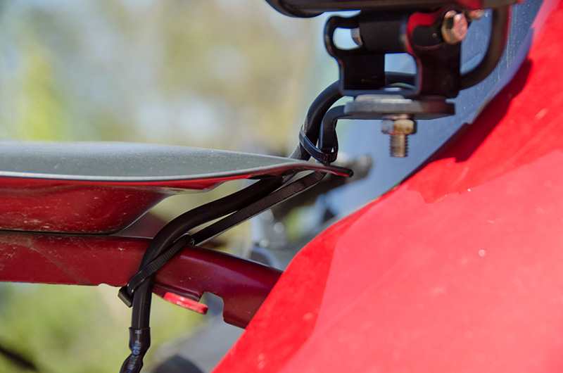

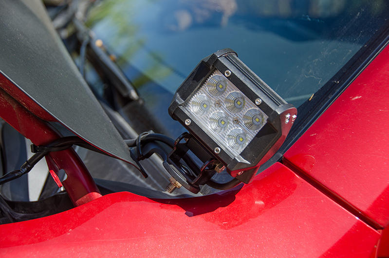

Here is the bracket in profile. It seems like it could have followed the hood line a little more closely and prevented the need for cutting the plastic. Though maybe this is only a 5th gen problem?
Overall I like them in this position a lot and would still recommend them as long as you don't mind possibly having to trim some plastic to get them to fit.
If there is that much gap, could you not have bent the mound up to follow the hood contour more?
If I had had a nice press brake (which I would love to have) maybe :D The metal is pretty thick, a vice and a rubber mallet wouldn't have worked well I don;t think :/
It was pointed out to me later that I could have used a hot air gun and done a much cleaner job by heating the plastic then closing the hood to push it down though!

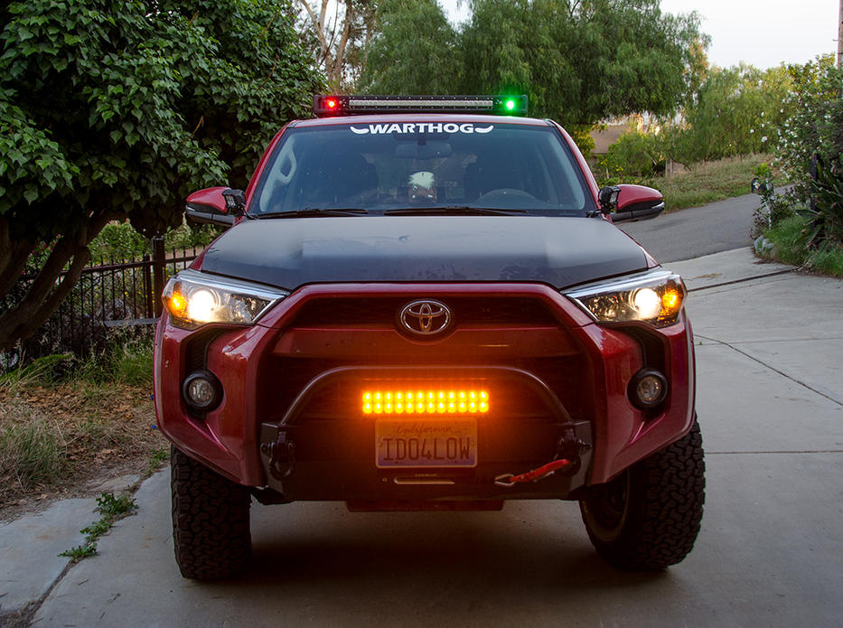

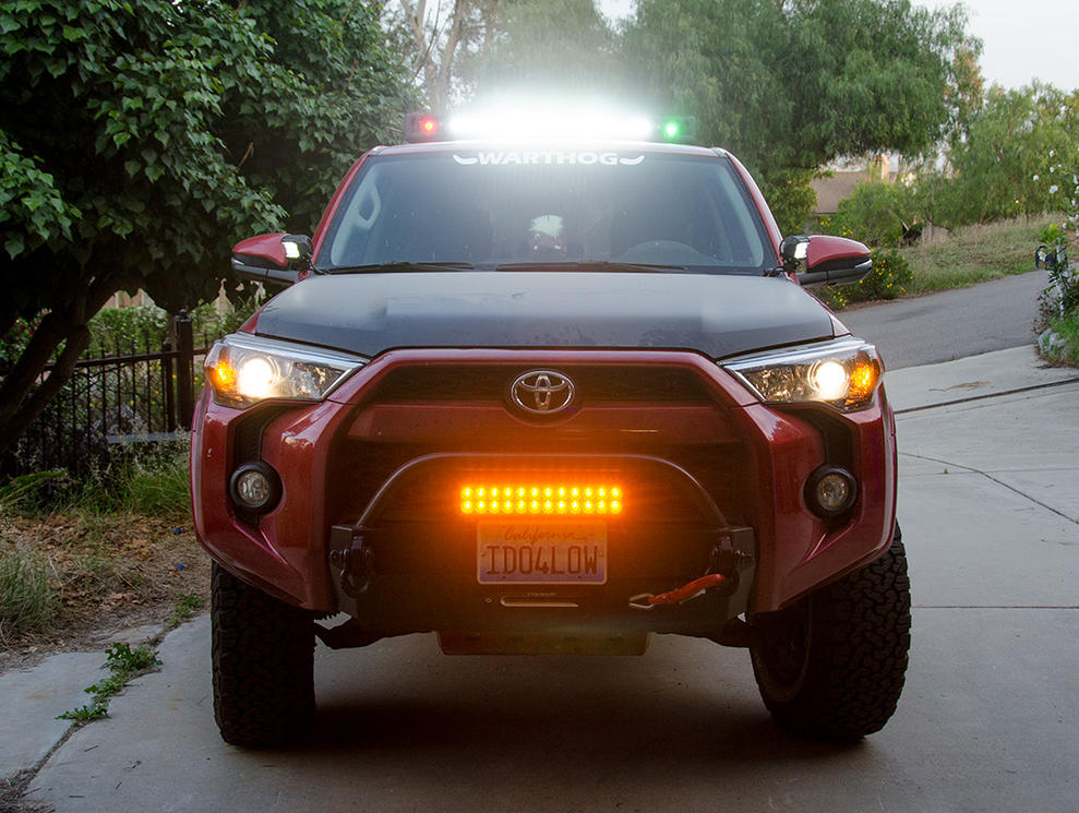

New running lights!

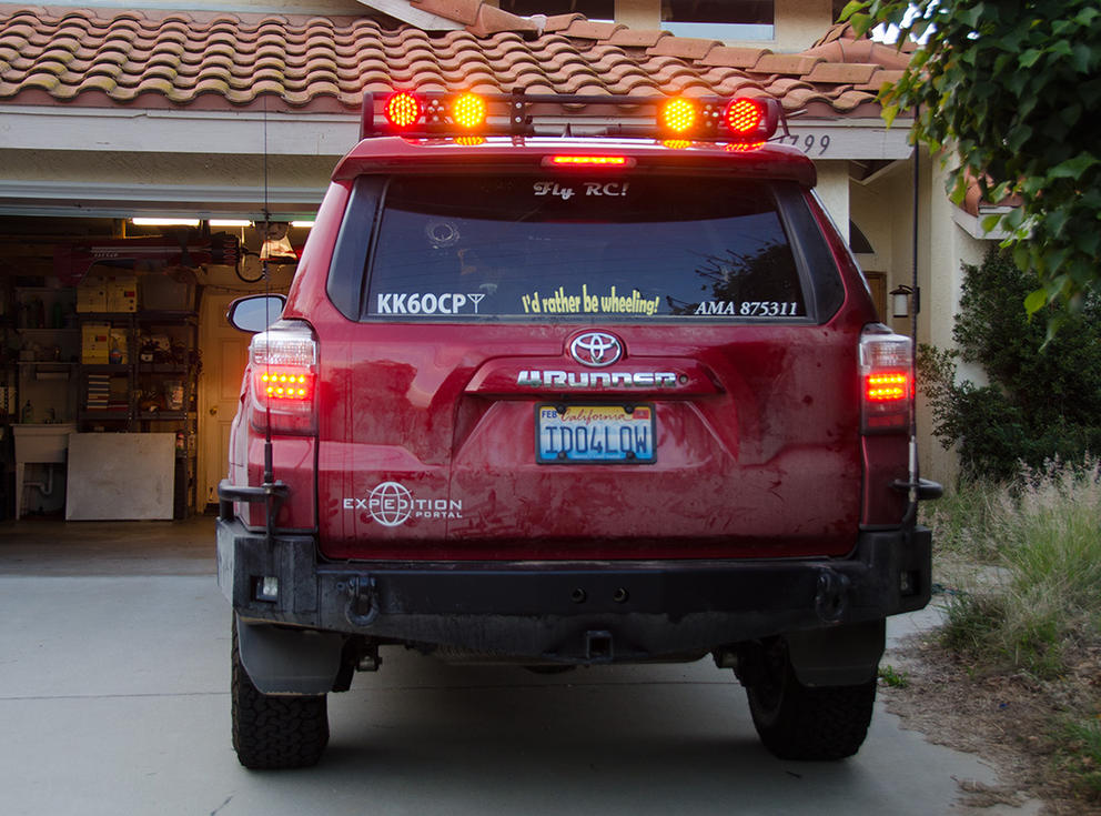

Spent the week installing some new running lights on the Warthog.
On the front I added some Navigation lights for fun :D And no they aren't backwards. They ARE opposite to how they would be mounted on a boat but people pass on the "port" side when you're in a car so...

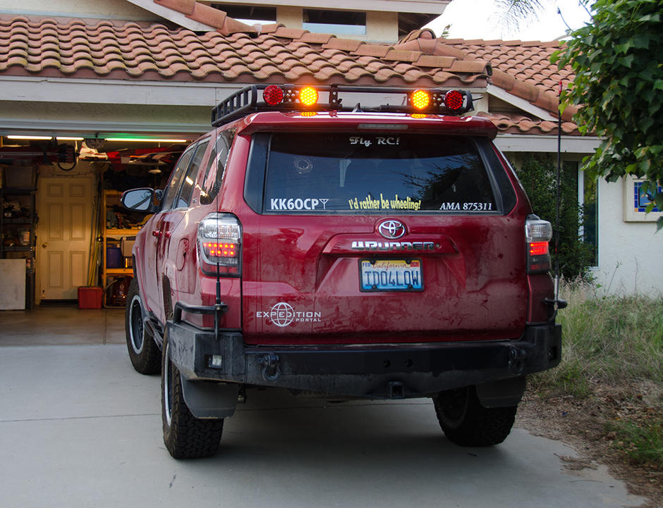

And on the back, I had some nice bright amber lights which worked GREAT during the day. Really cut through the dust and were sometimes the only visible thing about the car according to others. I tried to find some red lights to match for brake lights but couldn't :/ I found these new LED buggy lights at ORW that came in red/yellow and blue. So I got a matched set of red and yellow and spend a day making brackets for them. Then another couple days wiring them up.
The upper brake lights are wired to a relay and the relay wired to the driver side brake light cable in the back. Sadly the red is not quite as bright as the yellow but I think they'll work out fine.

If I am getting this bumper, you are probably who inspired me to do that.
I AM coming to your house for the installation.......
I guess we could do that. We could probably get it done in one long day. It is a lot of work! And hopefully not when it's 90 deg out :P
Which wire is the brake light in the harness? I want to do brake lights up top on the rack also.
What i did was attach a relay to the driver side brake light harness as it attaches to the light assrmbly itself. There were only a small number of wires there and only one pair that had voltage when the brakes were on.
I then used the relay to switch on/off the power going to the rack mounted running lights. So the upper brake lights only work when i have my off road running lights switched on.
