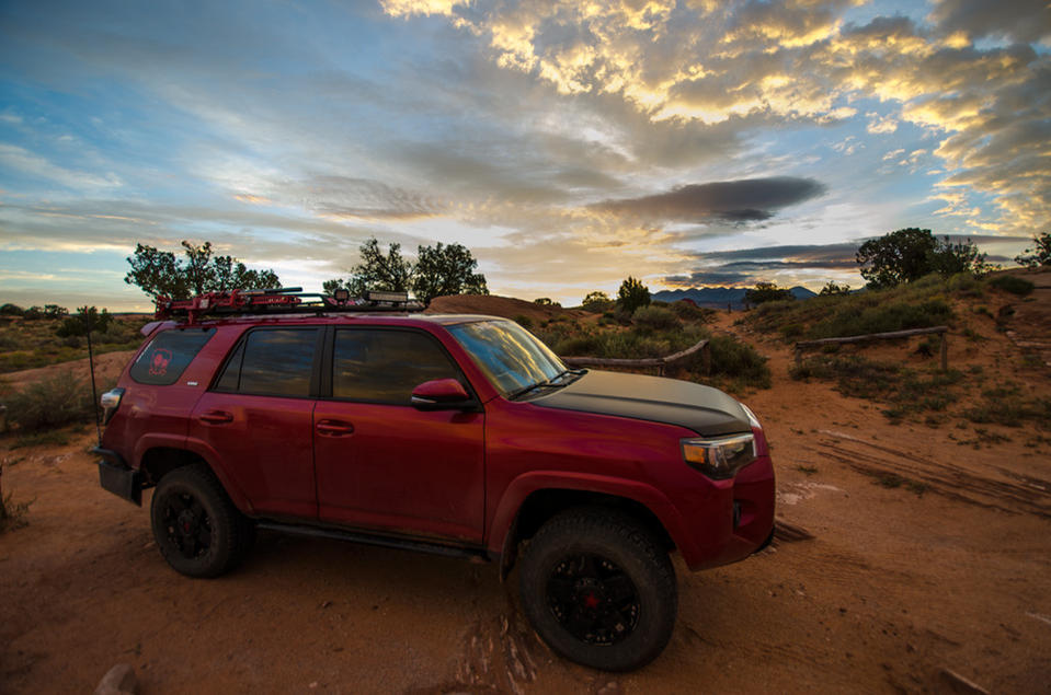

The morning we were leaving. Clouds gathering, yellowish light, ominous.
Rain held off till we were up and had everything packed and on the road though so "Yay!".

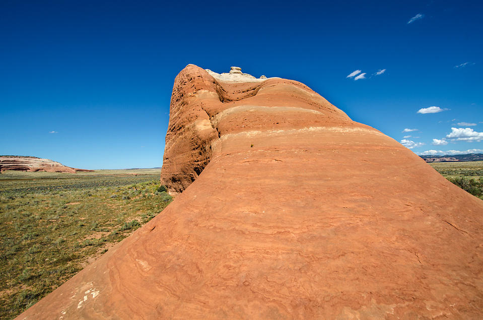

Well those are some of the places in the photos. Maybe 0.1% of the awesome places you can go near Moab :D Definitely buy a book or two of moab area trails, there are SO many places to go.

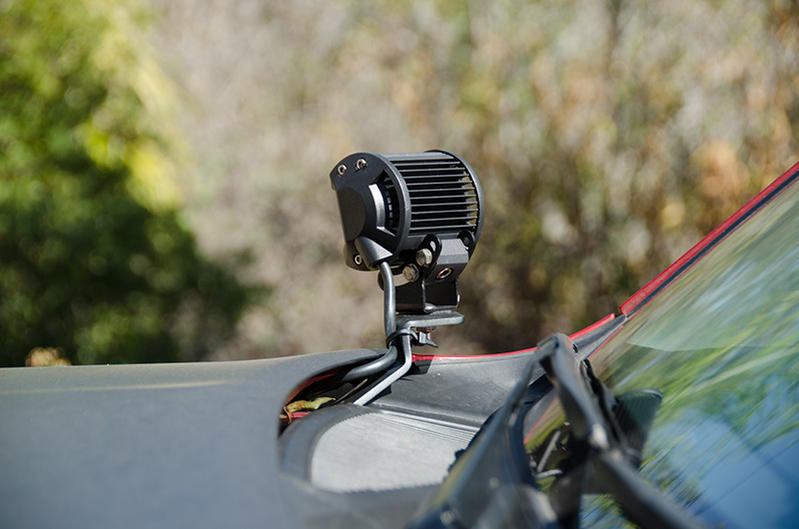

Ditch lights

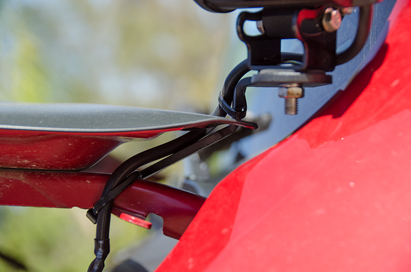

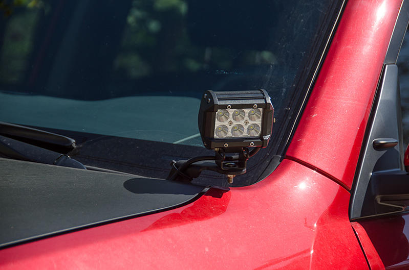

I had initially mounted my ditch lights on the rack up top. That was an ok place for them, though they lit up my mirror some, and they kind of stuck out and I was afraid they might be taking off more mileage up there. So I bought a set of CBI ditch light brackets to mount them to the hood.
Clearance with hood open

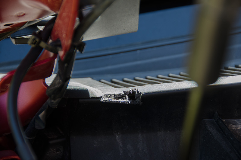

Problem: The brackets actually hit the plastic drainage system when the hood closes. And that plastic is strong enough that it actually bends the hood hinge up when closed, exposing about 1/8 inch more gap between the hood and the quarter panel :(
So... out came a loose hacksaw blade to trim down the plastic in order to make it fit...
Trimming on the passenger side
Here is the bracket in profile. It seems like it could have followed the hood line a little more closely and prevented the need for cutting the plastic. Though maybe this is only a 5th gen problem?
Overall I like them in this position a lot and would still recommend them as long as you don't mind possibly having to trim some plastic to get them to fit.

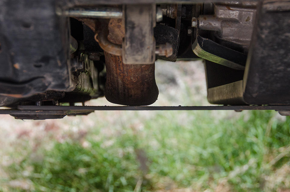

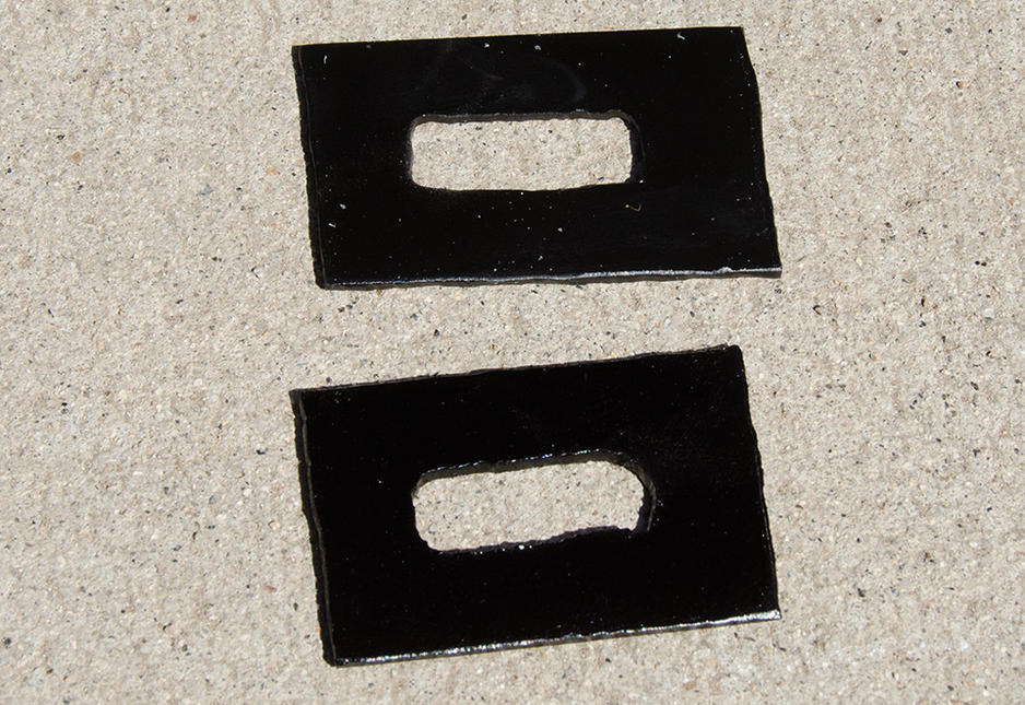

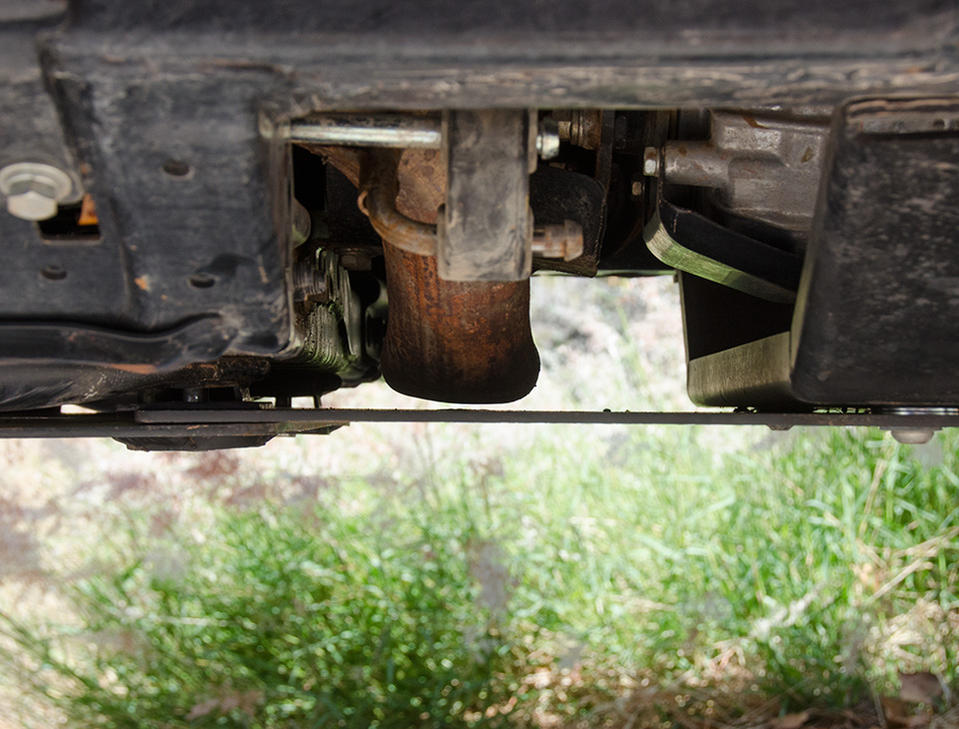

2) After the last moab trip, I bent the skid under the exhaust pipe crossover a tiny bit and reduced the clearance from about 1/8 in to < a 16th. In reverse the pipe would rattle pretty loudly against the plate.
So I quickly cut a couple of spacers to add back the 1/8 in spacing.
If I bend it more, I'll then just flip it upside down till I bend it back :D

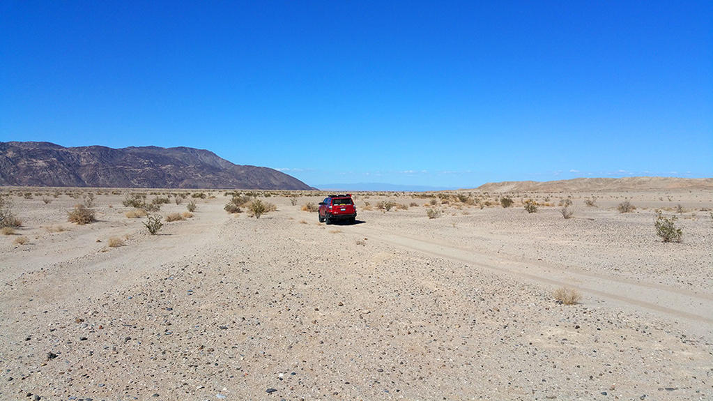

Last Sunday I got out to Borrego for a day trip. My friend was sick so I went alone. Not nearly as fun that way :(
I headed for south Borrego, to areas I used to camp 30 years ago with another friend that is no longer with us. Was a bit harder than I thought to find the old spots where we camped. After 30 years, those snapshots you have in your head you find out are not all that accurate. Things just don't look the same, even though they haven't changed at all.
Course some things have changed!
THESE THINGS. There's like 50 of them ALL OVER the lower borreco/ocotillo area now. Almost completely surrounding Ocotillo. Those people that lived there and had clear and vast views of the desert are now hemmed in by these giants. Kind of made me think.. What exactly is "Green" or "Eco" about these again?
Explored around the Dos Cabesas area. We used to camp at Mortero Palm a lot.
I scrubbed out the "Hail Satan" on the base :D I was surprised they spelled it correctly. Must have been real Satanists!
Headed over to the old calcite mine area. I didn't think I'd been there before but when I arrived I had a distant memory of it come up from the depths.
I then headed over to the fossil canyon area. Boy that place has changed :/ besides being encroached on by development, it is now apparently the official, unofficial lawless shooting rage for the most part. Everywhere I went there was tons and tons of brass and shells. Couple of guys with some insanely high powered sounding stuff shooting at steel plates it looked like in one area. Could have been wood painted dark grey though I guess. Fossil Canyon itself was also blocked off to vehicles, hiking only. But if the shooters all go to that area instead of Painted gorge area like I've seen in the past then overall that's a good thing. There wasn't anything really that special about the camping there really.
From there I headed to Painted Gorge to see what was up over there. There was a new gate across the entrance since I was there last. Now closed Jan1 to July1 for the Bighorns. So go early if you want to get in. Drove as far back as I could but not up the trail to the peak since I was alone.
No one was camping in the gorge! Strange, maybe that's fallen out of favor. We always camped in the gorge.
I went back out of the gorge without getting a pic somehow, then over to the shell beds to the north and then drive north on the east side of the mountains. After getting out of the wash to a main cross road I headed to Corizzo Mtn. What a hell road! Woops the entire way ugh.
Half way through I decided I was tired of it and tried cutting across the Stage line trail to the west since I'd never gone past the swamps before. Unfortuantely after a few miles the route was closed due to "unexploded ordinance" :( Had to head back to the Woops road and continue north.
After a while it became a wash and it was all high flying fun till I got to the tip of the Corisso range ( dark mtns on the left in the above pic) and crossed under the plaster city RR trestle. From there I headed SE along a pole road. 100% sand, fast and fun with occasional break slams :D
Then I cut across to Superstition hills. Hadn't been here in at least 30 years. All sand everywhere. And a great view of the military action, including live bombing, even at night! Only a lonely helo out today though.
Only did a little dunes running as again, I was by myself and didn't want to get stuck somewhere stupid.
Finally headed back towards Seeley and home. Passing by the dummy target range where we used to watch them drop talc bombs from about 1000 feet away. Range was still there, but quiet on a Sunday. Had some new targets out there it looks like though.
Headed back home as the sun was low, clouds keeping it from my eyes mostly and listening to my new "Desert Mix" on Google play that I recently put togeather of all my old late 60s /early 70s arena and psychedelic rock for the drive home.

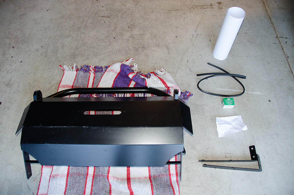

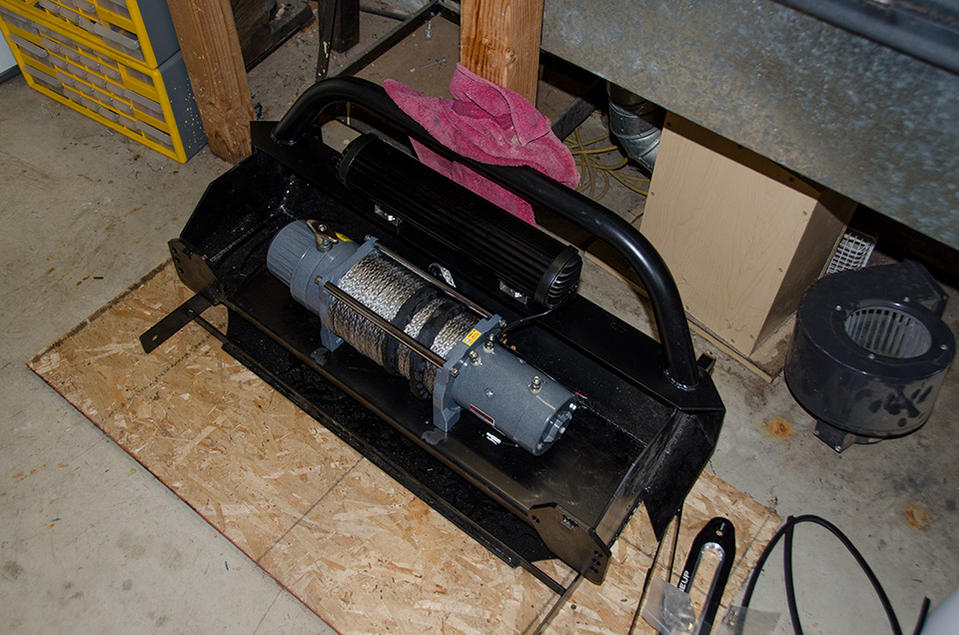

What arrived. (Winch arrived like two weeks earlier) The bumper, bolts, bumper cover support brackets and edge finishing, even a cutting template for non-trail owners. Nice.
I can see what caused the shipping snafu, the packing list had my address and phone number on it, but the phone number had a 6 where a 0 should have been so they couldn't get ahold of me for delivery. :/

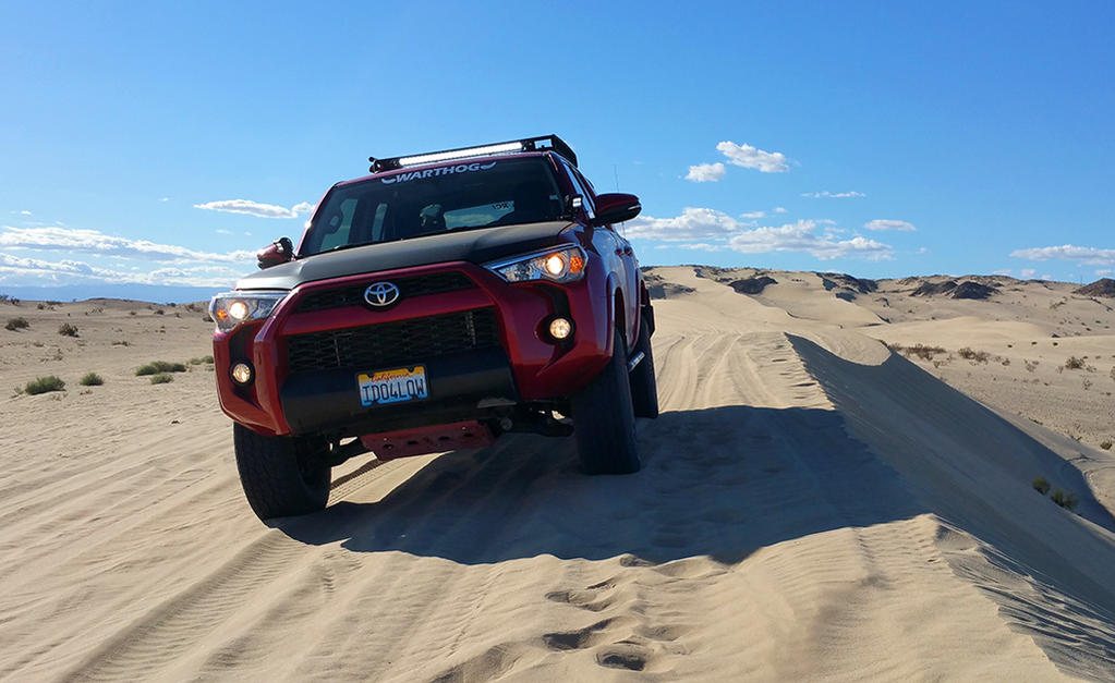

Mounted the winch and the dust light bar. I mounted the bar too far back it turned out later, Doh.

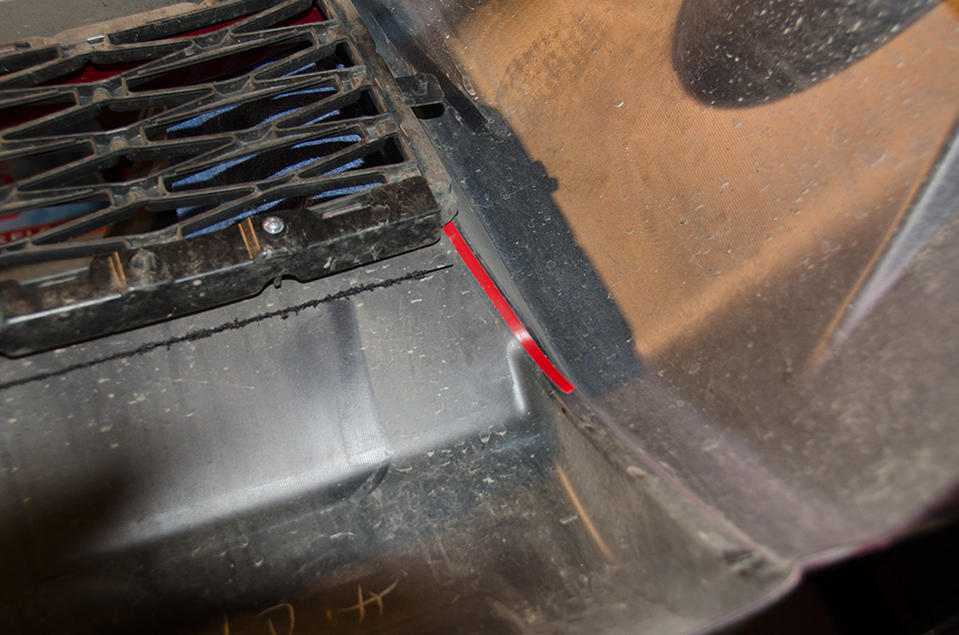

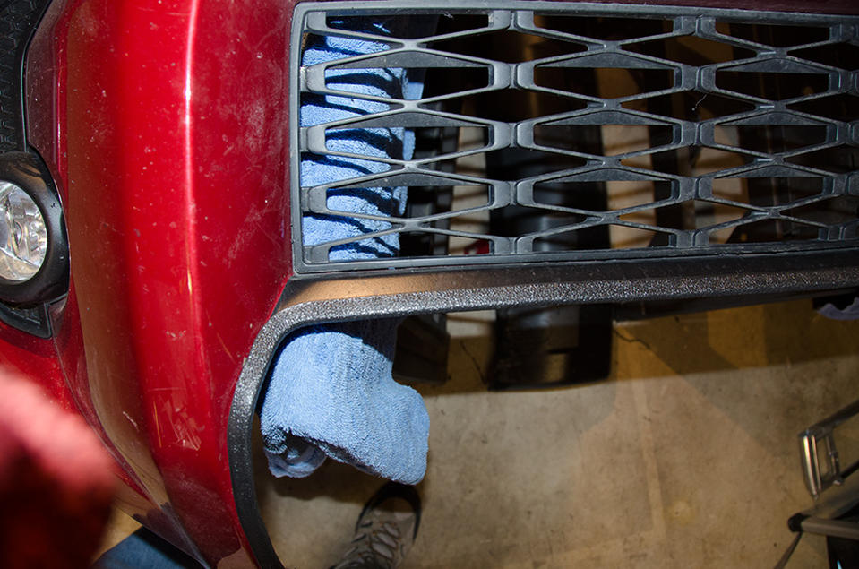

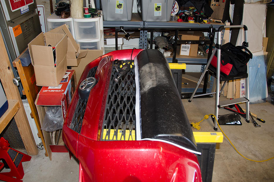

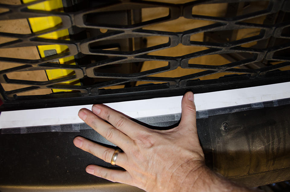

Taping on the template after cutting it out. This was a little confusing, the on line instructions do not really cover it, and it's only needed on a non-trail bumper.
So after cutting the template out. Initially I placed the top edge against the grill and taped down the lower edge (the cutting edge). But looking at a lot of other pics in the SSS bumper thread (http://www.toyota-4runner.org/5th-g...t-bumper-2014-sr5-trail**-18.html#post1825021) and the instructions, that seemed to be too high up. So I took it off and taped it with the top edge right at the bend in the front bumper piece.
SO here is where I aligned the top edge. And I did follow the gentle curve from end to end. Since my bumper was black I just used clear tape and cut along the edge with a dremmel with a saw toothed blade on it.
Underside cut. I used some pinstripe tape to guide from the first cut to where you just go down the inside curved edge leaving as much lip there as you can.
After putting the edging on. Fit perfectly. Be sure to really work it on down the sides over the small lip so you get it all the way on.

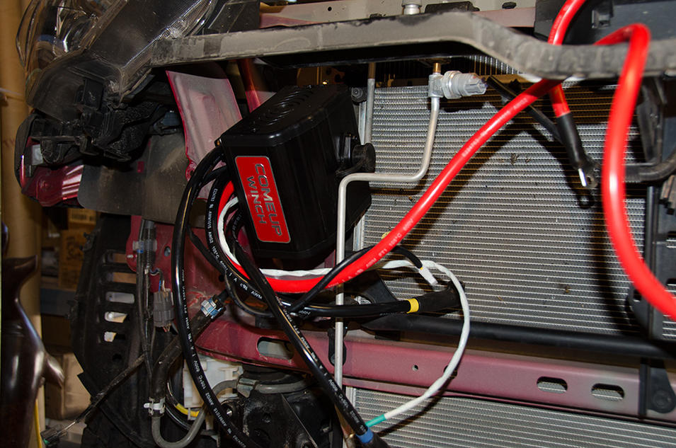

Before putting the bumper cover back on. This is the most logical place to put the control box. The strut there already has two holes in it in the perfect position.
Edit: In retrospect, I should have attached that white ground wire along with the thick battery ground to the winch before mounting the winch to the bumper. It was impossible to do after the fact. This means that the control box there needs to follow the bumper around rather than be mounted like here at this time. It would have been a LOT easier to simply mount this box with the bumper cover on then trying to attach all those wires to the winch with the bumper cover on instead.
