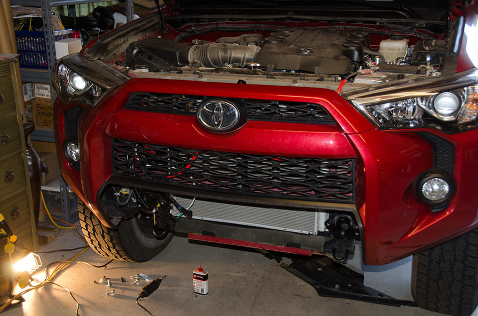

Bumper cover back on! Looking a bit less like a wrecked vehicle...

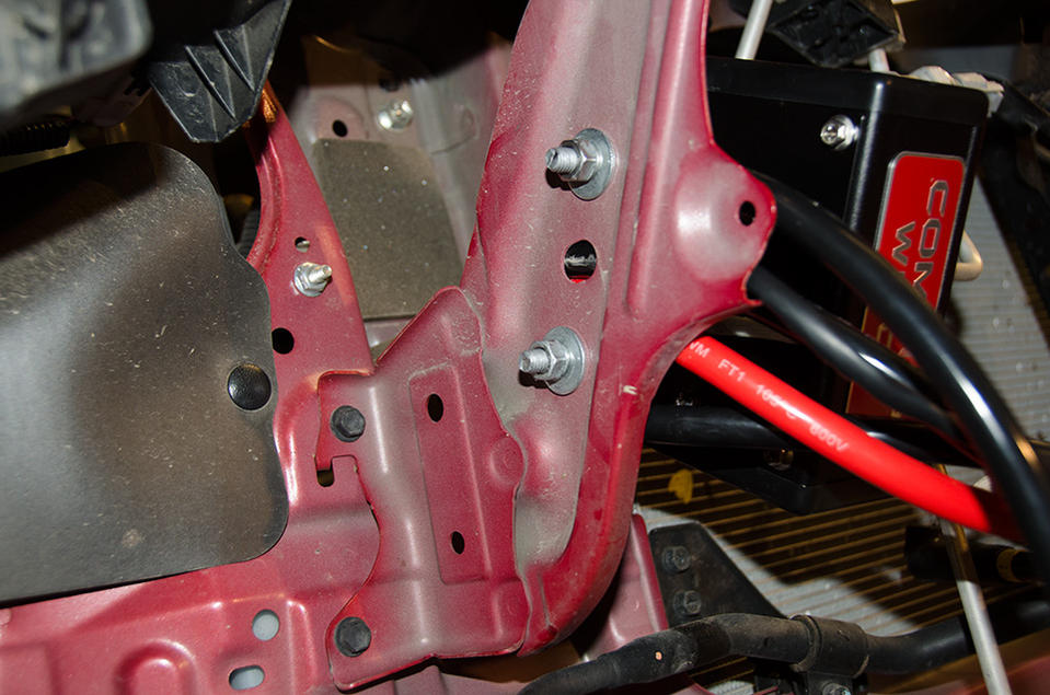

Installing bumper:

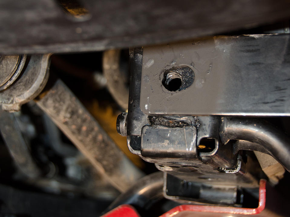

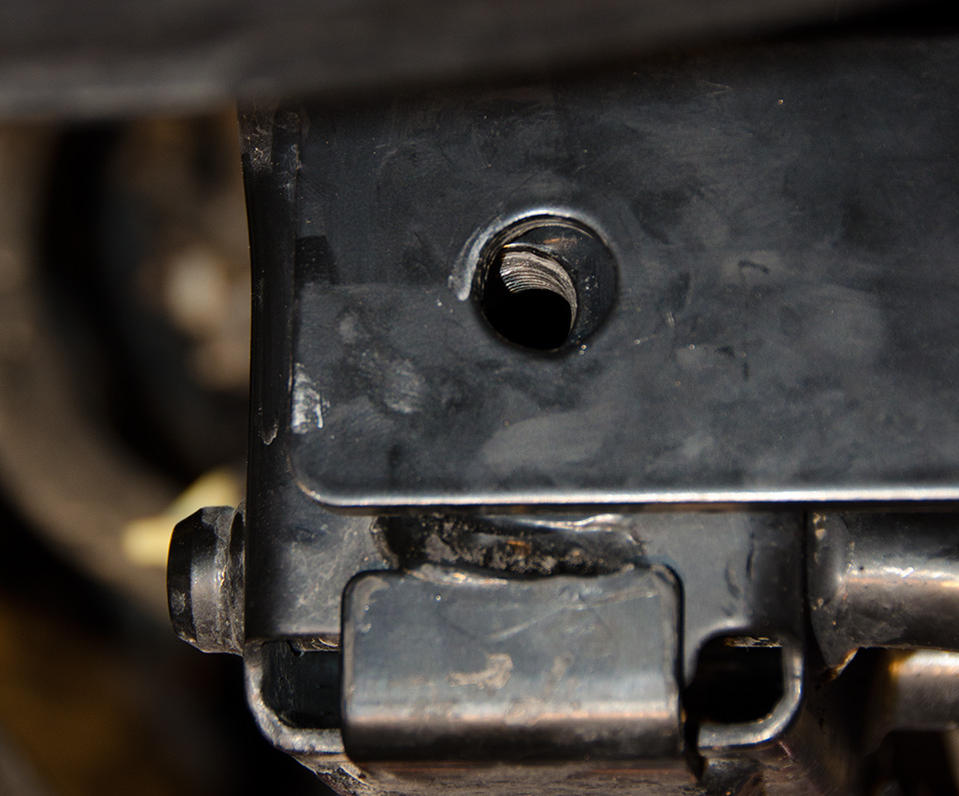

Tip: This is from [MENTION=105481]3wbdriver[/MENTION]. There are several threaded holes that may have paint or powder coat in them making threading bolts into them difficult. If you have a 3/8 16 tap, run it through the threaded holes to clear the threads before mounting the bumper. (Two on each side of the bumper and two on each of the bumper cover brackets that came with it)
I didn't get any pictures of this part because it took both people to do the work. I put a 1x6x12 in board on top of my floor jack, then a towel over that. Then we lifted the bumper onto it. Because the bumper is so front heavy, I straddled the jack and held it up while my buddy jacked it up high enough to slip the two mounting plate hooks over the frames mounting plate then lowered the jack just enough to hook them on (THANK YOU SO MUCH FOR THOSE HOOKS SSS!) Two people might even be able to manhandle the bumper onto the hooks without a jack, but the jack made nice easy going...

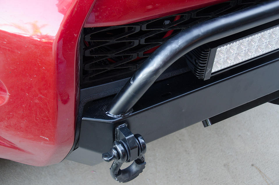

This was the second problem... ALL of the other holes aligned perfectly, but not this one. The quality and alignment of the bumper is excellent, but not all truck frames are perfectly identical. In the future, these mounting points should have slotted and slightly wider holes to account for frame irregularities.

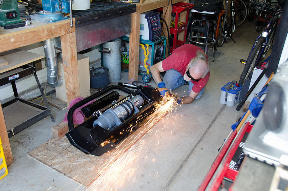

No bother, other than taking the bumper off for a second time. But any excuse to get out the plasma cutter is welcome :)
After looking at the picture I can see I kind of dodged an expensive bullet. I should have covered the winch spool, I could easily have ruined a $300 winch line. Looked at it closely and nothing burned thank goodness.

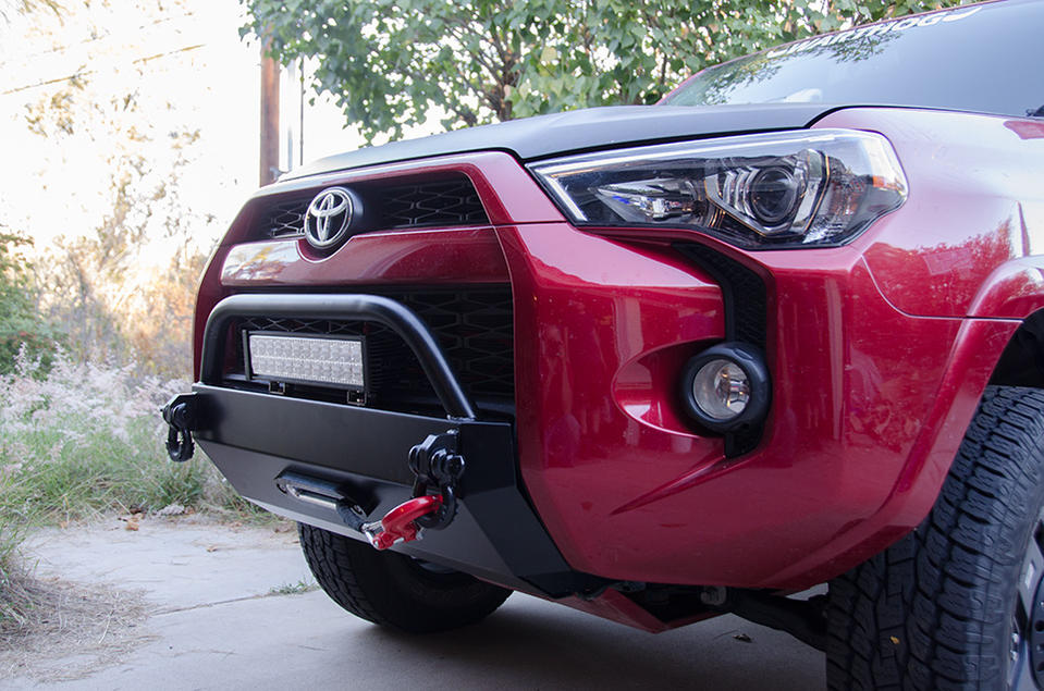

NOW it's aligned!!!

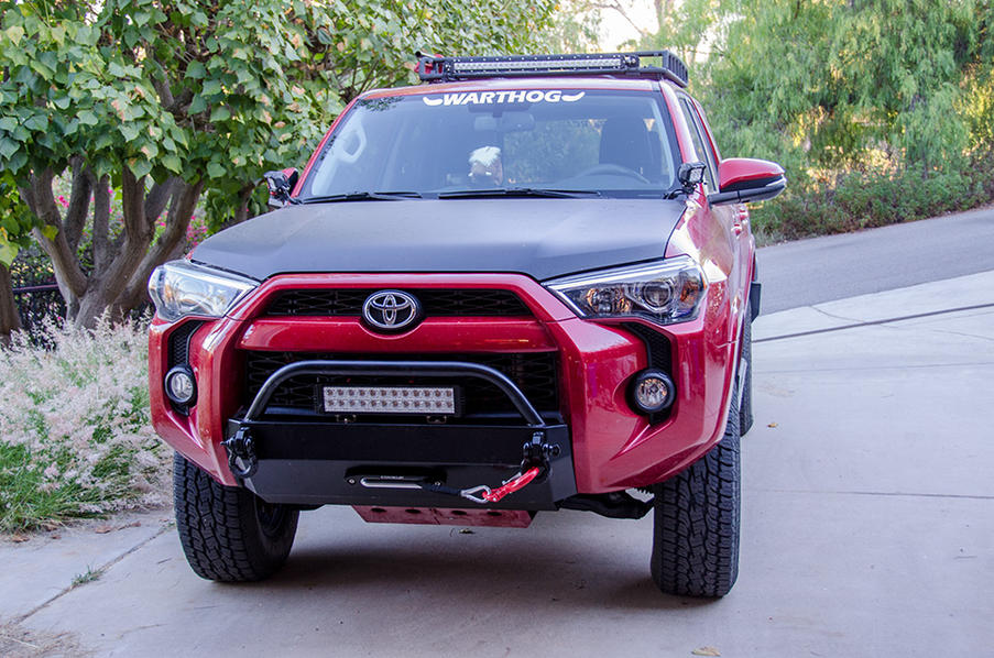

Viola! Looks freaking awesome :D
An upper skid plate, winch mount, light mount and tow points all in one little package.
Close-up of the cutout. The black on black hides it nicely thanks to my previously dipping that part of the bumper. (Pardon the copious smudges of anti-seize on the bar :/)
Now should I dip the upper bar too like the pro?
I got the light hooked up but some finish work on the bumper cover, the entire winch electrical hook up, remount the stupid license plate (looks so clean without it) and massive garage cleanup wait me tomorrow...

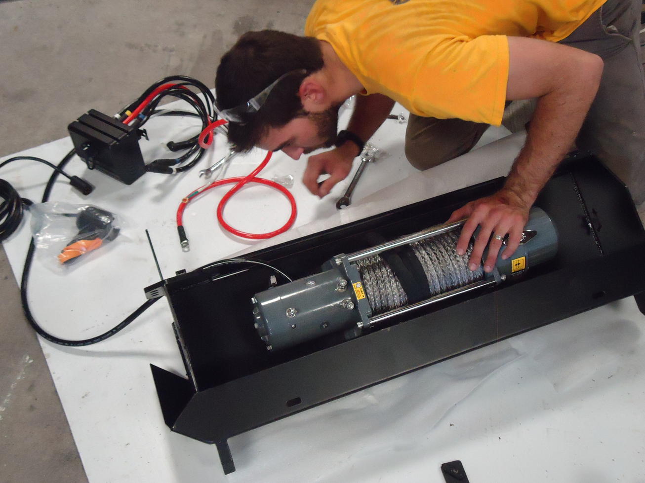

OMFG! (Bumper install adendum)
ARG! I somehow knew that wiring up the winch was going to be the near death of me somehow...
First, trying to get the ground cables attached to the bottom of the motor housing after being installed is.. impossible. But you can "clock" the motor, turning the threaded socket towards the radiator and get the two ground wires strapped on easily enough.
BUT, watch out. Instructions say to pull the housing out 5mm and you really need to make sure it's not any more than that! When I was moving the motor housing back to it's normal position, the weight and stiffness of the large ground cable caused the housing to move off the rotor entirely causing all the brushes to pop out of their holders making it impossible to get it back in place.
There was NO WAY with the bumper cover on to fix this. I wasn't even sure if I could fix it without taking the bumper back off. NOT HAPPY.
So I took the entire bumper cover back off and thankfully there was plenty of room to work on the motor. Using some zip ties I compressed two of the 4 brushes back into their holders, then using two fingers I could press the others in and get the motor housing back on the rotor. WHEW.
When I went to put the cap back on the back of the motor though I couldn't see the little wire with the white connector that was supposed to be coming out of the bottom of the motor. It was just GONE. Did I accidentally shear it off turning the motor? Where was it? ARG #2.
I looked all over and finally got out a flashlight to look inside the narrow space under the winch mount plate and sure enough there it was, doing it's best to hide from me. And thankfully nothing sheared of. It's just a little temp sensor on 2 inches of wire and a connector. Completely self contained. It fits into a rubber grommet in the motor cap.
Well with the motor all put back together, having the bumper cover off made it REALLY EASY to finish up the wiring!!! In fact I have an install modification to suggest:
TL:DR - Do not install the bumper cover until you are completely done with the bumper, winch and light bar install! Install EVERYTHING and then put the bumper cover in last. It just takes a little careful wedging and it slips right in behind the bumper and all other installation steps are 10x easier that way.

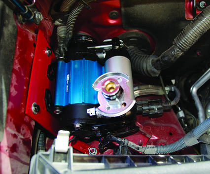

I bought the high capacity plenemed ARB air compressor for airing up tires and a rear locker. Not planning on running tools so the twin seemed a bit excessive :)

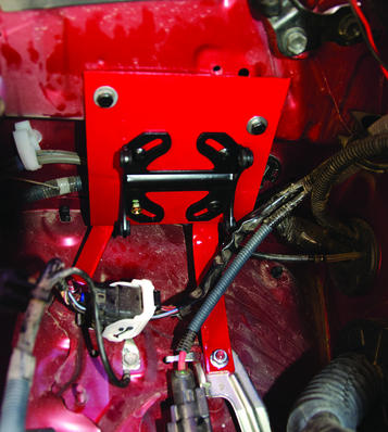

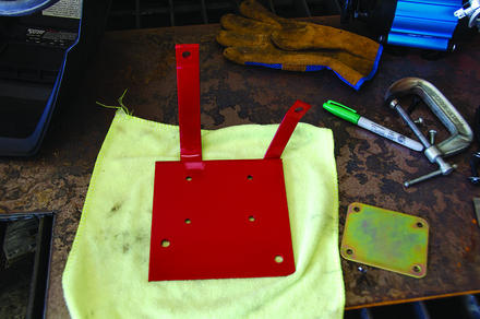

Had to fab up a bracket and was able to use 100% stock mount points in the engine compartment.
Bracket cut, welded, drilled and painted:
Installed:
And with the compressor:
Astute viewers will notice I haven't hooked it up yet :D Will have that done after lunch. Also, in the future when I'm looking for another little project, I'm going to run the air line out to a socket mounted on the rear bumper or somewhere so I don't have to even open the hood any more...

Just finished up the wiring, Whew! :clap2:
Took about 2.5 hours including having to remove the airbox completely. ARB includes an amazing wiring harness which is awesome, but while the spot I chose to put the compressor made it easy for me to make a bracket and mount it, it was as far from the battery as possible and the ARB harness was just /barely/ long enough with some really careful threading from one corner to the other. Under the air box, through the front and along the top of the radiator cross mount and out to the battery. I followed a bit wire bundle that was already there so that should be perfect.
Then I ran the switch wire to my POD across the big wire bundle on the firewall and used the POD to ARB wiring harness I got to control the compressor and eventually the rear locker.
Worked first try and seems to be relatively leak free. It stopped running after a couple seconds due to the plenem being full. 10 minutes later I turned it on again and the pump did not turn on, it was still under pressure. Hope it's ok to leave it like that. :suspicious:
