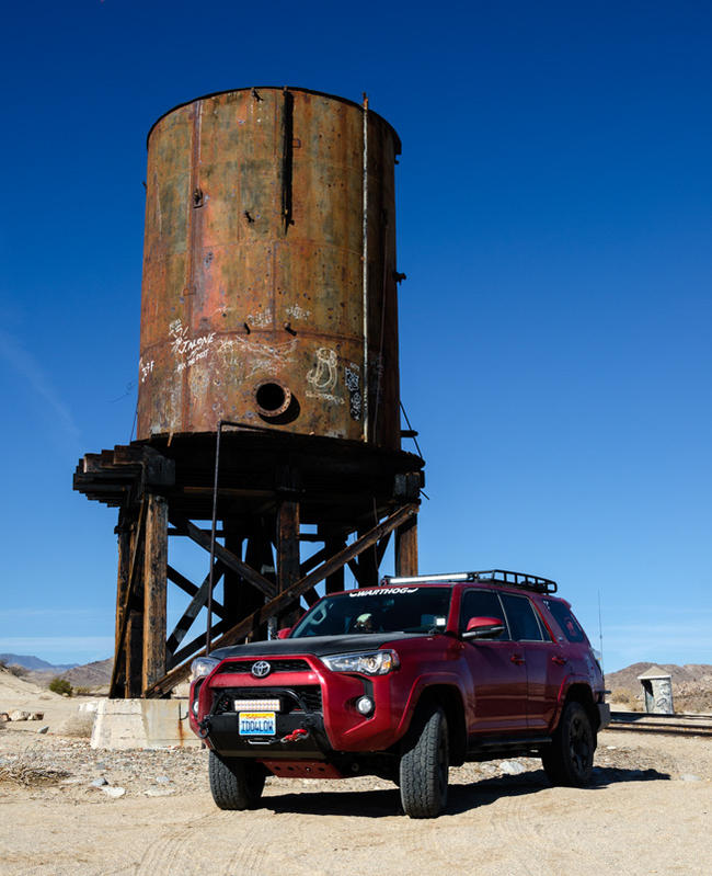

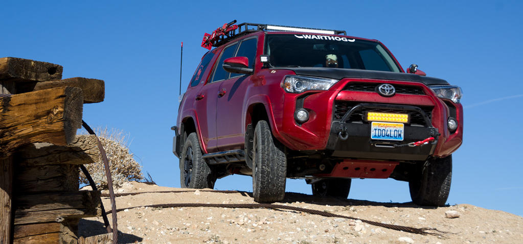

At Dos Cabesas I got a new avatar picture and an update of in front of the water tank...

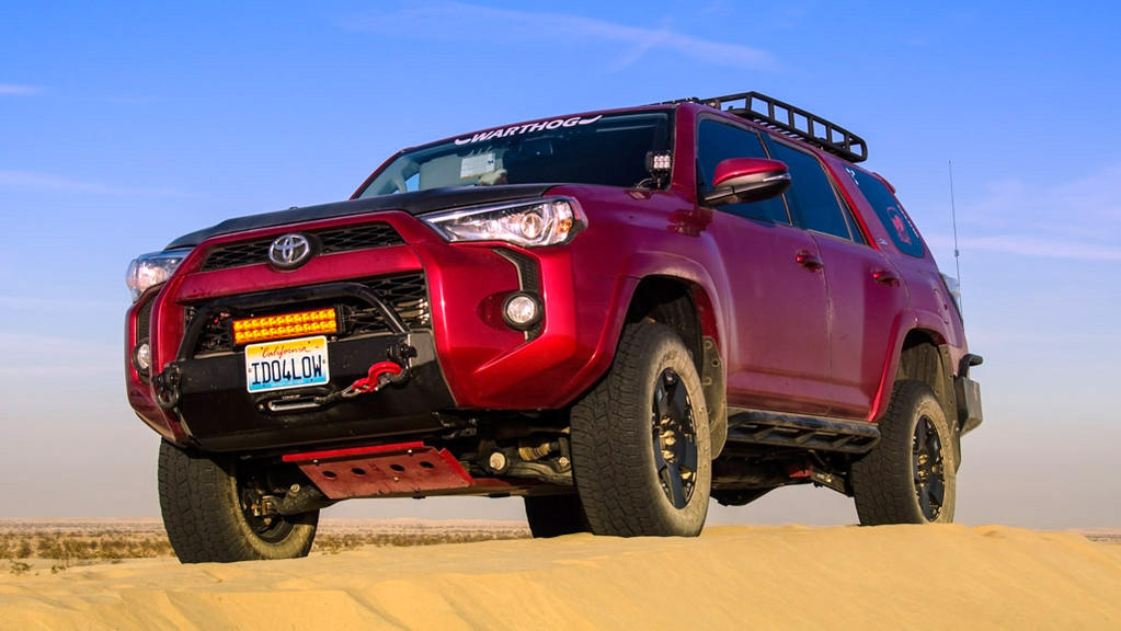

Here's a beauty shot of the dusty, dirty and mean Warthog at Superstition:

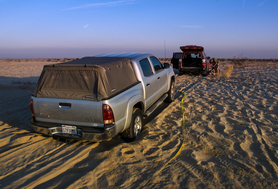

So then the sun was going down and this was just a day trip. Started heading to Huff road, took a sandy side trail that went by one of those big wooden pyramids all over out there. Then I continued past and the sand got REALLY deep suddenly. I pushed through but the 2x got stuck good. No problem, I'll just pull him out like before! Ooops, sand to thick, now I'm stuck too! :doh:
Funny thing, with a 2x only 2 wheels get buried. With a 4x all four get buried!!!
So I start digging my tires out and lowering the tire pressure...
Nice soft sand is easy to dig out anyway :) With the low tire pressure I back right out of my predicament, but now how to get the 2x out?!?
Turns out that about 80 feet or so behind the 2x was a relatively solid piece of ground, so I parked there and used the winch to pull him backwards. Took two winchings with me backing up in-between to pull him back far enough to get out.
This pic is near the end of the second winching.

Damn that bumper winch mount setup is awesome!!!! Looks so good. Will most likely be my next upgrade after sliders. Sorry if you said this already, I just spent a ton of time on your build thread, but might have missed it. How much weight does it add? I would probably go with a 50lbs winch. Any issues so far? Still happy you did this instead of a full bumper? I love the looks (and I assume the weight), but thinking about approach angle.....
The bumper itself had a shipping weight of 60 pounds. I didn't measure it but I'm sure that's pretty close. The winch with the rope and wiring is 72 pounds.
One of the reasons I went with this bumper was that it was pretty light weight. But the two togeather is noticeable. I may have to beef up my front coilover springs to accommodate the larger battery, bumper, winch and skidplates. which add up to over 200 pounds of added font end weight!
Yeah it's sort of an interim offroad bumper. At this point I plan on seeing if the approach angle prevents me from doing something I wanted to do. I am probably going to trim back the lowest part of the plastic bumper in front of the tires some for more clearance there (Except the stupid windshield washer reservoir is right there on the pass side.
In the end I don't think I'm going to go full rock crawler with in within the next 10 years if ever :D I just wanted a really nice capable expedition type vehicle that can go pretty much anywhere and be self reliant.

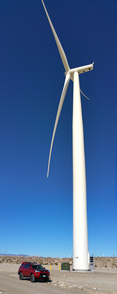

THESE THINGS. There's like 50 of them ALL OVER the lower borreco/ocotillo area now. Almost completely surrounding Ocotillo. Those people that lived there and had clear and vast views of the desert are now hemmed in by these giants. Kind of made me think.. What exactly is "Green" or "Eco" about these again?

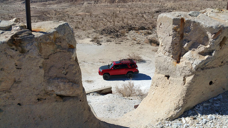

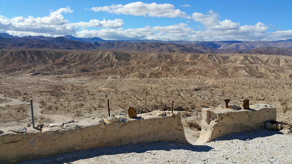

Headed over to the old calcite mine area. I didn't think I'd been there before but when I arrived I had a distant memory of it come up from the depths.

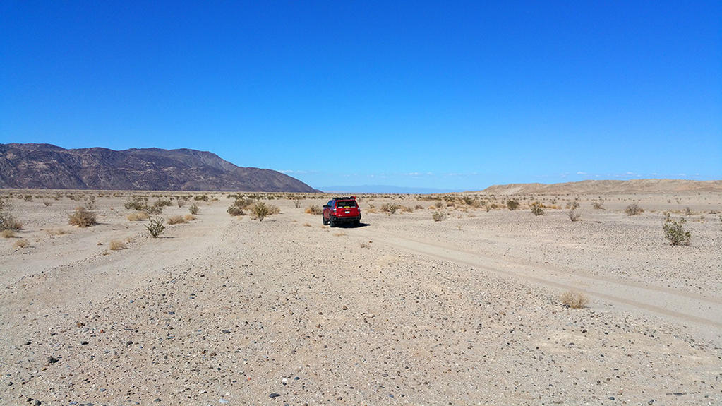

Half way through I decided I was tired of it and tried cutting across the Stage line trail to the west since I'd never gone past the swamps before. Unfortuantely after a few miles the route was closed due to "unexploded ordinance" :( Had to head back to the Woops road and continue north.
After a while it became a wash and it was all high flying fun till I got to the tip of the Corisso range ( dark mtns on the left in the above pic) and crossed under the plaster city RR trestle. From there I headed SE along a pole road. 100% sand, fast and fun with occasional break slams :D

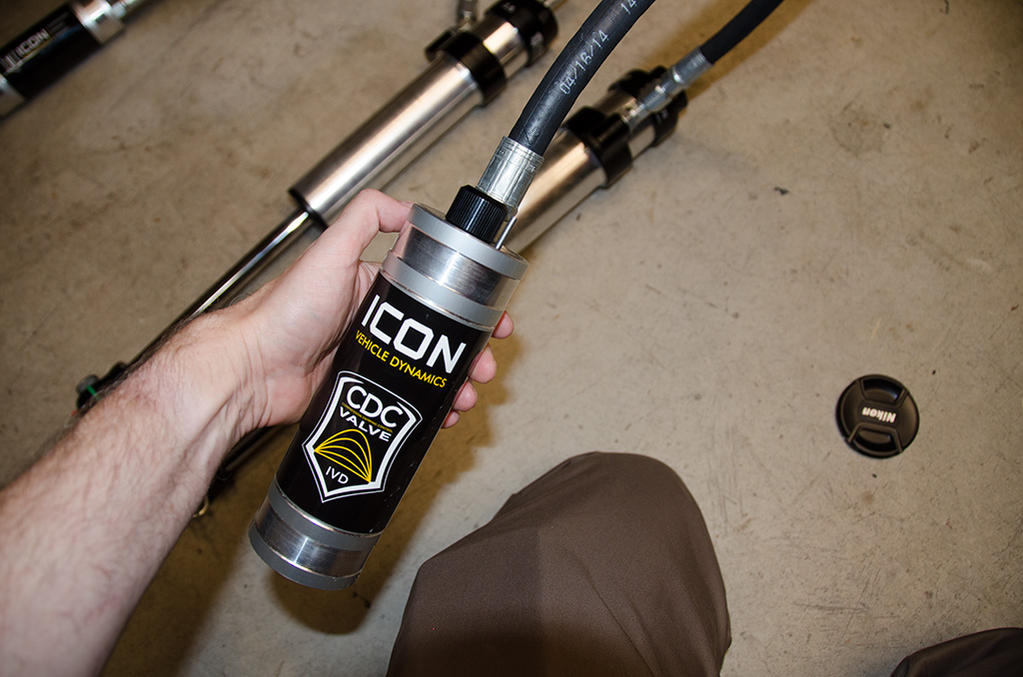

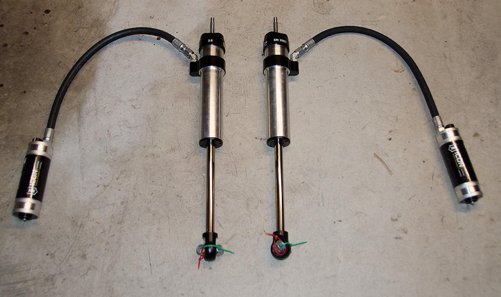

This came in the mail today. A present for the Warthog. 1/2 of my black Friday purchase from Wheelers Offroad. A pair of icon adjustable rear shocks yay!
These will replace the billies I've been beating up in the desert for the last year. Hopefully get them on this weekend...
As soon as the other half of the order comes, a set of UCAs, my suspension will finally be complete for the time being.

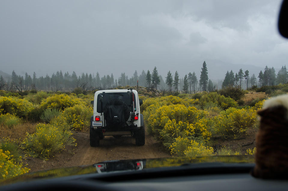

The next day, most of the campers were packing up to leave or hanging out enjoying the warm morning sun
before heading home. Just four of us were willing to brave the impending thunder showers that were called
for due to a hurricane down south.

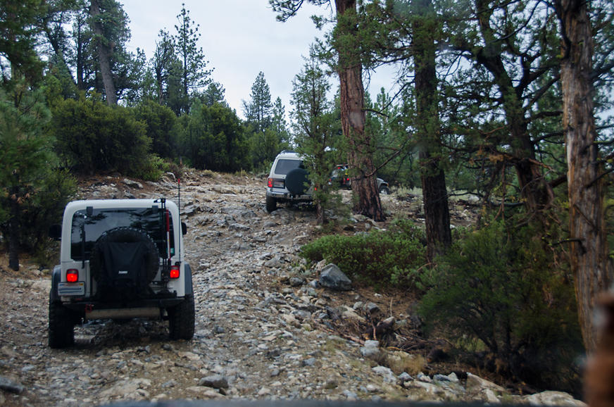

The brave little crew of 4, one 4runner, one land cruiser and two jeeps, head off for the peak of White Mountain
and then down into Johnson valley.

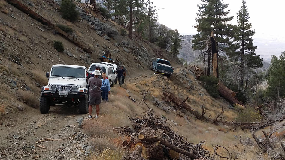

We reached the edge of the mountain where we could look WAY down into the valley below. Trails went off in all
directions. There were a couple of Forest service trucks also parked there and they told us that they didn't want
us going down this little sketchy mine road because there was a stuck truck down there blocking it.
The truck we with them but not a forest service vehicle so they were not allowed to rescue it themselves.
A professional rescue in that precarious location would have been super expensive. Brian in the Land Cruiser
didn't hesitate for a second to offer assistance. So he and one of the Jeeps made their way down this super
narrow, shale covered "road" that winded down a gully. The truck was stuck to the axel in the soft roadbed
after a rear tire slipped over the edge the night before.
The owners of the truck were not there and we weren't allowed to actually touch it till they showed up, but
we spent the time figuring out how to get it's rear end back on the road, fortifying our trucks to keep them
from sliding down the road etc.
The owners showed up after a half hour or so and gave permission. Using the winch itself just pulled the two
trucks down the steep/slippery road. But letting the air out of the truck tired and trying to drive it down hill while
holding on the winch together got the back end up on the road.
Turns out the truck owners were Bat researchers invited out by the forest service to survey an open mine with
a colony of bats in it.

The trails were all instantly lakes and rivers. But the soil here is all DG, no clay so was just really watery sand, no mud.
The rain eased off to a light sprinkle as the cell moved on, it got quite beautiful and quiet. We got to the

One of the rangers was really into it, was also an Expedition Portal member. He gave us a little tip on a
nice trail to take since our main plans were kind of interrupted.
So another couple of hours in the cool 60 deg air and moody clouds with the windows open, heading towards
Big Bear lake on SN16 and SN08. Was quiet and the sounds of the tires on the wet rocks and gravel was relaxing.
Your going to LOVE those CDC adjusters!
Well my plans for installing the rear shocks this weekend were kyboshed by Icon forgetting to include the upper post mounting hardware :(
I called Wheelers who I ordered them through and they were awesome about calling Icon and getting a set of mounting hardware set out to me same day. Yay to Wheelers! And well yay to Icon for being super responsive anyway :)
I did finally get around to adjusting my coilovers since the bumper/winch install, and well the skids too. All that junk was weighing down the front end dropping me about a full inch!
I got myself back up to 2.5 inches of lift again, looks awesome. I think I would rather get some 700 lb springs for the front but I gather that people find rather stiff unless they have like a full on front bumper and heavy duty winch.
So I guess the 6 to 8 turn crank down will have to do! I currently have about 1 3/4 in of threads showing on the driver side and 1 5/8 on the passenger side. Not too bad I guess, ride still seems smooth.
