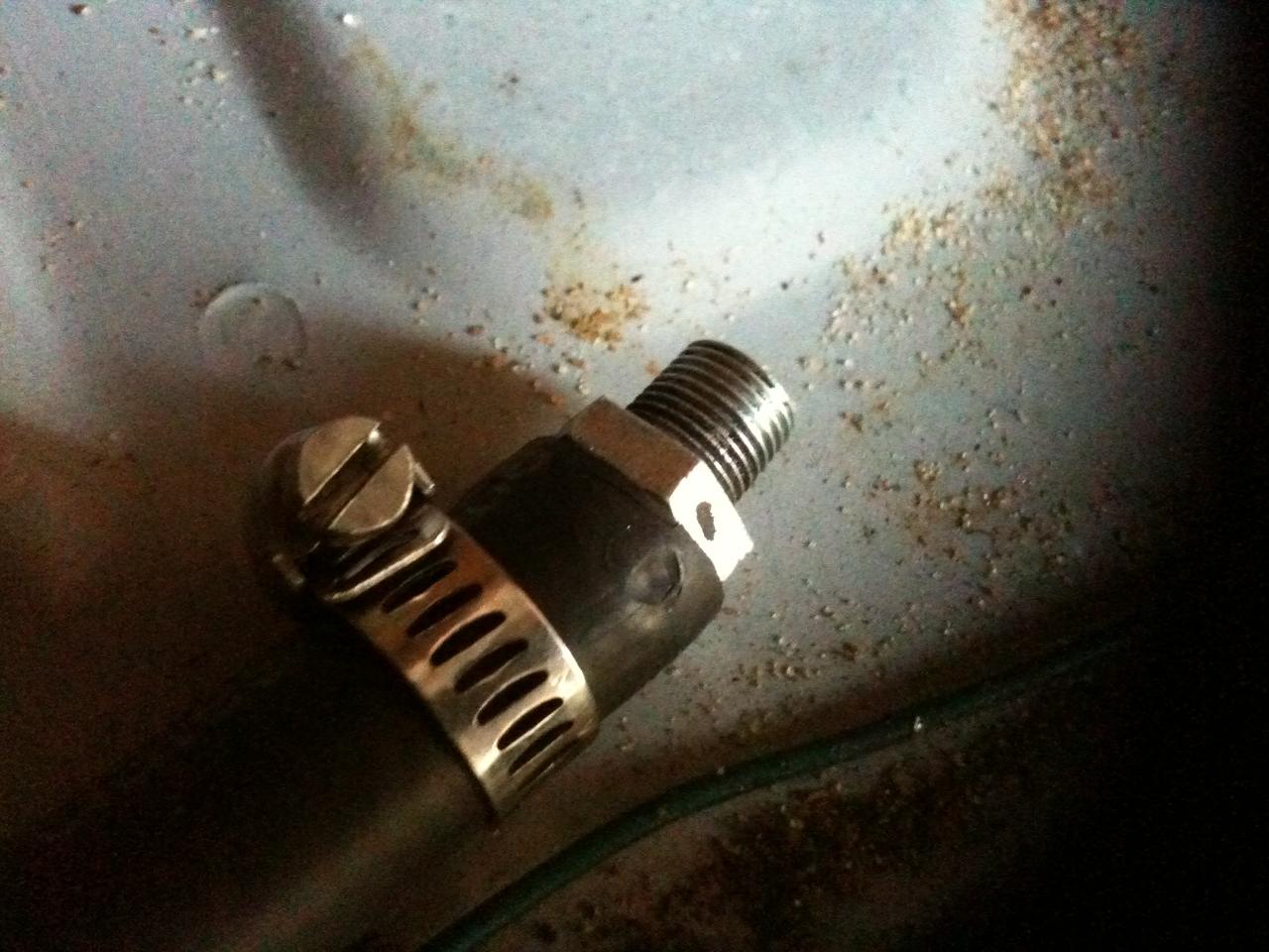

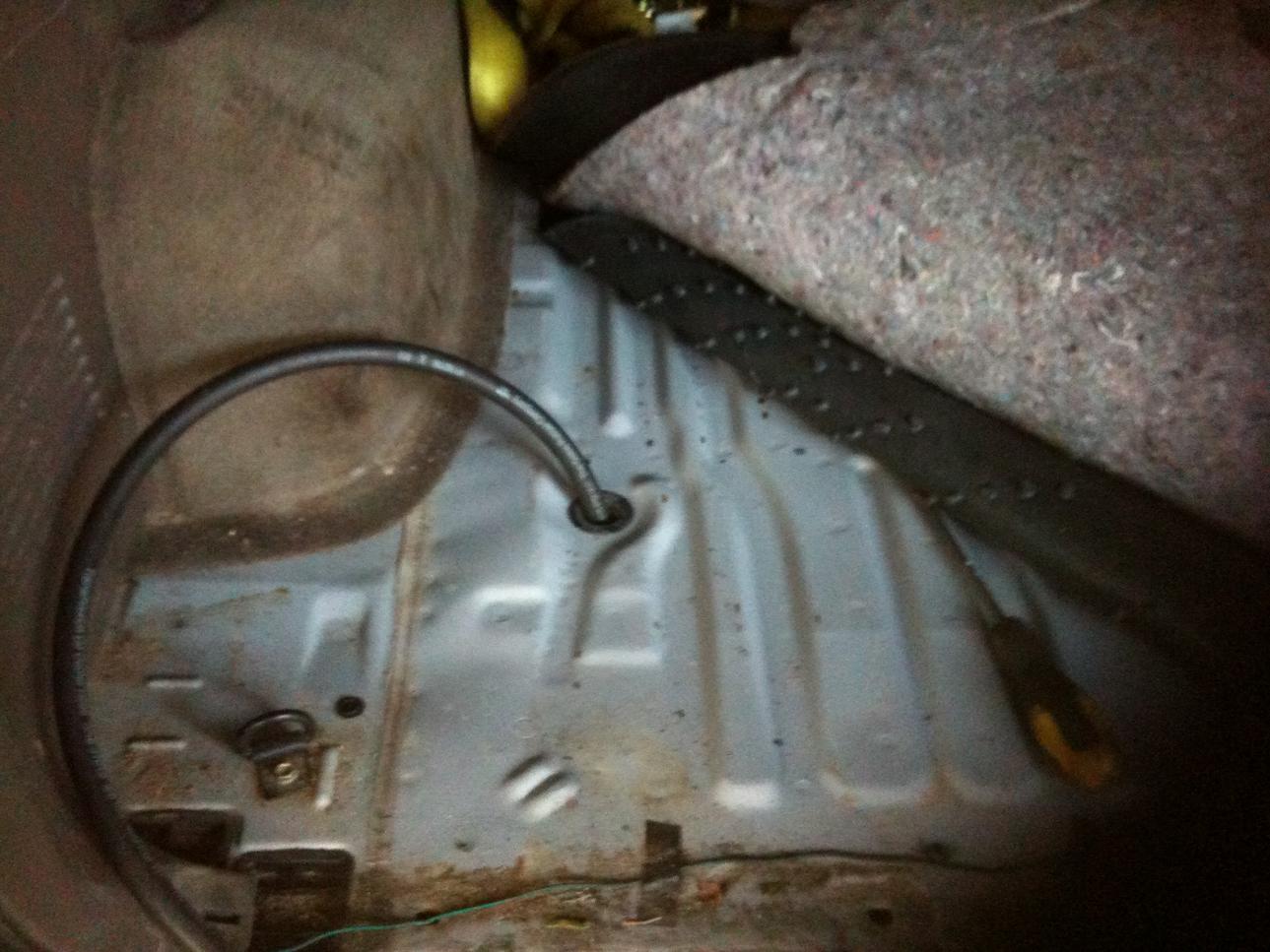

Here's some pics of my rear diff breather ran into the cab through one of the rubber grommets in the floor. I used the existing breather and removed the cap, spring and seal. Then connected some spare trans line to it. Drilled a hole in the grommet and shoved the line through. It's temporary but works well. When I Rhino Line the cargo area Ill bend some hard tube from there to a higher location.
