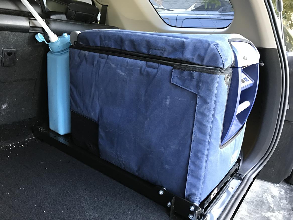

Yep, these fit perfect in the cupped side areas behind the wheel wells. Sometimes between grocery stops I cut holes in the tops and fill them up at a campground then duc-tape the top closed again. I've searched for another solution but have yet to find something that justifies the cost and space any of those solutions will occupy.
I'd love something like this that fit in that same area:
https://youtu.be/rmCBigYcVv0

Oh yea, ARB makes an extended fridge slide as well. If you are or plan to run an ARB fridge with your storage system this could be an option, allowes you to carry among many things a 5 gallon water can behind your fridge. I run it with no complaints and fits a water container with the second row folded up.
http://www.arbusa.com/uploads/PDF/newProductAdvice/2014/ExtendedFridgeSlide_Retail.pdf
[MENTION=96425]JSparky[/MENTION] - Cheers! Much appreciated. Those water cans look solid.
And re-extended fridge slide - that's essentially what I'm aiming for. Given, though, that these are non-pressurised systems, I think I'll have to reevaluate the positioning of the tank. If I get the rectangular option, 15gal I believe, I think I might just mount it on top of the storage system "longways" - that way it might be more accessible for the "there's still some left in there; tip it forward!" moments, lol.
