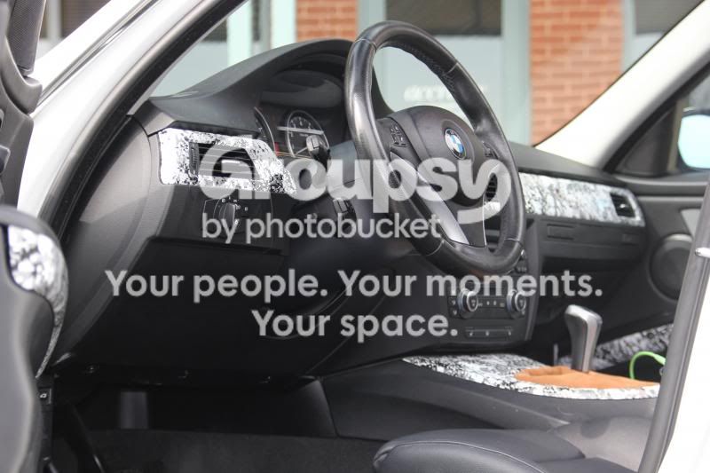

I had the interior of my bmw done in urban digi camo. This is the place that did the work. The pictures of the lexus is my buddies car. he had his engine covers and calipers done. the calipers are black with a gold carbon weave. engine covers are a grey wood grain and black wood grain. My interior cost about 300, which was the dash and all the door trims.

not the greatest picture

BTW, interior looks very sharp Scott. I like the contrast!
