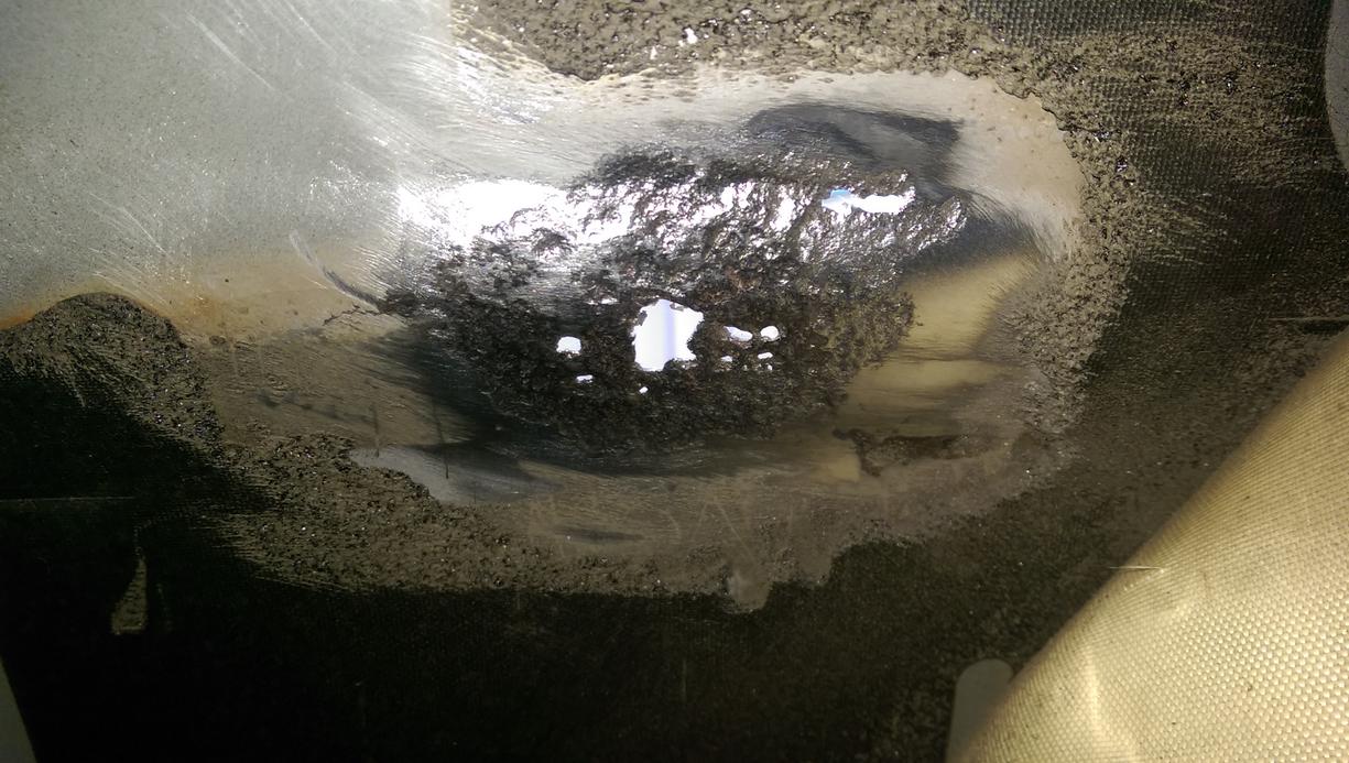

I'd pull the plastic back and take a good look at the back side of your hatch for rust.
I had some rust bubbles peeking through the exterior just south east of the license plate and discovered a much worse problem when I wire brushed some of that stuff off. I wound up wire brushing/sanding/priming/painting a palm sized emerging rust patch back there.
Damn rust comes from the inside out...

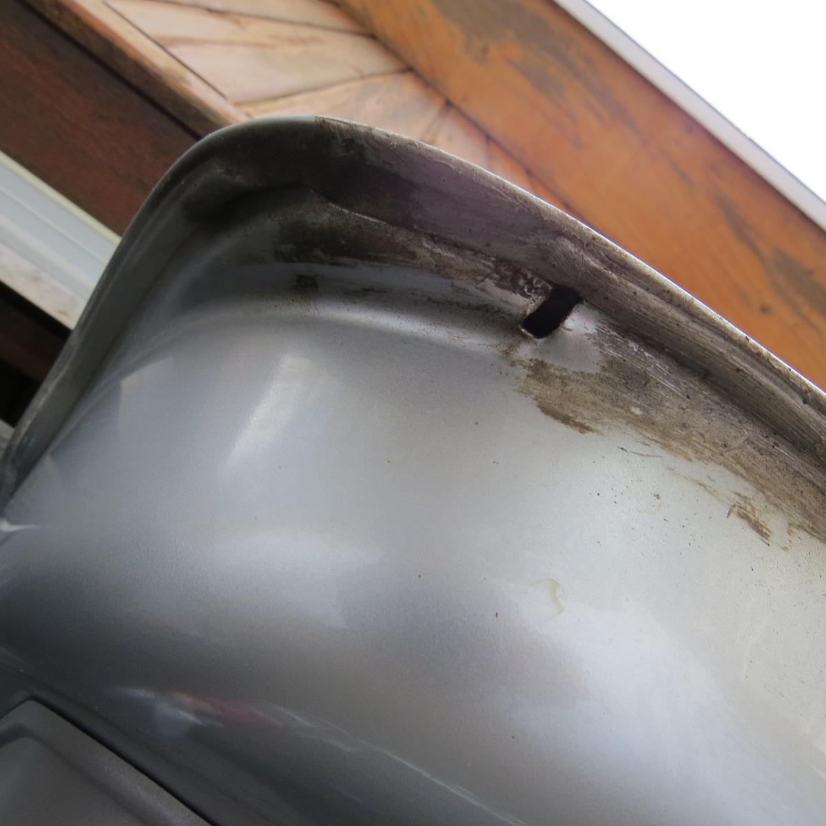

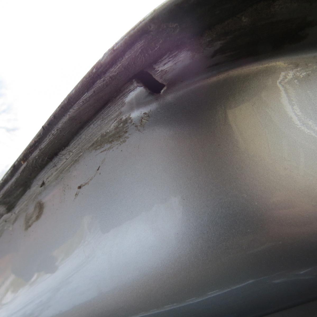

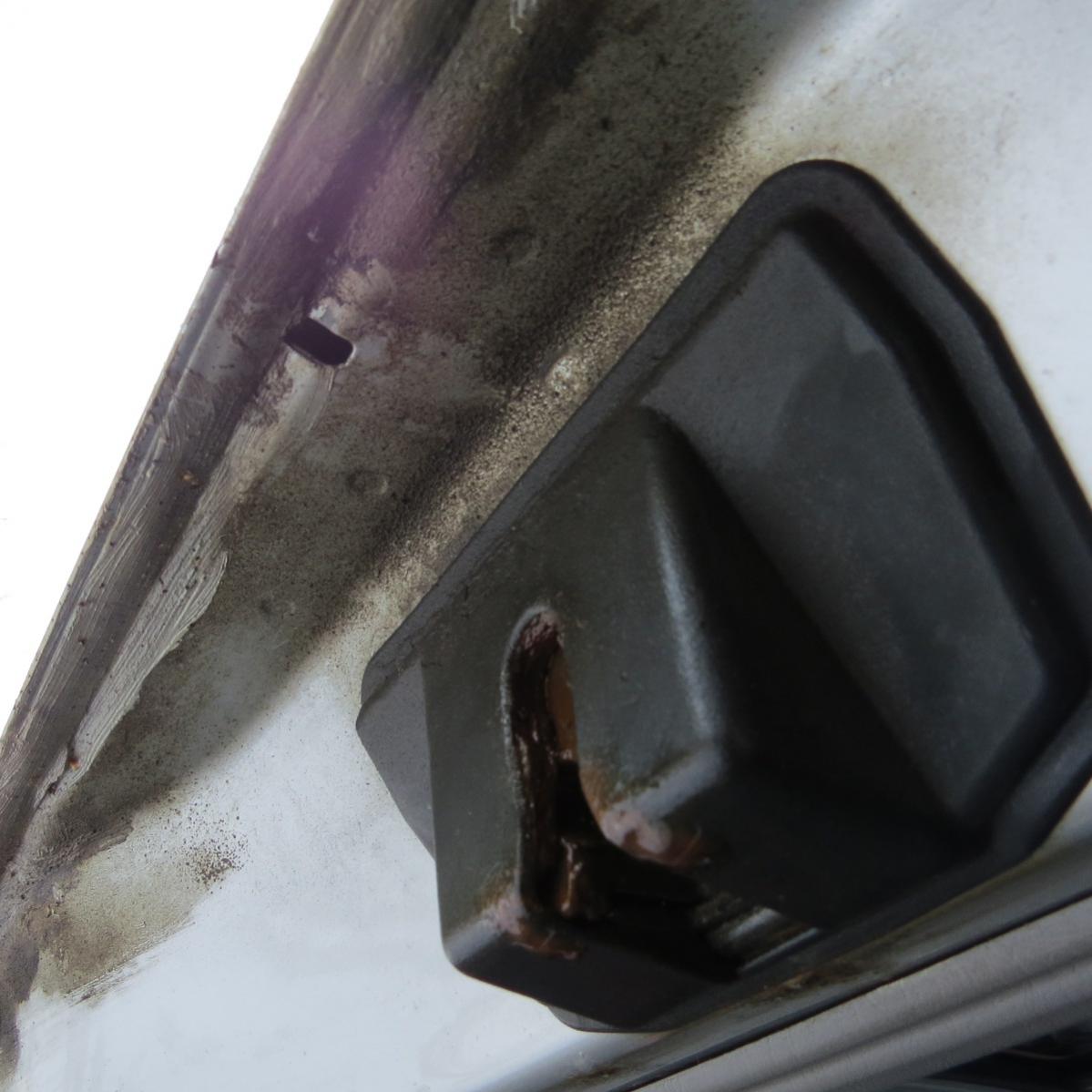

Couple pics of the two little plugs I removed from along the bottom of tailgate. Totally plugged, probably from deteriorated coating. Tailgate was carrying quite a bit of water.
THose are the OEM/original drain plugs, they aren't solid rubber, they are designed to let water drain but also to keep bugs/spiders, etc. from crawling into the hatch.
Replacement OEM drain plugs are a little different but still do the same job.
There are 3 drain holes at the bottom of the tailgate for water runoff. One in the middle and one each at both ends. I've never bothered with the rubber plugs but had always made sure these three drain holes are clear. There are similar drain holes for each of the vehicles doors. The weather stripping at bottom edges of all 5 doors' w/movable windows are not designed to keep out 100% of water/rain, hence the provisions of these drain holes which are located at the lowest points of each door.
The 'dirt along bottom edge of tailgate is 'white' grease to ward off rust from salt infested road in winter.
