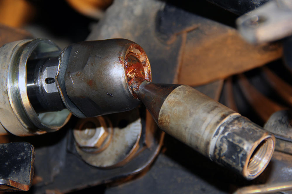

Well, My inner tie rod completely failed today

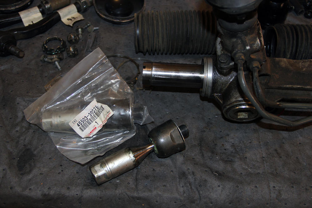

Here's the old one. I knew these were pretty much shot. Every time I turned the wheel I could feel a clunk. Threw it up on a lift and grabbed the tire and the ITRE had so much play in it.

So I was looking back through my thread and I found that when I got the steering rack I also ordered new oem inner tie rods for it as I didn't want to take any chances with what came with the rack. So it turns out that it WAS a toyota oem inner rod that broke. I guess I can't blame it on cheap aftermarket parts after all. Pretty scary
Wow, that's alarming!
I'm sure its been said, but as much as an inconvenience as it is, at least it was low speed and didn't cause an accident!
Well that sucks!! Even oem parts fail. My buddy had a new OEM LBJ fail also. I had a new oem ubj fail.
A brand new lbj??!! That's scary. Seems like most lbjs fail at slow speeds while the wheel is turned, which is good. But it's not to think about it failing on the the highway at 70+. I just don't think these front ends like being lifted.
Are you sure that's an OEM part that failed? In your first post of the failed joint, the grease appears black and the ball socket (the part that screws onto the steering rack) is black metal. I recall the OEM joint having a grey metal socket and red colored grease.
Well, according to my records they are oem. Looking back I do remember changing them when I bought the steering rack cause I didn't want any cheap crap on my front end. I will compare them to new oem inner rods when they get here from Japan. Are there any markings on the oem rods that you know of?
I don't remember the OEM ITREs having any markings. They actually look almost identical to the Sankei 555, but the OEMs have a red grease and the Sankei is yellow. The Sankeis also have a distinct 555 Made in Japan stamping.
But who knows, maybe different model years use different suppliers. I know the steering rack guide design was changed in 2000.
