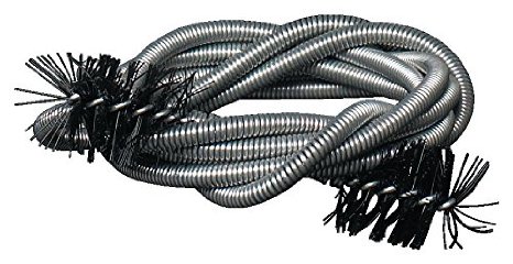

I hope the leak issue is history. I used a trombone brush to probe a hole (under hood hinge) which seems to be directly above the kickplate wiring area which is where i saw the water streaming down. So I put a rubber cork in the hole. :)
FYI, The trombone brush is THE tool to use on a 2006 and newer Miata MX-5 to rod out rain drains.
