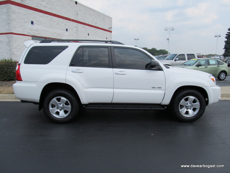

Your comments are greatly appreciated. This is a picture as it sits, stock. I have not bought anything yet until I hear from the experts.
Best regards, Doug

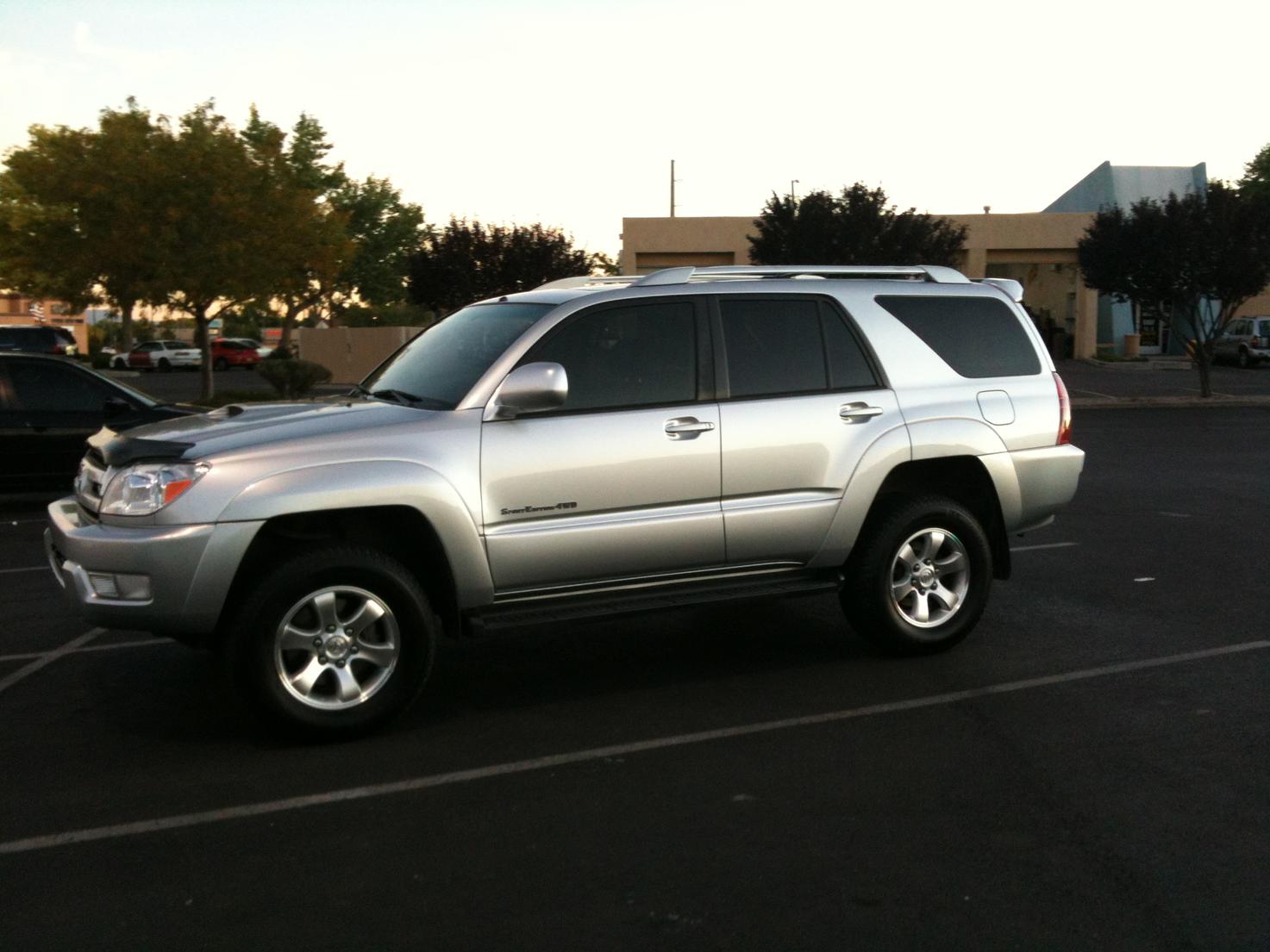

That the exact set up I have on mine. I put the 1" spacer lift on the front and then decided I wanted to get the back up a little so I put on the 1.5 Rear Spacer. I love the lift and still have a tiny little rake to it. Maybe a 1/2" or less.
Here is mine
IMAG0465-1.jpg~original
Ryan,
That's looks great man. I can tell a lot of difference and it's great to see an actual picture of this set-up. I've been looking for weeks and haven't seen this. Thanks so much for posting. I am going to hit the send button on my purchase :-). There are so many cool mods on this site, I am anxious to start doing something. Hopefully the purse strings will loosen next year lol.
Best regards, Doug
No problem. Not bad for $80!!! HA! Good luck and make sure you post a pic when you get done....and trust me I got the MOD bug a while ago and have slowly been getting things done. This site has great people on here and they help out so much. Best of luck!
