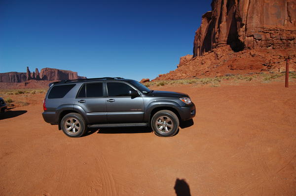

Only pic I got of it, but why not with some nature around it :)
1' front spacer so far.
Cool scenery, where is that? Doesn't look like California Rig looks nice too. Snowing here tonight and cold as a frog.

Thanks. It's in Monument valley on the Arizona/Utah border. I took a trip to the southwest over Thanksgiving, it was cold at times but no snow or rain. 4Runner did great.
