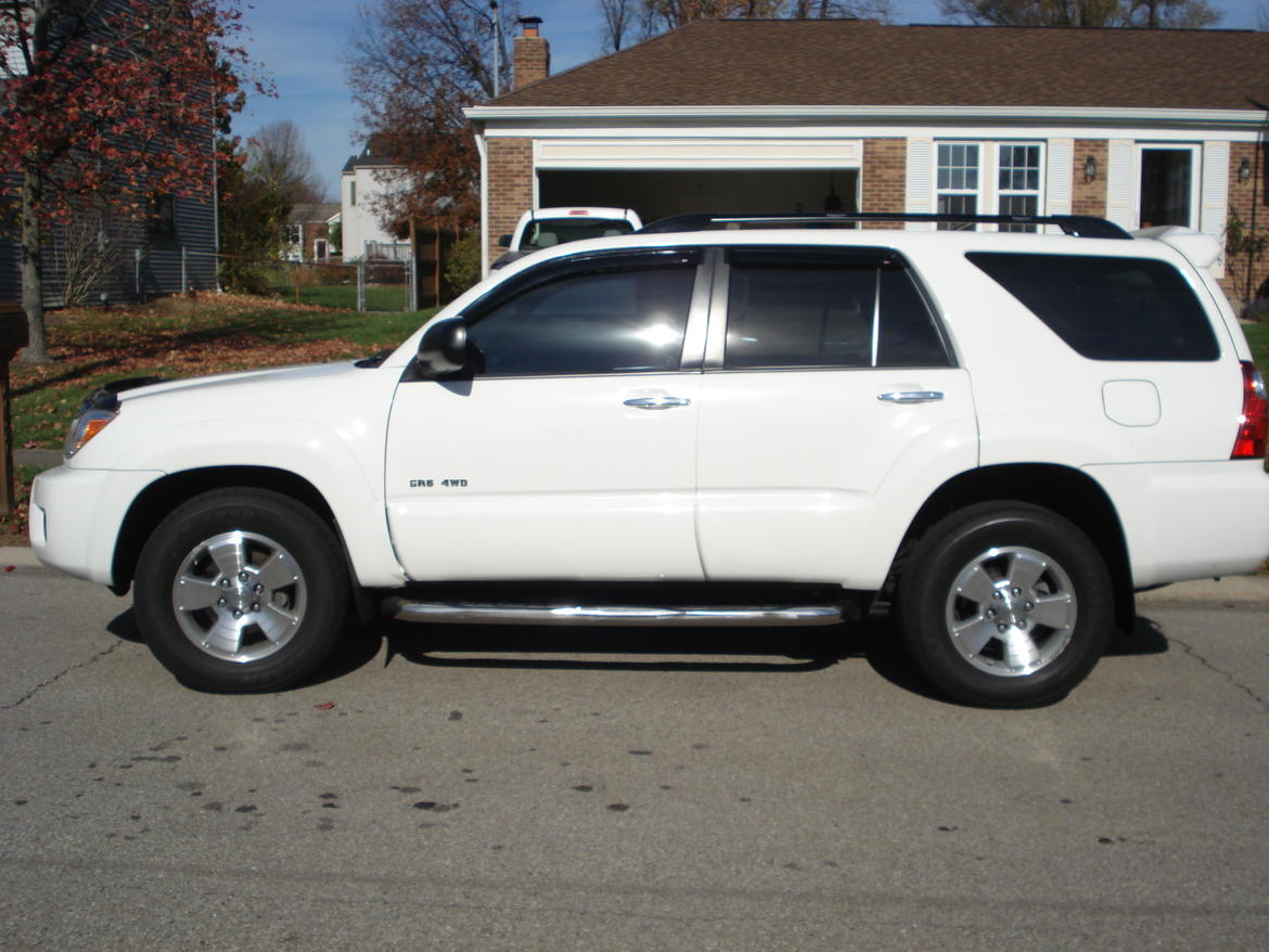

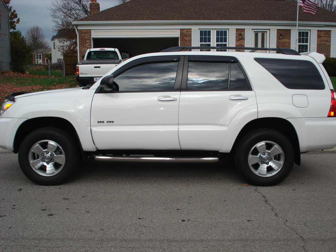

Finished Side Pics Before After
Well, took it for a test ride. Everything seems to sounds and ride correctly. Whe I first let it off the jack, I had about 3" of lift. After driving a few miles, I am right at 2 1/4". I started off at 18 3/4 front center of wheel to fender. Now I am at 22 even on both sides. Doesn't look bad as is, but seems to be sitting a little higher in the front. The rear measures 22 1/2", but visually I can notice it. I'll send notes and other pictures later. I still have to police (military term for clean) the garage and get ready for the football game today. Pittsburg Steelers vs The Bengals, big rivalry and for 1st place.
