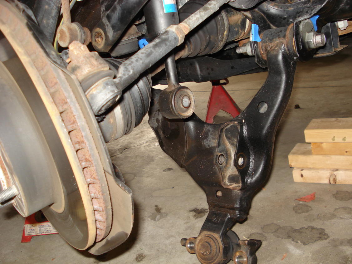

"Looks like the tube step is lower in the rear, and the roof rack as well. Still plan on doing the rear? Congrats!!!"

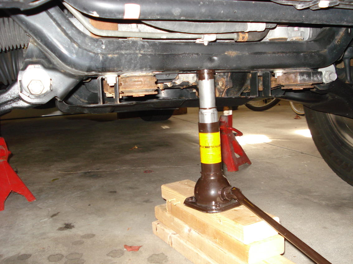

- If using OEM jack, you will need (4) 2x4's under neath it (~7"). Especially when putting the tires back on. The hubs will be lower, you'll need to raise it. (pic-1)
- If using a floor jack, make sure it goes that high.

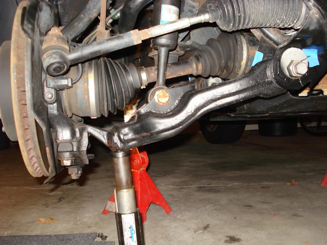

- If you have a small bottle jack from another vehicle, you'll need it to push the Lower Control Arm (LCA) back into position. (pic-5)

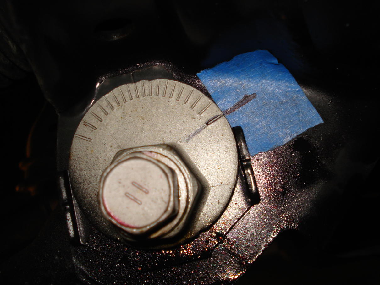

- Mark each washer behind the bolts that attach LCA to frame. Mine did not move, but better to know. (pic-3)

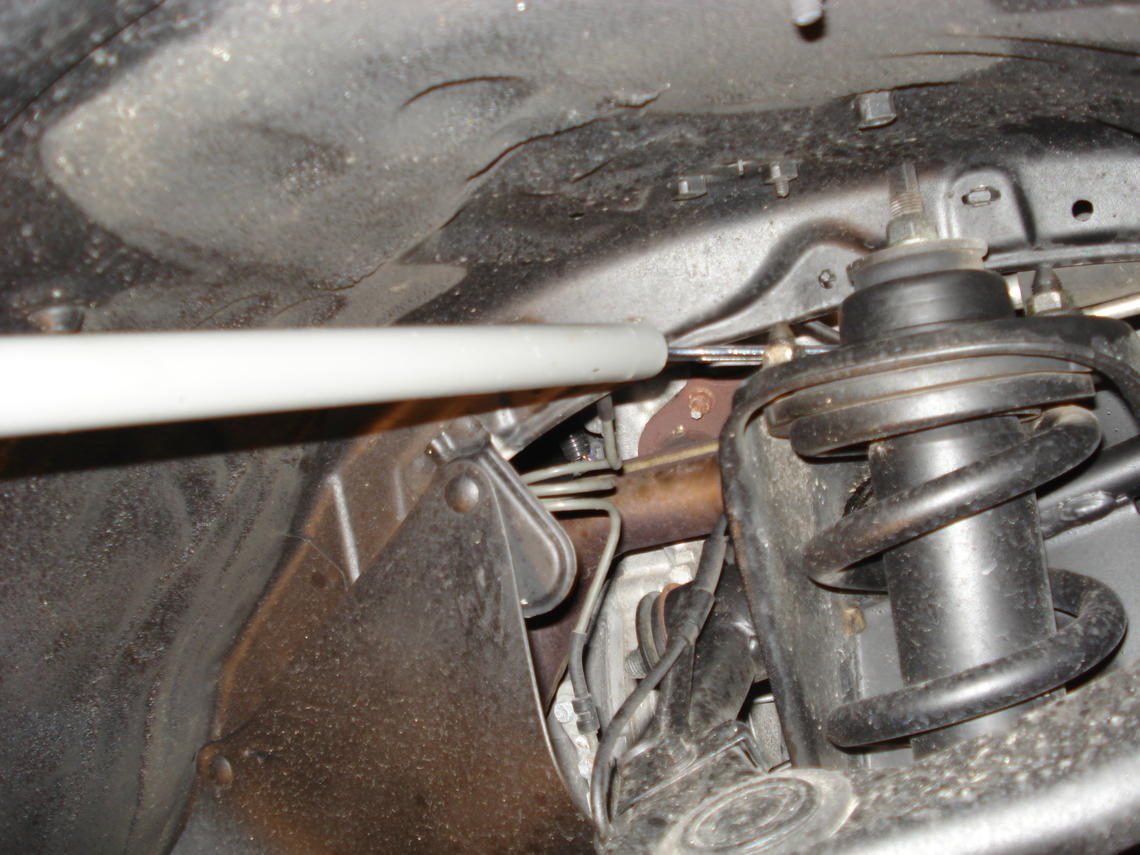

Picture 4 = LCA swung down after loosening bolds about ~2-3 turns. Don't loosen more than enough to move it.
