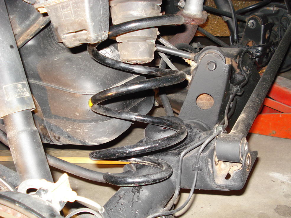

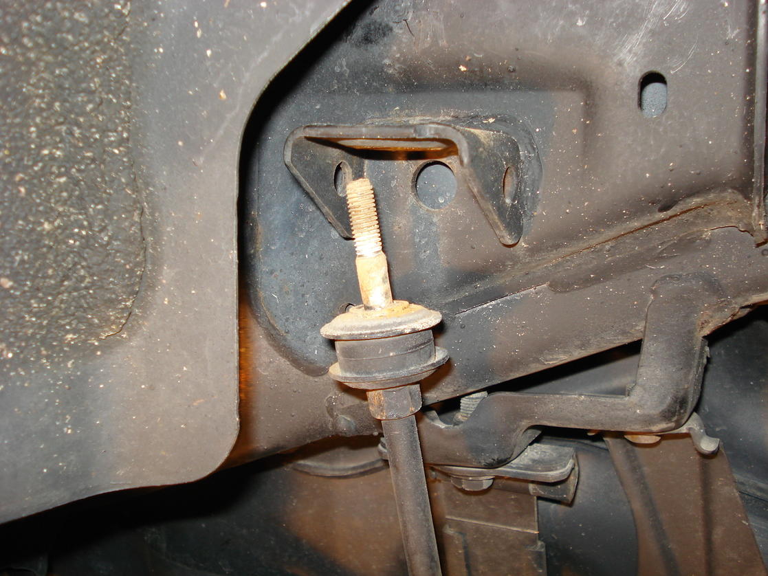

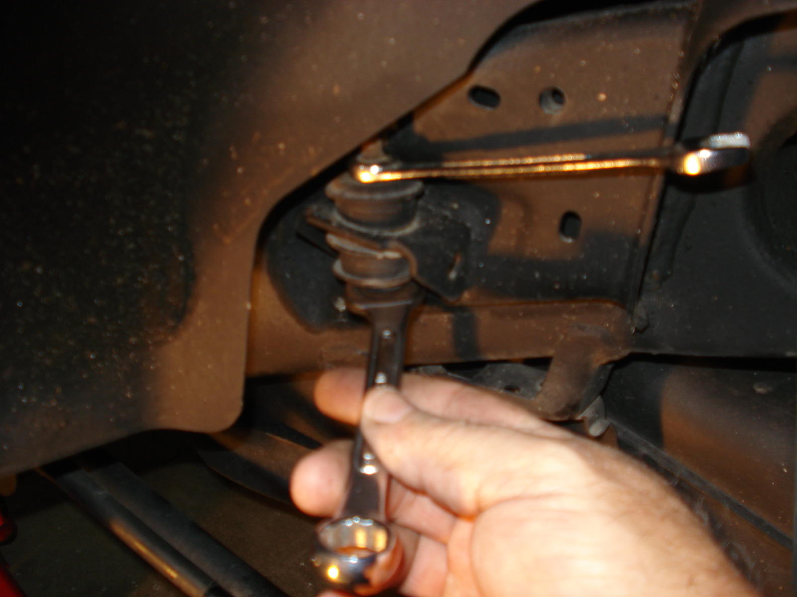

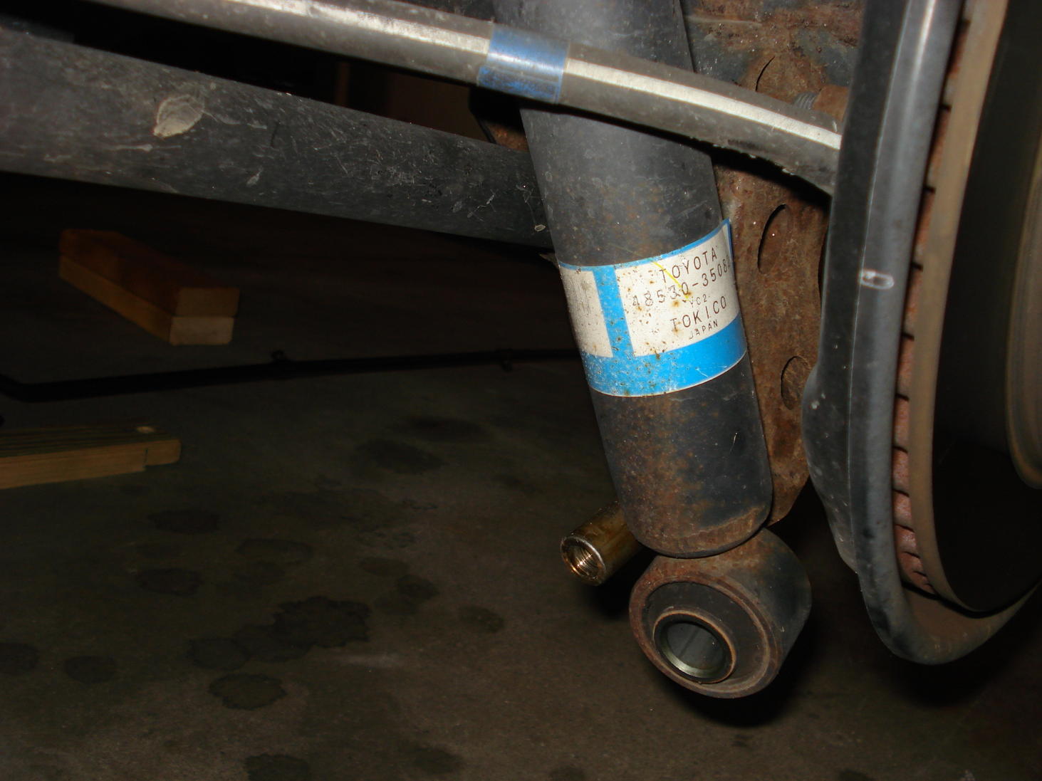

5. Disconnect shock and link arms both sides. Pics 1-2
Lower jack to let the axel droop, keep jack under diff just to support at lowest point.
At this point I did not disconnect Pan Hard Bar.

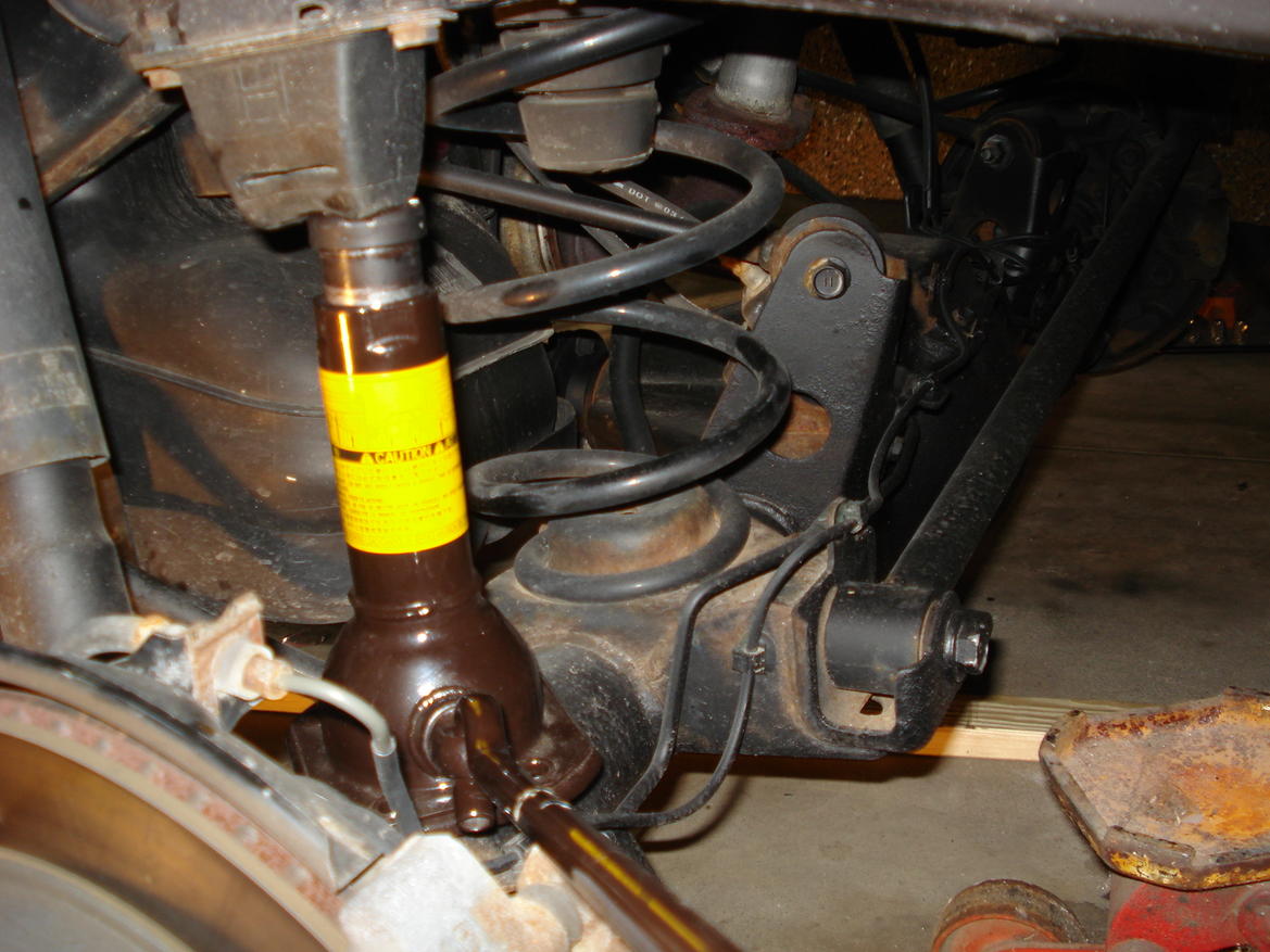

Place 2nd bottle jack on Driver side between bump stop and axel. Start turning jack by hand pushing the axel down. pic 3
Keep an eye on flex brake lines attached to axel. I pushed axel down until those were tight. This is where 2 people help, one jacking, one watching all lines.
When you are down enough, your link arm bolt will be out of the bracket as seen in picture #4 and the coil spring should be easy to move and pull out.

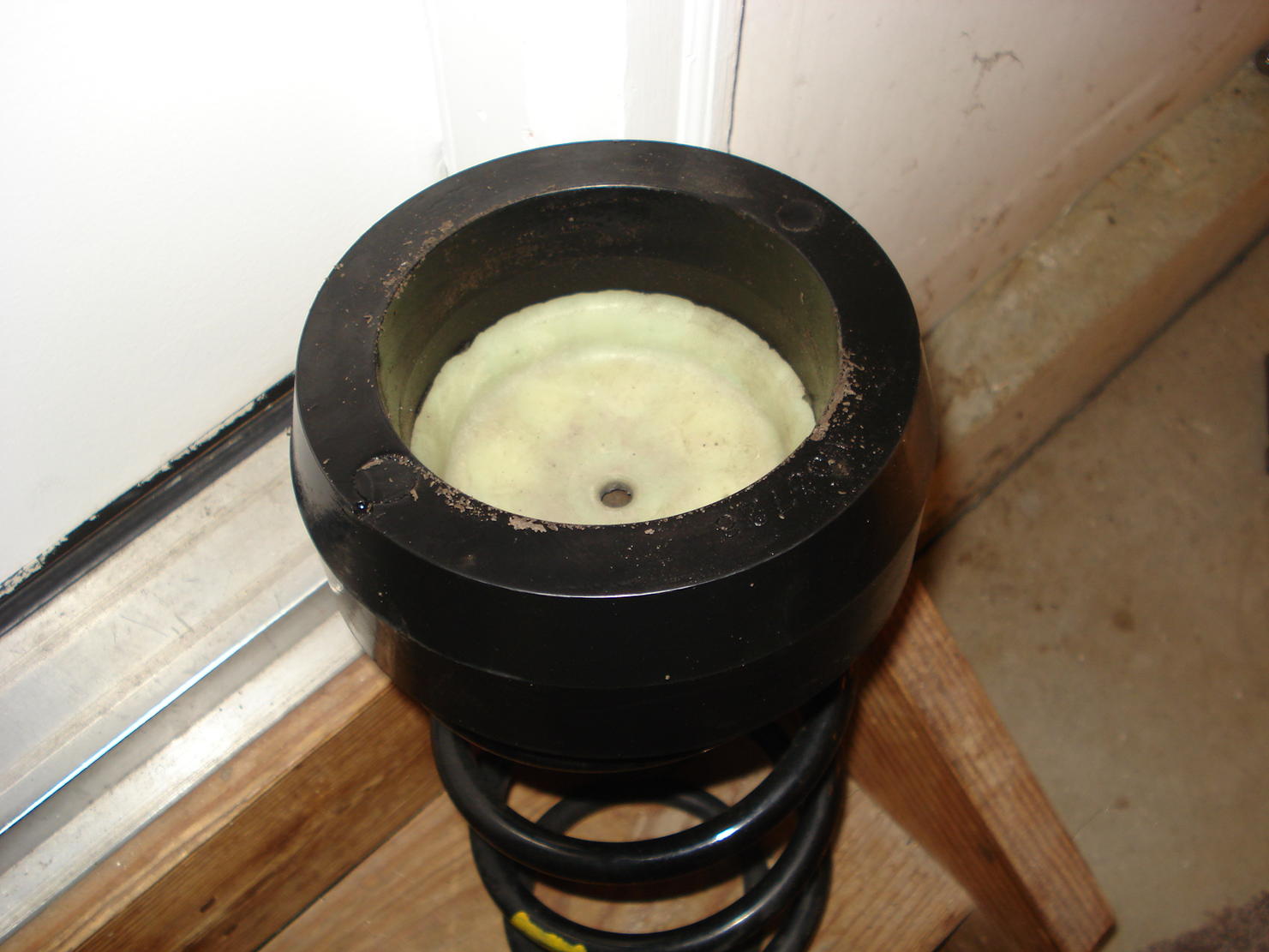

Assemble coil spring with bump on top of spring 1st, then spacer goes on top of that. pic 5
