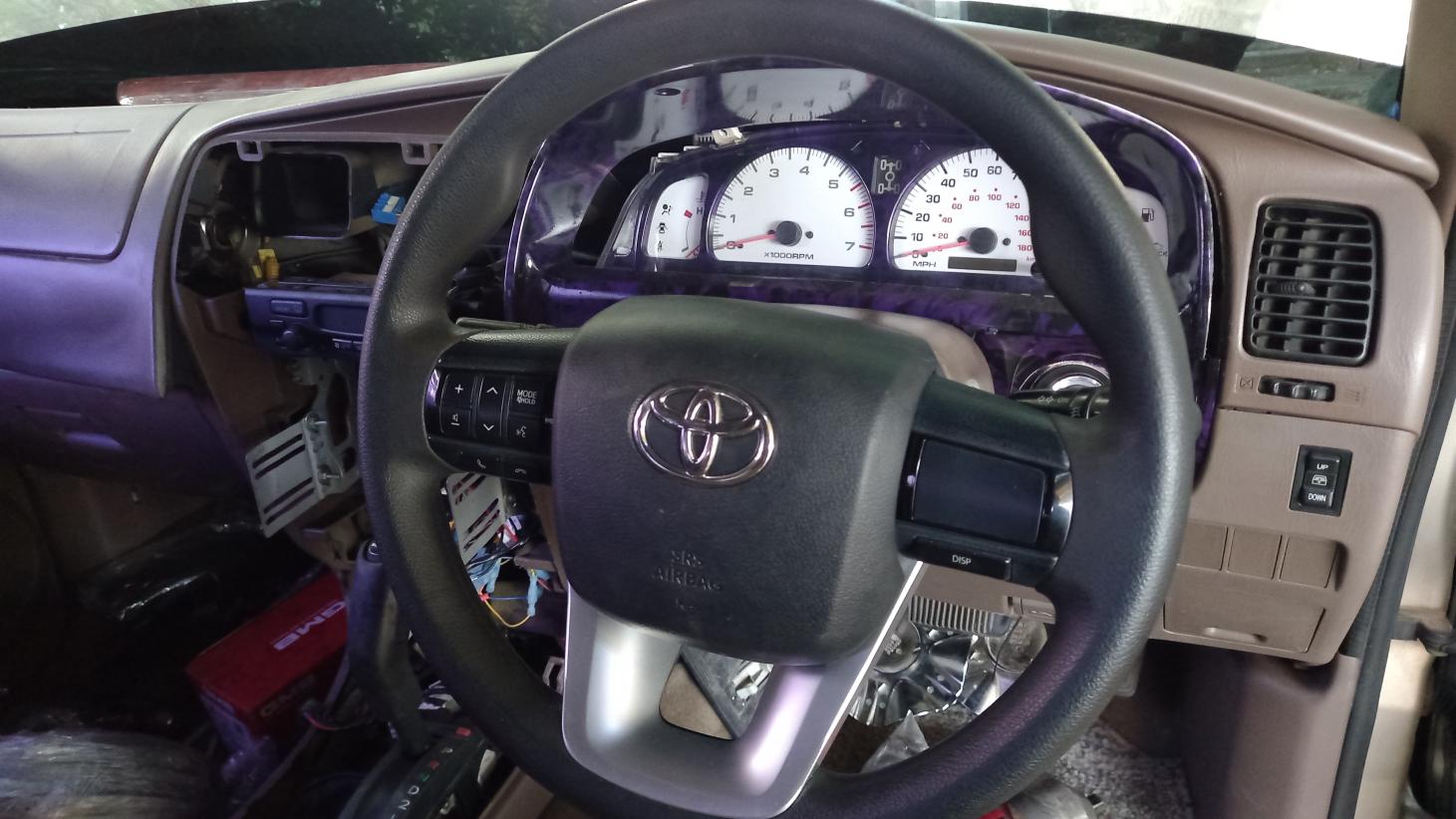

This mabe far out, I did a 2019 Hilux Steering wheel swap on my 3rd gen. I'd like to have working steering wheel controls
Now THAT'S different
Is it even possible to get the steering controls to work? Seeing as 5th gens have a CAN bus system, or at least I very heavily assume they do. But I'm no electrician :shrug:
You wouldn't be able to get them to work with the OEM cruise control - but stereo controls might work with an aftermarket stereo with an adapter/interface module. You will need to get a higher pin-count spiral cable to make it work (I think the ES300 one works?).
