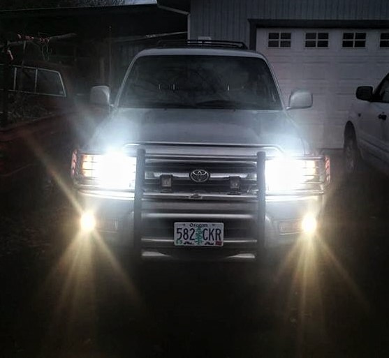

Reviving thread. Just ordered a pair of Optilux (aka Hella) XY Series H3 12V/55W Xenon Yellow Halogen Bulb Set. Will post review...
this is the 4th gen section but thats fine, post up pictures after the install with the color output so we can see how they look. just so you know some people get about a year out of those bulbs because of the color. bulbs that are blue or yellow will not last as long but they are a great way to find out if its the color you want. there are other ways to get yellow fogs if you want them to last longer. some people use tint film with white bulbs and some use a tint paint. if you want to tint the lens of your fogs look up metalcast paint by dupli-color. it gives you a better look then tint films and you can put on as much as you want till you get the color you want.
hope what i said does not come out the wrong way just trying to tell you of ways to get yellow fogs that will last longer without going with HID. i know a lot of people buy the yellow bulbs and thats fine but for me i wanted something that would not cost me a lot in the long run. im running 60 highbeam bulbs in yellow fogs
IMG_20140421_135739_zps293e14cb.jpg~original
Oops, sorry about being on the wrong thread! Thanks for the tips. Yeah, I saw that about the problems with a lame tint and longevity. I figured that I'd start with baby steps. Will post a pic when I have them installed. Happy New Year!
My LED headlights on low beam.
Foglights are original, soon to be LEDs as are all other bulbs.
