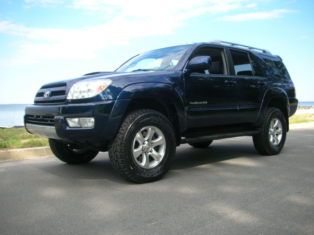

I've got the Cornfed lift with 285's and it's a great set-up. The ride is fine and the X-Reas system is still intact. Worth the money in my opinion!
