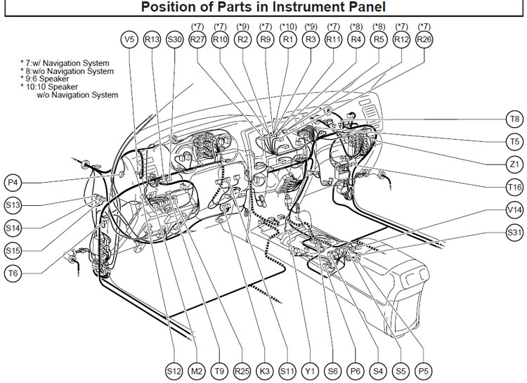

the outermost blanks have the seat heater switches in them. never saw anything else there except the DAC switch.
sorry, should have read all pages before posting.

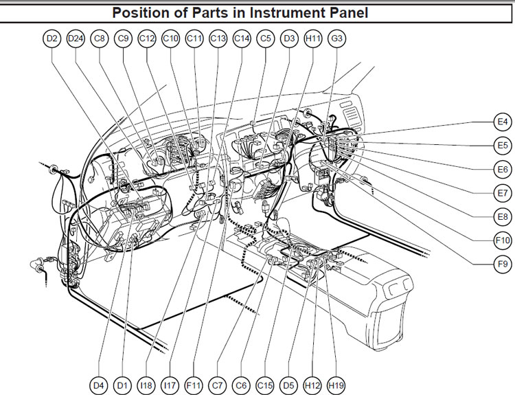

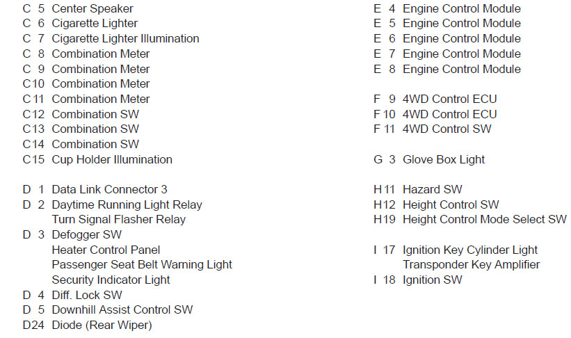

From r32's diagram I can see plug d5=DAC switch / h12 ride height conrol switch and h19 ride height mode switch.
I was in a 4rnr today with the seat heaters in the outside positions, though not listed on r32's diagram.

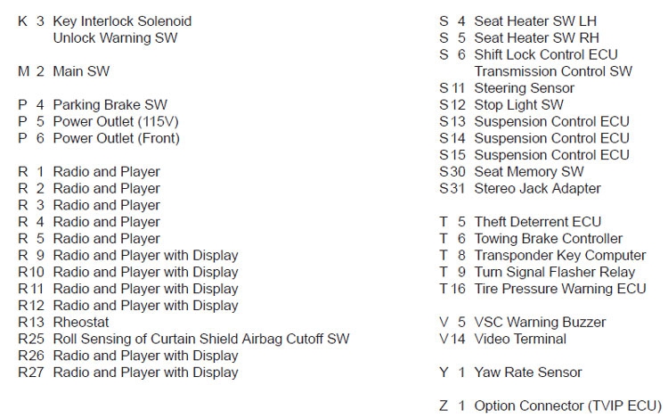

seat heaters are actually there, in the second diagram, S4.
