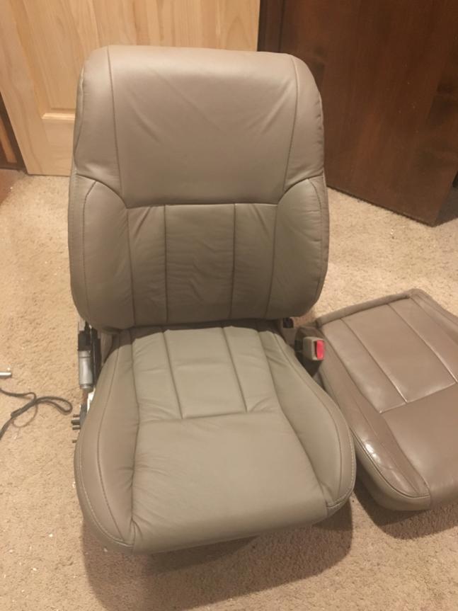

Sure thing. I did a lot of online research and had it narrowed down to 2 companies found on ebay. In the end I went with US Auto Seat Cover and am pretty happy with the choice. I contacted them through their website and put together a package deal.
I got the leathers for both fronts (my back seats look practically brand new) and 2 new seat foams for the bottoms for $800 even. The seat foams sell for about $100 each, so I think it was a pretty good deal. I highly recommend replacing your seat foams because they are actually the culprit behind the classic 4runner driver seat bolster blow out! When I first put the new seats in I couldn't believe how much higher I sat in the truck again. I had been doing the lowrider for so long. They don't offer foams for the uppers or I would have gone for those. The replacements look like much better quality material than OEM.
The labor really wasn't difficult at all. Add in $70 for a set of aftermarket seat heaters from Amazon and you've got some brand new front seats for under $1000. Excuse the crummy pic, but you can see they nailed the OEM pattern and OAK color. This is before I put the head rest on and applied the heat gun and they already looked so much better.
