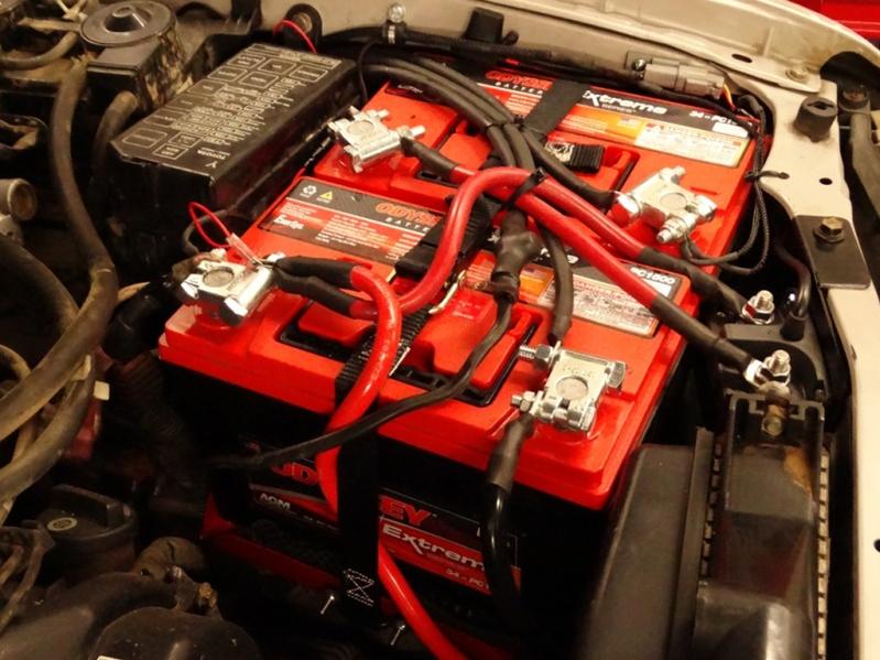

Dual Odessey Extremes.
(EDITED TO PROVIDE MORE DETAIL) The batteries are Odyssey Deep Cycle Battery Group 34... ODY34/78-PC1500DT. They are connected a Blue Sea Automatic Charging Relay, which isolates the batteries when they are drained to a certain level, making sure that you always have enough juice to start the rig with the starting battery if you are using the batteries for a refrigerator, lighting or other needs. The system is monitored with a Victory Dual Battery Monitor, which gives me all the information I need about the status of both batteries. The batteries sit on a custom fabricated dual battery tray made by Mule Expedition Outfitters. The radiator overflow bottle needed to be moved to the other side of the bay in order to fit these in.

What battery number is that from Odessey? And would it fit as a single the normal way?
Sorry, should have given more details, I will edit my post to 8nclude this information. The batteries are Odyssey Deep Cycle Battery Group 34... ODY34/78-PC1500DT. They are connected a Blue Sea Automatic Charging Relay, which isolates the batteries when they are drained to a certain level, making sure that you always have enough juice to start the rig with the starting battery if you are using the batteries for a refrigerator, lighting or other needs. The system is monitored with a Victory Dual Battery Monitor, which gives me all the information I need about the status of both batteries. The batteries sit on a custom fabricated dual battery tray made by Mule Expedition Outfitters. The radiator overflow bottle needed to be moved to the other side of the bay in order to fit these in.
