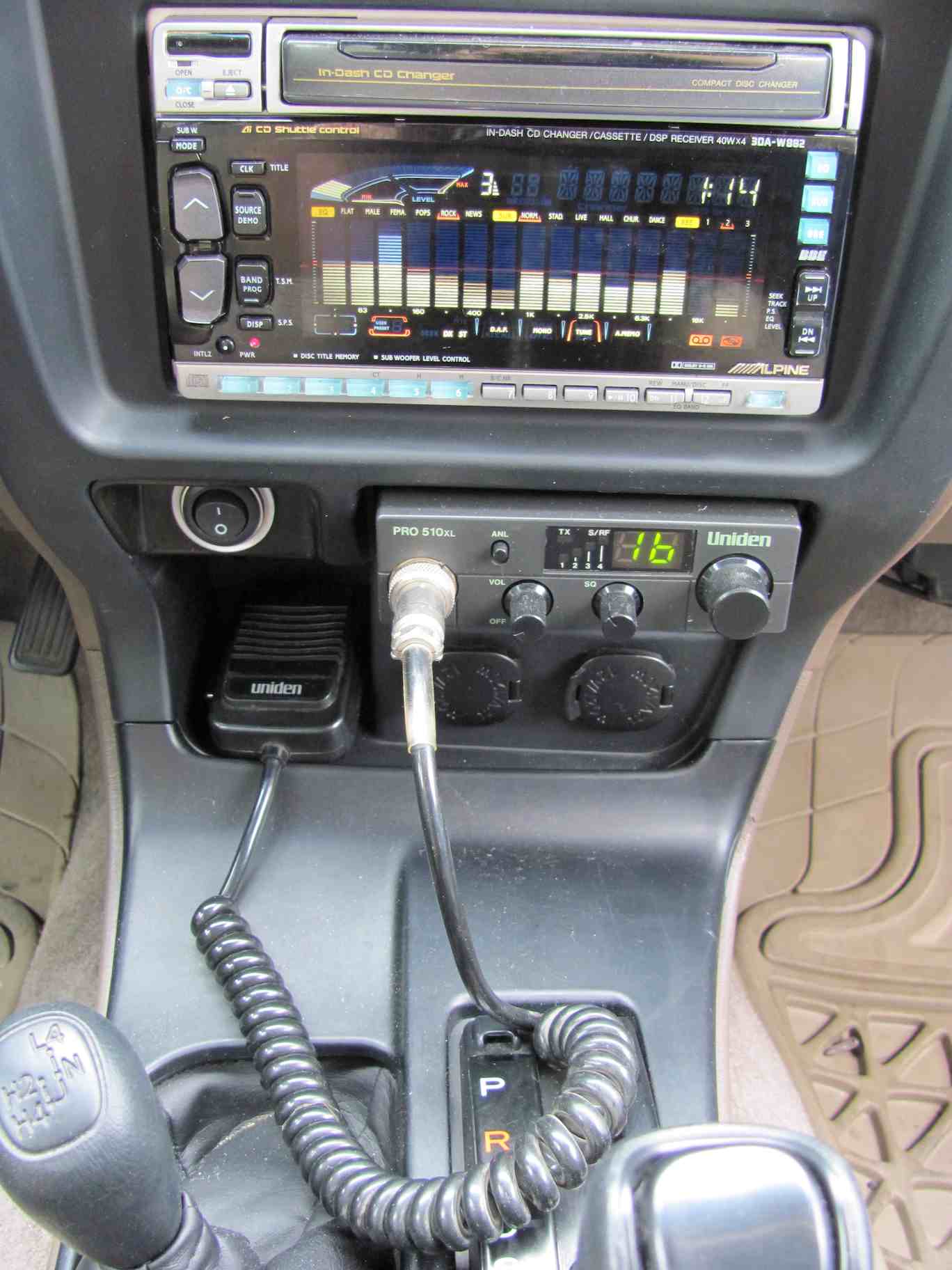

I've been using the Cobra 75WXST for a while now. Works well for me.
There are a couple of pictures of the install here:
Interior Modifications
