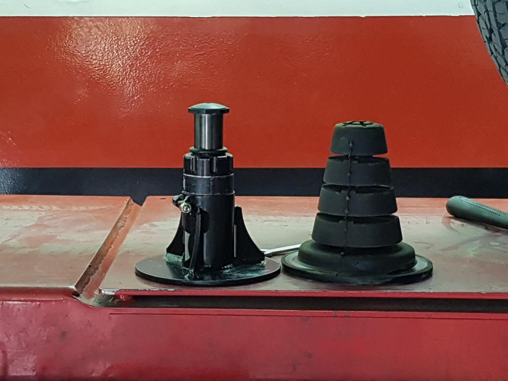

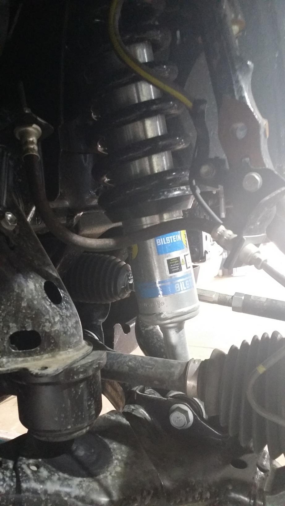

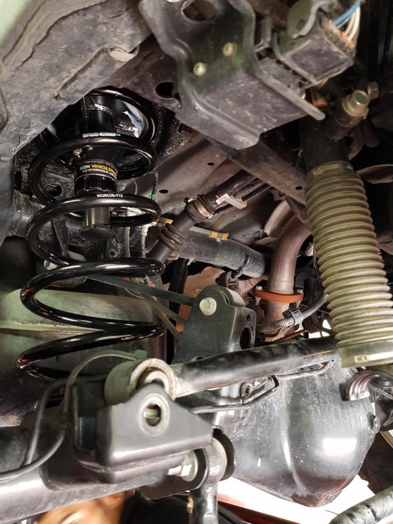

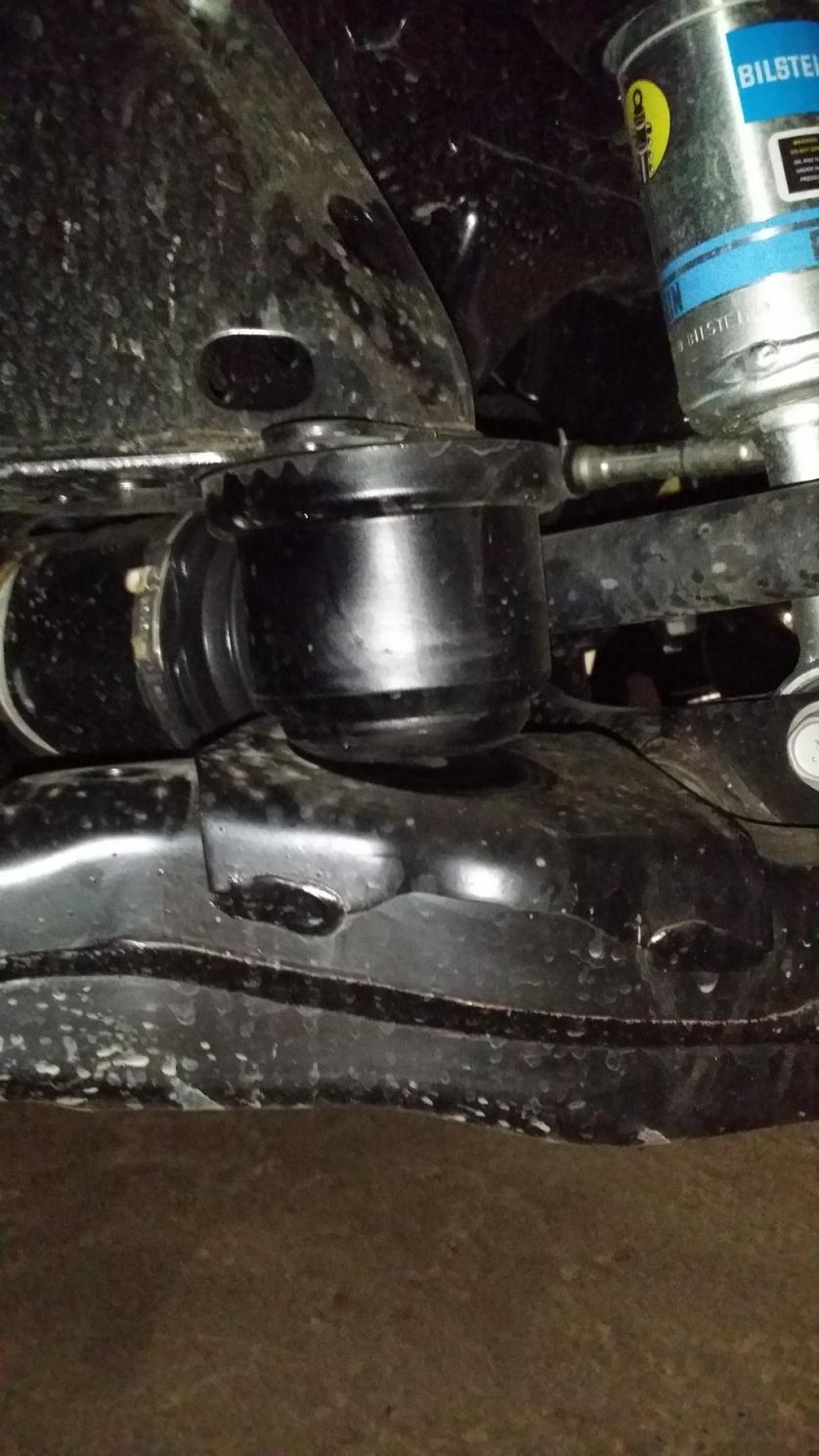

Wheeler's SuperBumps up front and ICON hydraulic bump stops in the rear (in coil setup).
Pros:
Superbumps: decent price, works great at softening harsh impacts
ICON: works great at softening harsh impacts or when carrying heavy loads over bumps, adjustable height
Cons:
Superbumps: large enough to almost always be on contact at stock or mild lift. I'd prefer something shorter to allow the suspension to do it's job
ICON: $$$, location in the rear coil is not ideal.
pics 1&2 are front superbumps. Pic 3 is ICON hydro bump vs stock bump stop. Pic 4 is ICON hydro bump installed

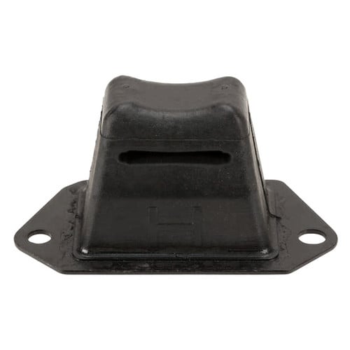

I have not tested a set - but the GX460 rear bumps are different from the 4Runner ones. They're significantly taller and softer. $50ea. I *think* they would be a bolt in swap, but I haven't personally tried it.
282795d1367996909-those-who-have-converted-the-air-suspension-please-chime-in-image.jpg
You'd want the ones for the models with air springs. I think the coil spring models are the same as the 4Runner. It's wierdly hard to find a good photo of them. But here's what they look like:
Air spring model bump stop:
1549658504439_default
vs coil spring:
