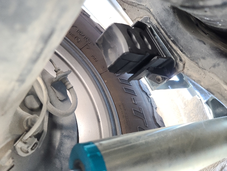

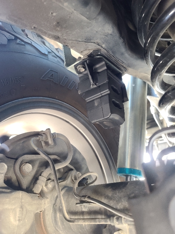

I have 2.25"/2.0" lift with Durobumps on the front and Toyotec extensions plus stock bumps in the rear. I do need to do more with the rear still.
They were great until I upgraded my LCA's, I have fendered out a couple of times, more so because I didn't have through bolts long enough to go through the TC supplied extension and the Durobump. I found a pair of matching bolts in my toyota box and put them on last week. I have yet to get out and test.

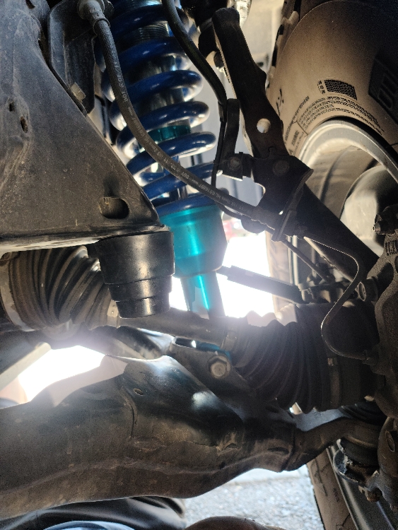

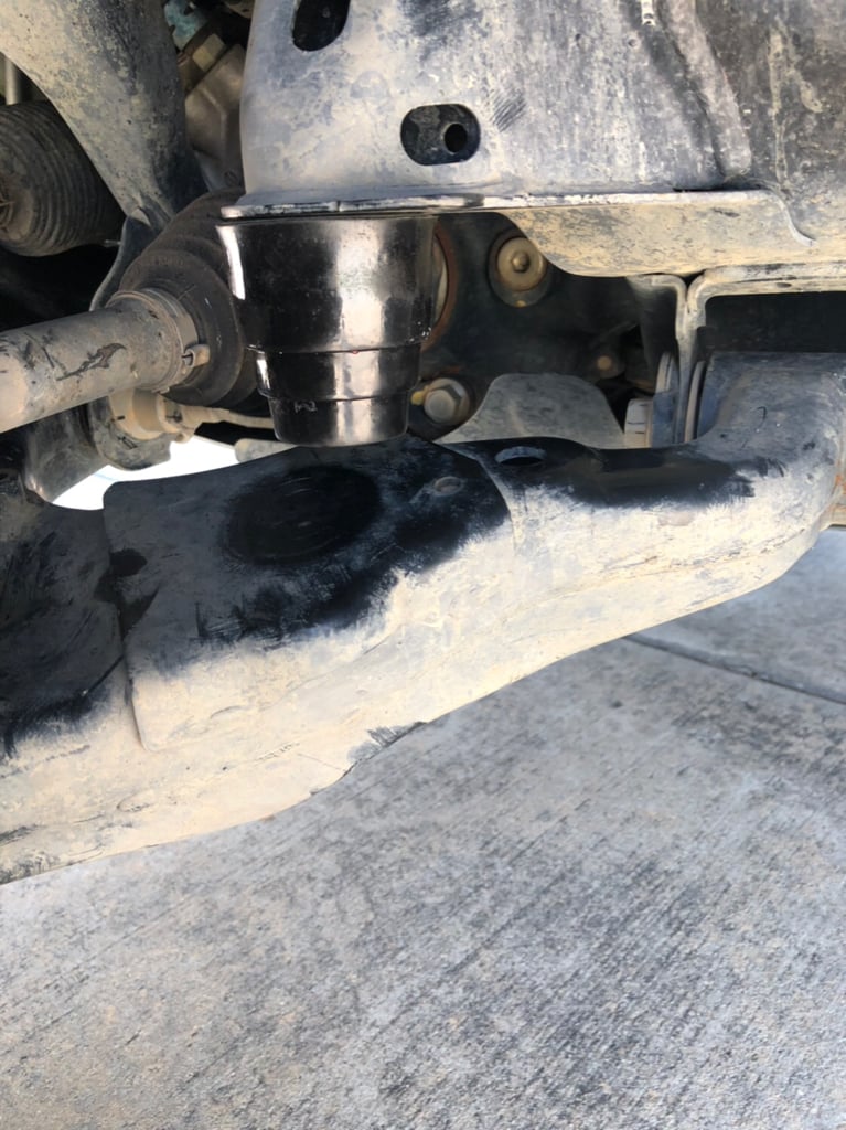

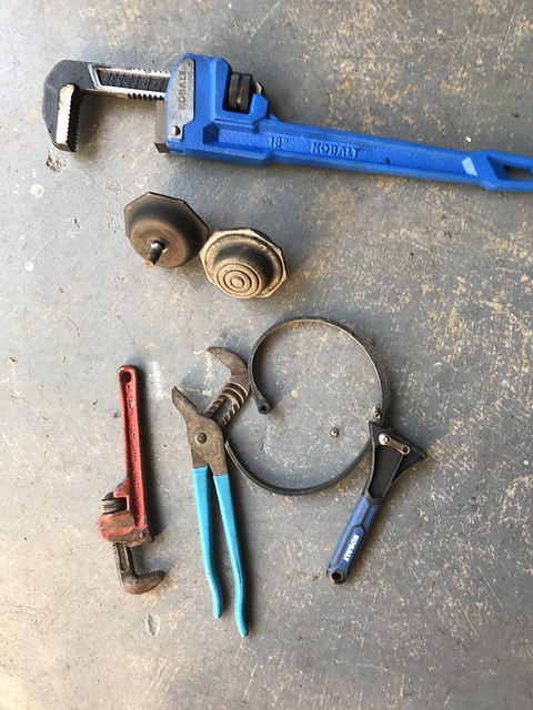

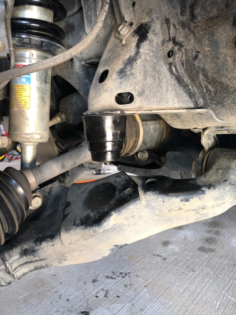

Front Bump Stops Need BIG Wrench
Installed DuroBumps yesterday.
Coated threads with PB Blaster and went at it 30 minutes later.
Rears were easy.
Fronts would have been easy if I had the right tool.
Little Pipe Wrench and "normal" Channel Locks wouldn't cut it.
I broke a small strap wrench.
Ended up running to Lowes for a big pipe wrench and it was easy.
Front bumps are in the picture below and you'll see how you have to get the wrench on the metal-octagon flange

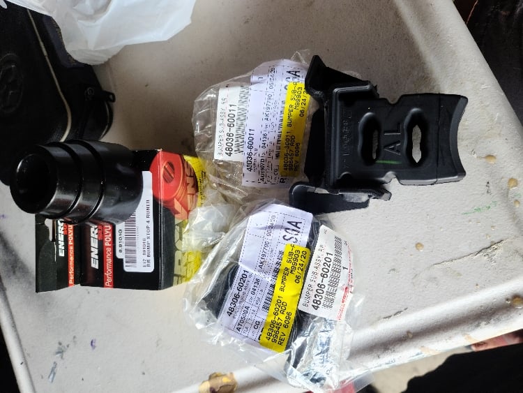

Running Duro bumps ordered direct.
No back plate so the product looks potentially less durable than oem. Specs wise they bolt up perfectly and are correct height. So far no issue riding smooth.
