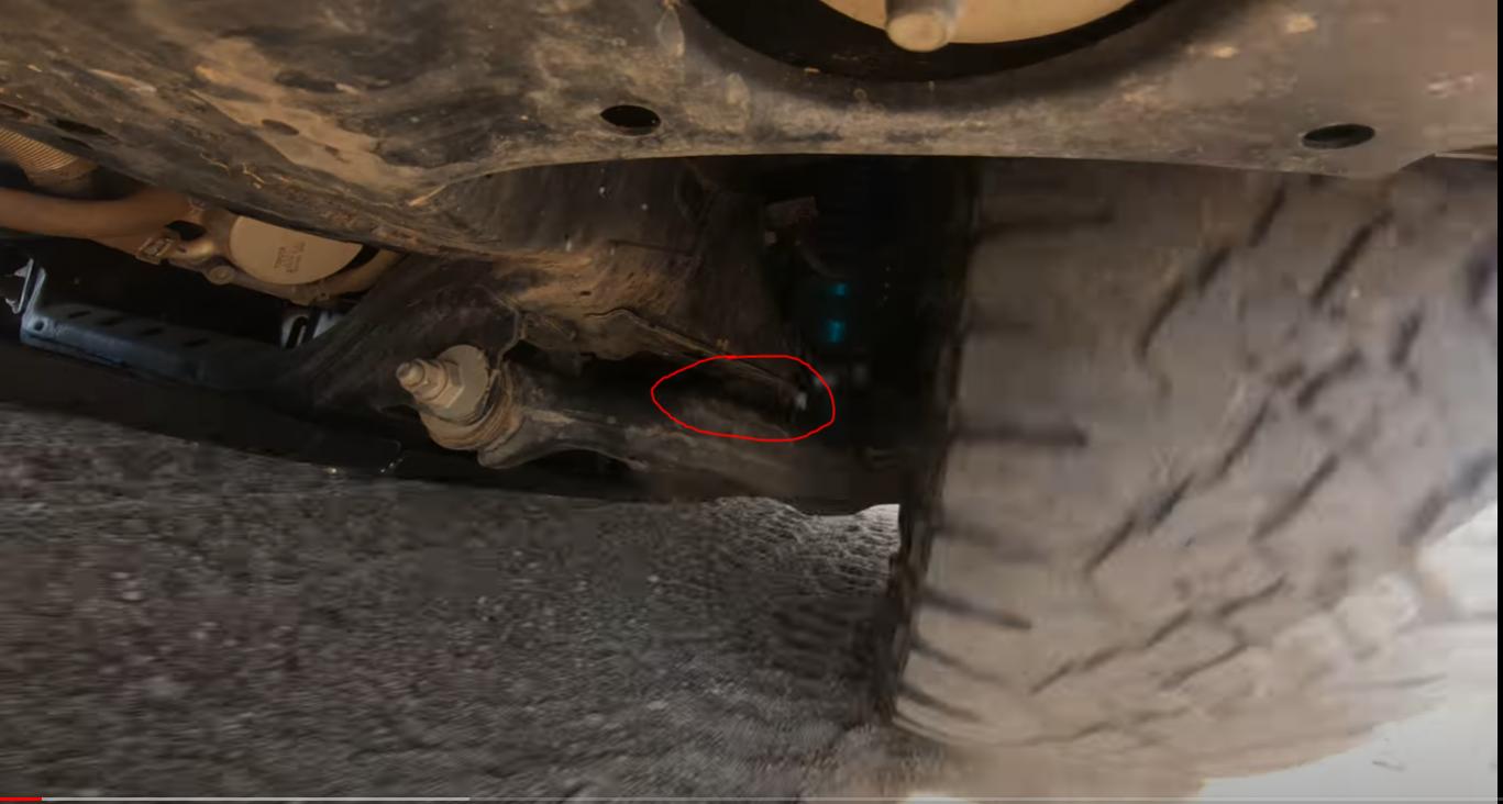

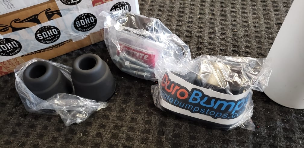

Here is a photo of the stock vs durobumps. Though the durobumps are taller, they are designed (as claimed) to compress to stock height. I found I haven't lost any noticeable loss in up travel after installing them. Also take a look at the screen still I captured from a video demonstrating the durobumps! see video here around post 30 seconds --> @plastics_guy bumpstops - YouTube
Thanks for chiming in [MENTION=362200]SpeedyKevin[/MENTION]. Saved me from digging through my whole garage. I have made the same observations. Uptravel is the same as OEM however the stop is much softer
cool that's what i was expecting from those ones. a nice progressive bump instead of the rock hard OEM stop lol.
